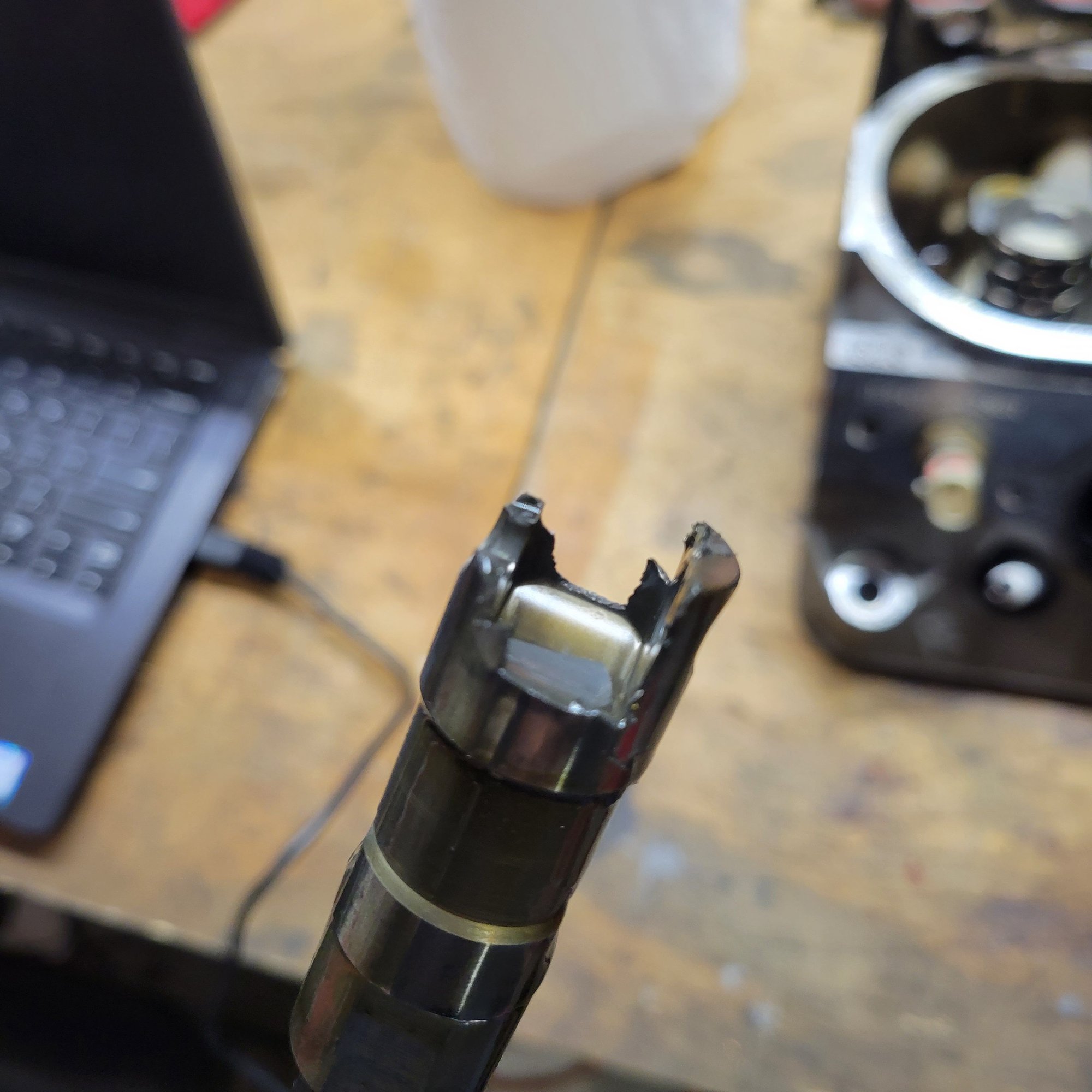

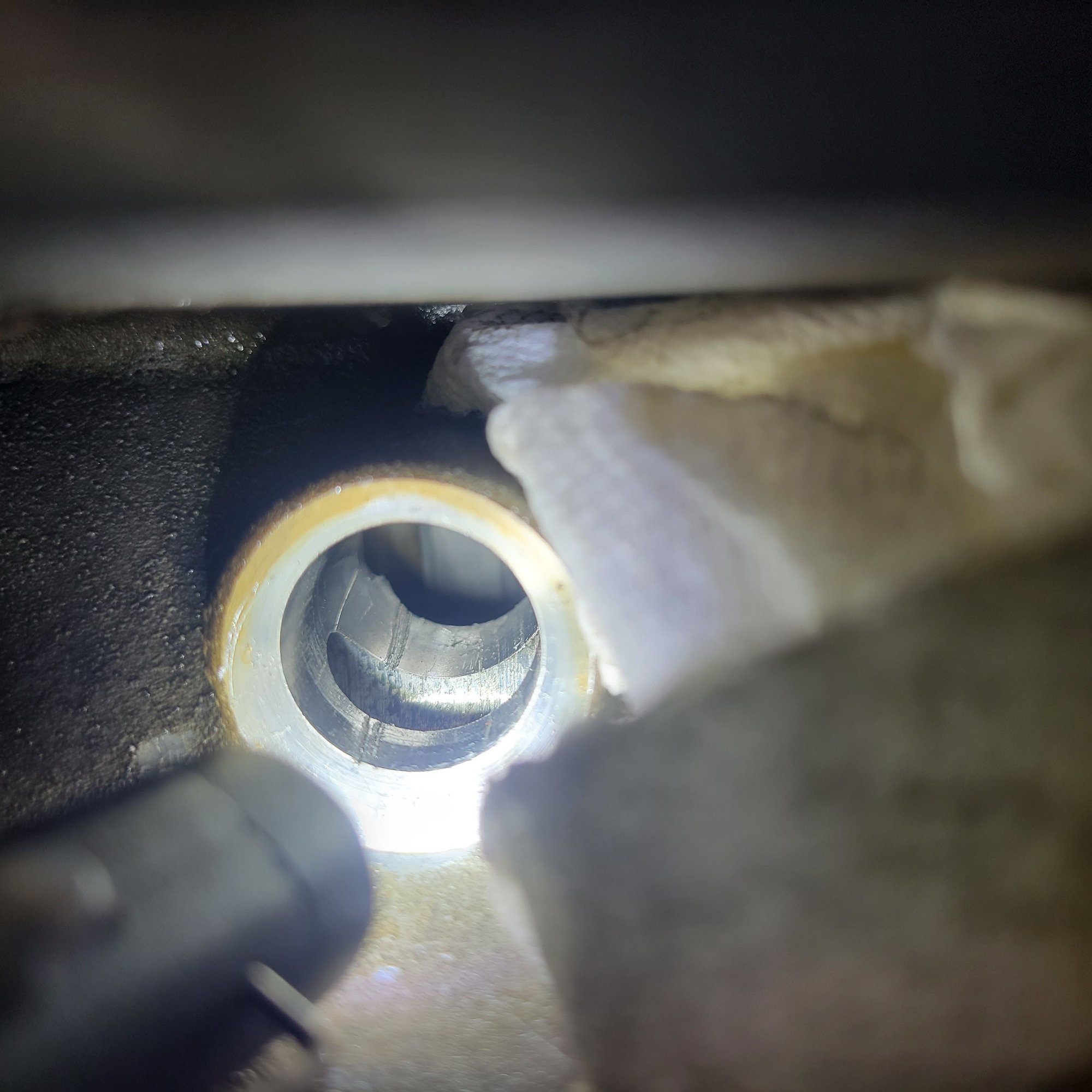

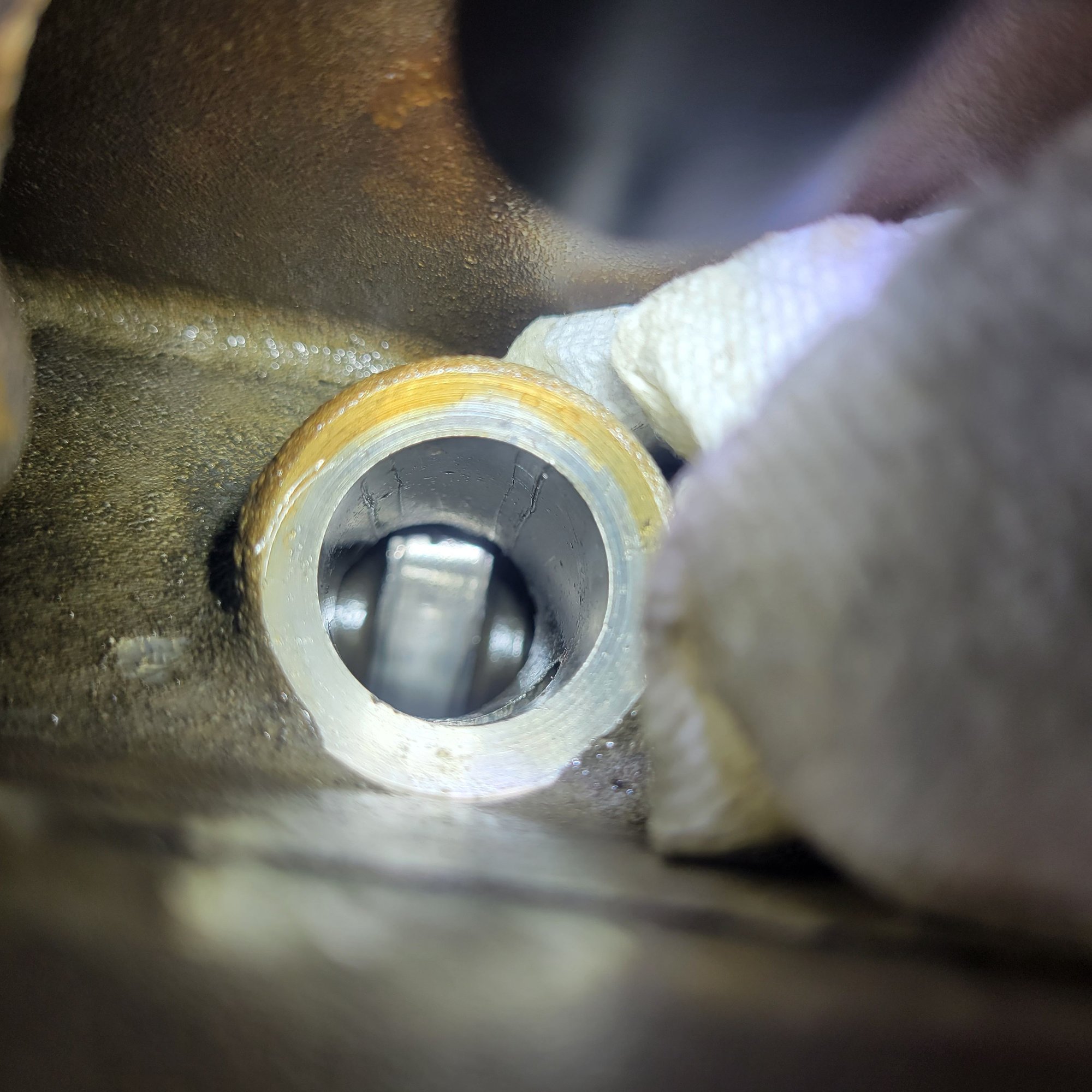

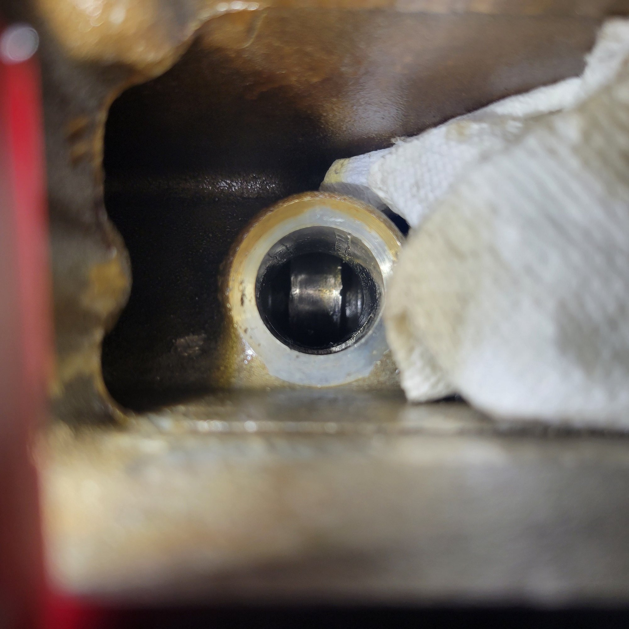

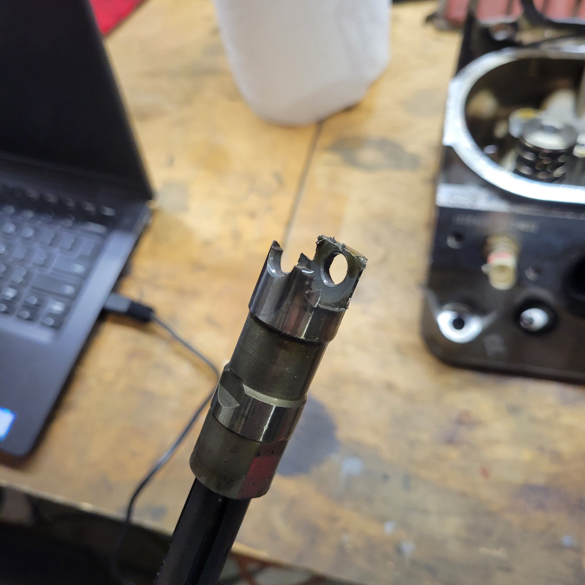

Pulled the driver side head, and went to start pulling lifters out. Intake side Cyl. 3 would not budge, stuck my hand into the oil pass and felt nothing but sharp edges. Will attach pictures

Deja vu. I went through something similar when I bought a hurt car. Believe me, tear it apart. There's metal bits everywhere, including all od your main and rod bearings. Do you have a better picture of the lifter bore? I was able to get my with a dingle ball and cleaned up sharp edges. That needs to be torn down to a bare block and power washed.

Really appreciate the reply, I can see the lifter pin in the oil pan with a borescope which makes me feel slightly better about further damage.

Oil pressure loss with scoring in the lifter bore. To really be right, the block needs to come out, have the lifter bore machined oversize, then install a sleeve/bushing into that lifter bore. This really sucks.......

That scratch definitely doesn't look like it will hone out. If the block has to come apart anyway, get it sleeved. You'll be happy you did.

Agree 100% here. It’s that deep scratch or gouge running all the way up the lifter bore, your oil pressure will be way down. That’s a huge oil leak. It’s gotta come out and get a lifter bore sleeve (bushing) at minimum. As Ron said, there will be debris everywhere. Bearings, pan, everywhere. A lot of times, when the lifter wheel fails, it showers the adjacent cylinder with debris while it’s running…the bottom of the cylinder is right there at the cam tunnel. This debris is hardened steel and gets in between the piston skirt and the bore, causing a big problem. This isn’t a simple fix.
