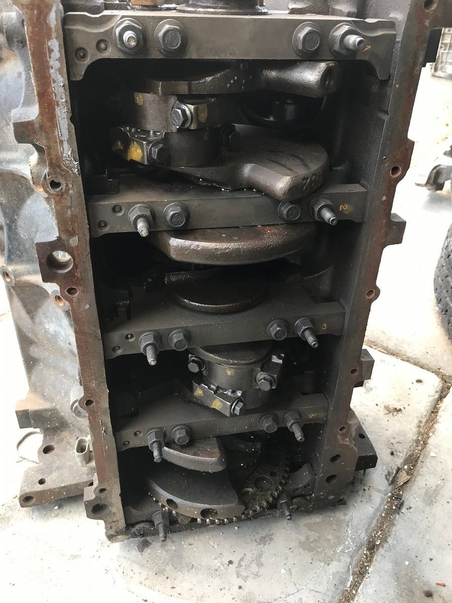

che70velle, I didn't take any pics of the valley pan, but when we unbolted it from the fresh rebuild (using this block) there were no o-rings in the circles of the valley pan. I have attached a few pics of the block when i picked up from the core place. might help?
thanks!!
Old Mar 25, 2023 | 12:01 AM
Posts: 7,828
Likes: 5,176
Ok, that’s a later gen4 block with the good rods. The bottom pic shows the towers that feed oil to the DOD solenoids in the valley cover. You are correct in assuming that you’d need a valley cover with o-rings that will seal those towers. No o-rings and you’ll have no oil pressure. While the block is torn back down, it’s a really easy deal to tap those towers for 1/4” pipe plugs and seal them off that way. It’s a sure seal that will never fail. Pipe plugs are cheap. Here’s a couple of pics of a block that I have that’s been tapped and plugged. This is literally a $40 mod including tap and plugs that anyone can do in an hour when the block is torn down. Be sure to wash the block real good if you go this direction. The tap process will put shavings in the towers.
