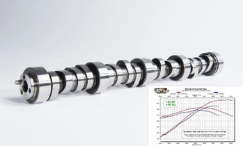

I need help selecting a cam for my 6.2 LS. I’m going to have a 3.55 or 3.73 rear gear most likely with a M21. Engine has 10.5 compression with stock unmilled heads and dual plane intake with a carburetor. 2” headers with a full exhaust system. Street car with occasional strip time. I’m not worried about low speed surging. The smaller cams are only off by a couple horsepower it looks like. Which cam do you think I should go with?
TSP Stage 2 LS3 N/A Camshaft
NEW Texas Speed Stage 2 LS3 229/244 .629"/.615" Camshaft
www.texas-speed.com
TSP Stage 3 LS3 N/A Camshaft
NEW Texas Speed Stage 3 LS3 231/246 .640"/.615" Camshaft
www.texas-speed.com
TSP Stage 4 "F-35" LS3 N/A Camshaft
NEW Texas Speed Stage 4 "F-35" LS3 235/248 .649"/.615" Camshaft
www.texas-speed.com

No LSA specs?? They're just as important as duration and lift.

TSP Stage 2 LS3 N/A Cam Specs: 229/244 .629"/615” 112 LSA, 109 ICL
TSP Stage 3 LS3 N/A Cam Specs: 231/246 .640"/615" 111 LSA, 109 ICL
TSP Stage 4 "F-35" LS3 N/A Cam Specs: 235/248 .649/615 111 LSA, 109.5 ICL

I wouldn't buy any Texas speed cam. Summit/Comp/BTR cams are way better. For your car, the Summit 8710r1 and done. Killer all around cam.

At this point, they are running the same crap from 20yrs ago which wasn't that great to begin with. I like spending my $$$ better than that. Comp is leading the pack with lobe design and BTR is putting effort into it too. Since it's slow around here these days, ask me how I feel about .660 spring kits for more controversy, lol
