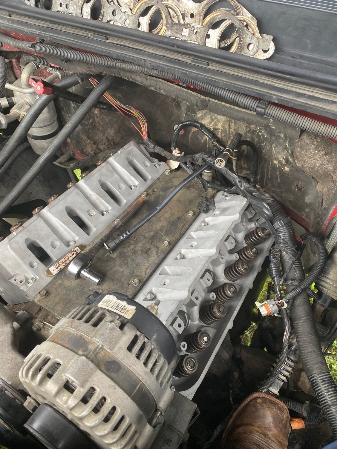

Hey guys i’m very confused as to what is happening now, I have a 09 silverado 4.8l that broke down on the way home from work one day, long story short valves were leaking and heads were warped + blown head gasket, it does have a stage 2 summit racing cam and tune + supporting mods but that’s about it, I took the heads (243) to the machine shop and had them resurfaced, milled back 5 thousandths, and valves lapped. Long story short i put the new felpro head gaskets on and start it up, coolant starts mixing with the oil BIG time even with the engine off, so I tore it back apart to see if anything was wrong, forgot the dowel pins(i know rookie mistake) and i put them in, bought new felpro bolts and gaskets, got the heads torqued down and filled it with coolant, none mixing with oil and was holding it, start it up drive it around the yard and decided to drain the oil and put new oil in, with the drain plug out i started to pour coolant in and it starts coming straight out of the oil pan. I’m at a loss now and have no idea what to do, any help would be appreciated, thanks!

Maybe I'm wrong but it sounds like there's an inssue with the engine block. There's also the possibility of a damaged cylinder head or faulty water pump.

With the spark plugs out, add water to the cooling system and have somebody crank the engine over.... See which spark plug hole is shooting water out. That should give you a cylinder to focus on for the next steps.
Pull the heads.
Triple check your head gaskets that they are correct for the application, were installed correctly, etc.
Inspect each cylinder for a hairline crack.
Take the cylinder heads and have them pressure checked.
I’m starting to think it’s the engine block too, the heads were pressure and vacuum tested and held up and the water pump and thermostat is brand new! i’m just confused as to why it wouldn’t do it before it was started and now it will mix coolant and oil with it off!

The head gaskets are for sure the right ones, i got them from o riley’s and saw where the front goes etc. The heads were warped but milled back 5 thousandths and he said they were flat, they held up to the pressure test and were good there. I’m starting to think there may be something wrong with the block

Water can get from the cooling system to the crankcase without passing through the cylinders at all. IOW you can have a busted block (freezing for example) that will exchange water and oil butt the cyls still be perfectly intact. So all that about spark plugs and cyl wall cracks and heads and such is a waste of time: that can all test perfectly good, butt the block is still trash.
Sounds to me like your block is toast.
Time for a 6.0.
I see you're standing in the engine room there... that's how I work on mine alot too.

No lol, it was something very stupid, took the heads off and had them pressure tested, somehow there was a crack connecting a water jacket to the oil passage on the heads that the machine shop didn’t see before. They replaced the head for free so that was a win!

Uhh... there are NO oil passages in the heads. All oil to the rockers travels thru the pushrods, then drains back to the lower end via pushrod holes.
To repeat, there are NO oil pressure passages in the heads.

If they had been the 706 head casting, made by Castech, then cracks near the head bolt holes that leak coolant into the oil are VERY common. 243 casting isn't subject to that particular problem butt of course can crack in other ways, same as any other casting. As stated above, there are no "passages" for oil in the heads, unless you consider the drainback holes to be a "passage"; butt there's water on one side, and crankcase on the other, of the ENTIRE top of the casting under the valve cover.
