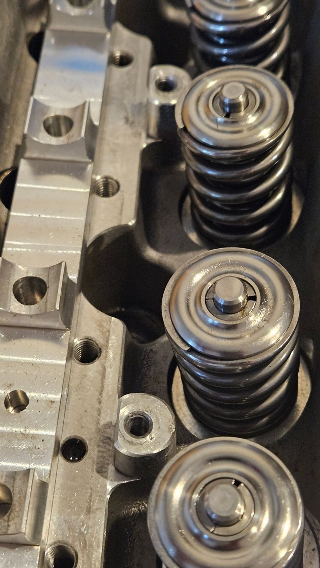

I have a like new set of aftermarket heads in which need a rocker bolt time sert repair for 1 of the rocker holes.
I plan on dropping the car off for upgrades along with the heads.
Will the proper time sert mess with the rocker geometry? Is it a reliable fix?
No. Assuming proper installation as well as using the proper insert of course.
​​​​​​​Is it a reliable fix?
Probably.
I tend to Heli-Coil all of those on heads anymore, they tear up so often, especially used heads where they've been gorilla'ed befor I ever got em. Those teeny tiny fine threads in aluminum are kinda too close to a one-use-only thing, it seems.

Sure, a TimeSert repair is overall stronger and a more permanent solution to a problem. If I’ve got a hurt threaded hole in an aluminum head, block or whatever, and I can’t afford to go to a larger size because of space, or other constraints, I’ll use a TimeSert if and only if it’s a high torque application. A HeliCoil on the other hand is useful for low torque applications in a REPAIR situation. I’ve had my hands in a lot of high end builds over the last 30 years and I can assure all of you that the very top endurance engine builders install HeliCoils in most all threaded holes in both aluminum blocks and aluminum heads, while the unit is new, to help avoid threaded hole issues later, before they start. As a preventative defense, before there’s a problem, it’s smart. In a high torque repair situation, after the problem has occurred, it’s a bandaid at best.
Rich2342, a TimeSert here is smart and will not affect geometry at all as long as the machined surface HEIGHT where your rocker arm stands sit isn’t altered. On the other side of that, if this is an 8mm rocker bolt, it won’t see over 26 ft lbs, and a properly done HeliCoil will suffice. If it’s a 10mm bolt, it will see too much torque for a HeliCoil…in my opinion…and I personally would revert back to the stronger, and more expensive TimeSert repair here, if this were in my shop.

I would hope most shops can perform a proper time sert, but that is my concern.
I am not sending the heads out to a machinist who I would be fairly confident things would be precisely measured and fixed.
I just assume buy a new set of heads if this is something iffy for a shop to get right. I don't want the rocker coming out or side loading the valve tip, dropping a valve.

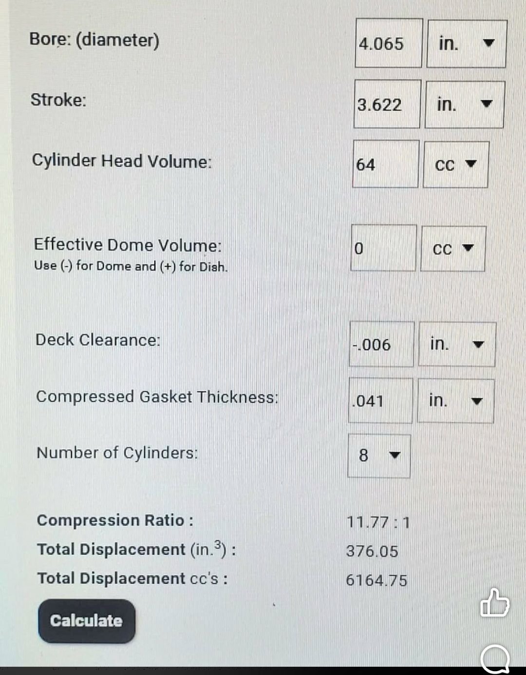

What is the correct deck clearance on sbe ls3? Ive seen anywhere from .005 to .007, used.
11 degree 260 heads with 69cc chambers out of the box.
