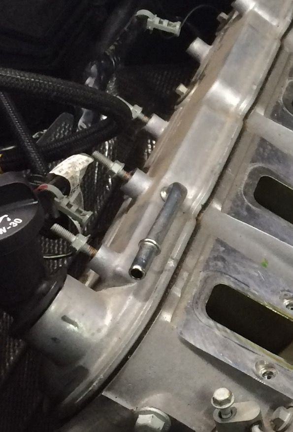

I may not understand baffle correctly. What makes something a baffled port? See pic below. This is the port I'm asking about.
If you look on the underside there is a baffle so there isn't a direct shot to that port.
Yessir. It's a big piece of metal. I was calling it a shield. So this is the question. Is that baffle necessary? I'm going to add this port to the new valve cover but will everything work ok if I don't add the baffle on the inside? What would be the consequences if baffle was left off?
