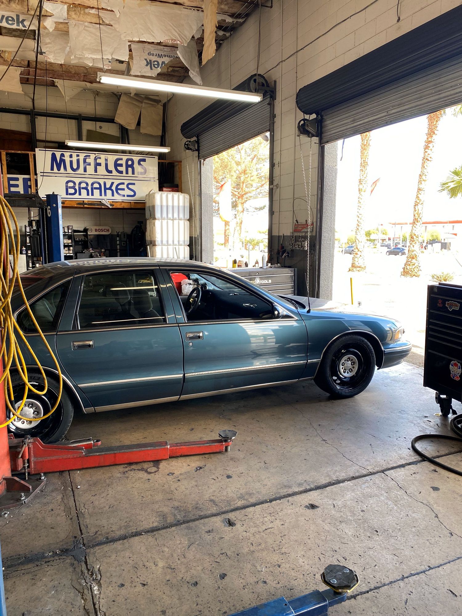

In this case the front frame rails are welded together by a fabricated box connector. Extra HD sway bar brackets are necessary for the Nolathane (Australian company) 35 mm solid front sway bar (~300% stiffer than OEM). With the adjustable pro-touring style rear sway bar, (>400% stiffer than OEM) Eibach Pro Kit springs (lower by 2.5" from OEM Caprice height) and Koni adjustables set full hard, this 96 Caprice is neutral and pulls over one G sideways. 18X9.5" wheels F+R with Michelin Pilot Super Sport 255/40-18's.
The Caprice Classic in 1996 had exactly the same wheelbase and frame as an A body from 1964 to 1972. As did the 94-96 Impala SS. My 94 SVI Impala SS has all of the framework of my Caprice and Koni's, but with the QA 1 hollow 1 3/8" front bar but with OEM SS wheels and springs and Nitto 555G2 275/50-17's.
Does not handle as well as the Caprice (of course).

Stroked 383 LT-1 with Vortec Supercharger, stand-alone fuel management system, Richmond 4.56 gears, boxed frame, Koni, Eibach, Quickor Suspension 1 3/8" solid F+R sway bars, seats from a Bonneville.
