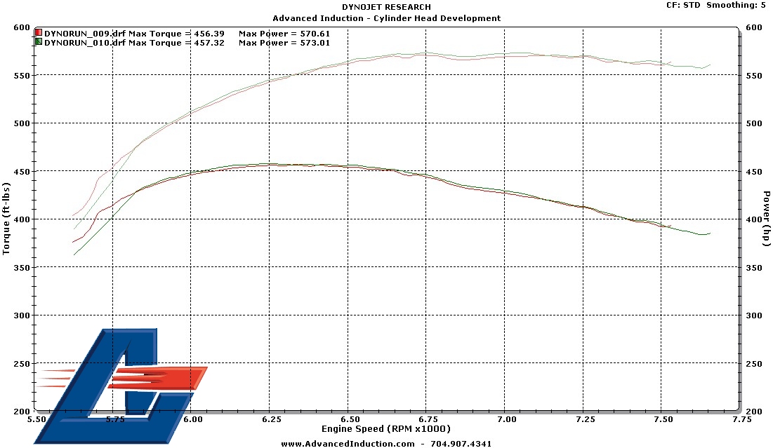

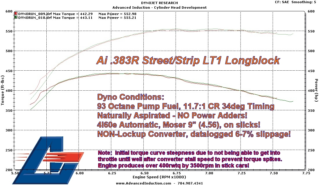

It is possible to do quite well with the old LT platform as it is simply a classic small block. However, producing big #'s reliably it is typically beyond the point of diminishing returns for most guys. While the magic 500rwhp # is commonly discussed, and even predicted, documented cases are quite rare in reality.
This is doable while retaining the standard 23deg layout:
http://www.advancedinduction.com/Dyn...3octA4-SAE.jpg
http://www.advancedinduction.com/Dyn...3octA4-STD.jpg
http://www.advancedinduction.com/Dyn...ullBoltOns.jpg
It is also fairly expensive.
Gizmo is dead on - you need a realistic budget, and to then define some goals/constraints from there. Otherwise, you may end up with a never ending project that exists more in theory online than in reality in your garage.
For reference, whether chassis or engine dynos, they all vary somewhat due to test setup, methodology, calibration, etc. The 383 above managed 650-680 IIRC depending on dyno, fuel, and calibration.
Good luck w/ your project!
