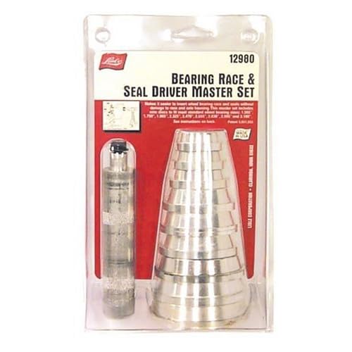

This is a REALLY nice kit. Fifty buck with free shipping at Amazon:
