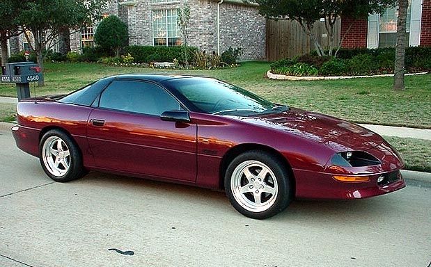

Big Rick had one in his 383, a ton of the MTI cars ran that cam also. All those cars would have ran times still competitive today. Better cams now? Sure. Lighter Valves that don't cost a fortune now compared to stuff back then? Sure. Better Springs now? Sure.
This was Chris' Z28 right?

Those are awesome wheels!!
I don't remember. I thought his car was red?
