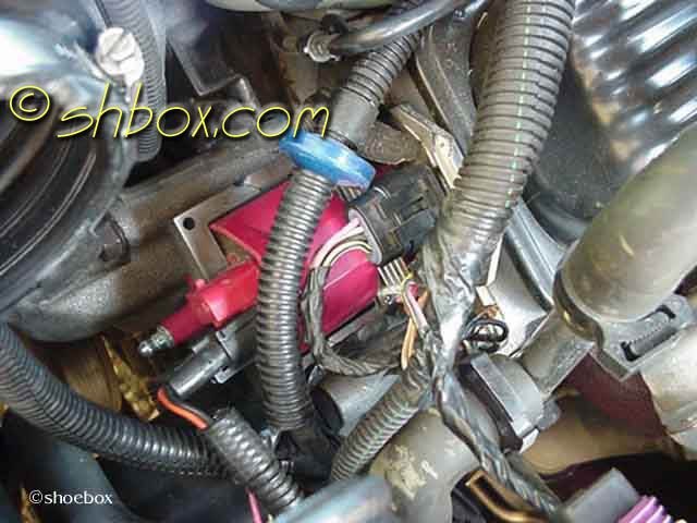

What is considered the coil? Because I just had the opti spark replaced, could it be mass air flow sensor? Someone else possibly injector or need valve adjustment.

The red thing here. It connects to your opti spark and is what actually creates the spark for the opti. If you've already done opti, plugs, wires it would be the next spark item most likely. I would test your fuel pressure as mentioned because it doesn't cost anything.
