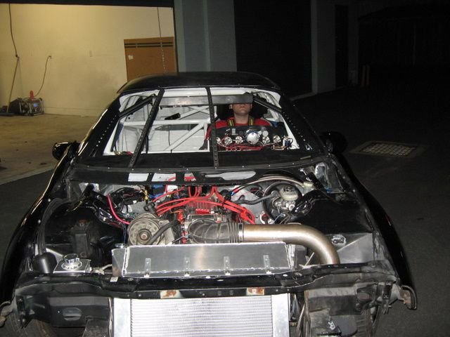

Replace with new stock stuff, seems to work fine for most the guys that actually road race these cars competitively.
This is a car Blainefab built for American Iron, notice the master and booster?
