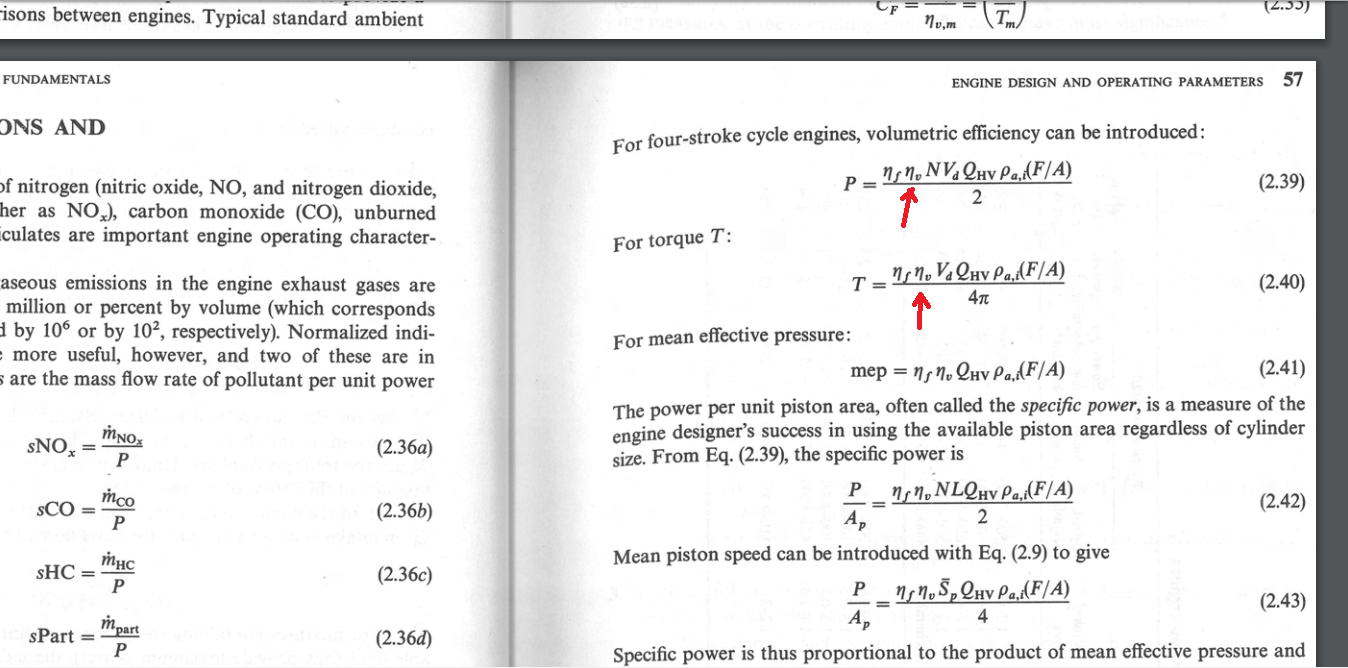

Originally Posted by kingtal0n
riiiight. saying it makes it true. I am also a rabid wombat.
Internal Combustion Engine Fundamentals - by John Heywood
Section 2.14 - Relationships Between Performance Parameters.
n subscript v(for lack of a better way to type it right now) represents VE. The following picture shows VE right in the middle of the Power and Torque calculations. So if VE changes, torque is directly affected.
