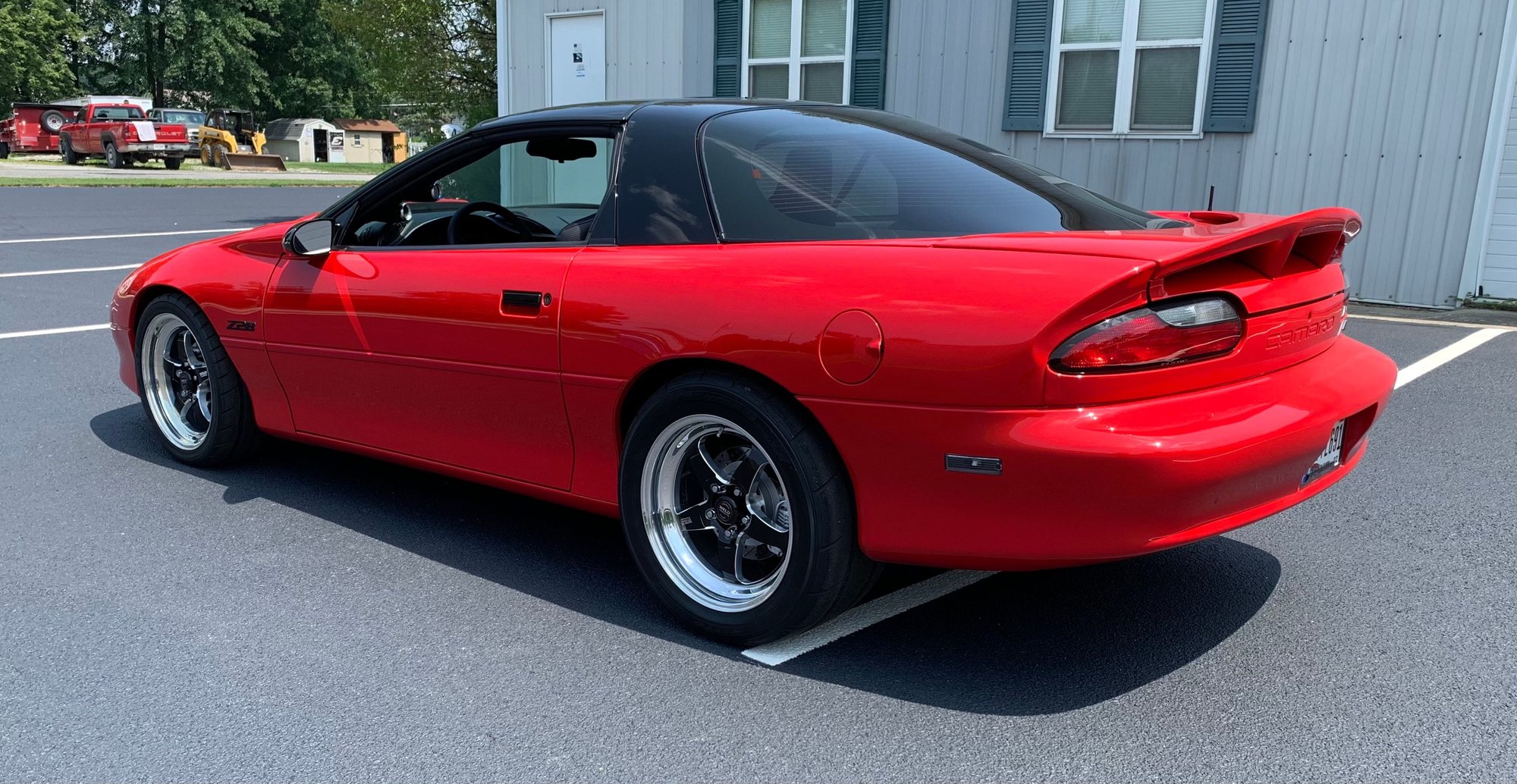

Originally Posted by CamOnlyJabroni
Currently I’m running a LS7 MAF, FTP104mm lid to a Chris1313 non a/c air box and it’s a restriction with the 383. I need to do this as well so I have room to put a nitrous nozzle behind the maf. Right now it’s a little too close.
I won’t change the exhaust for now. I have 1 3/4-7/8 stepped kooks to kooks true dual 3” exhaust. If the headers create a large restriction I will most likely get some 2” made. Really I would be happy with 7 at the crank or 600+ at the tire. Basically would like the car to run like a healthy heads/cam C6 ZO6.
Nice car! What does it put down to the wheels currently with the 383? And is it an A4 or M6?
It made 475 at 6,900 on a MD-500 Mustang dyno. M6 car
