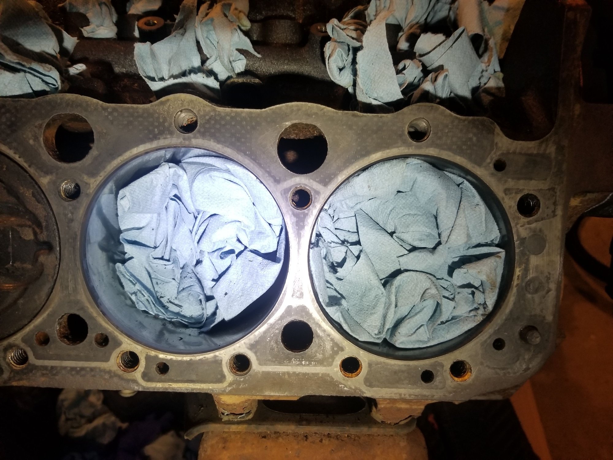

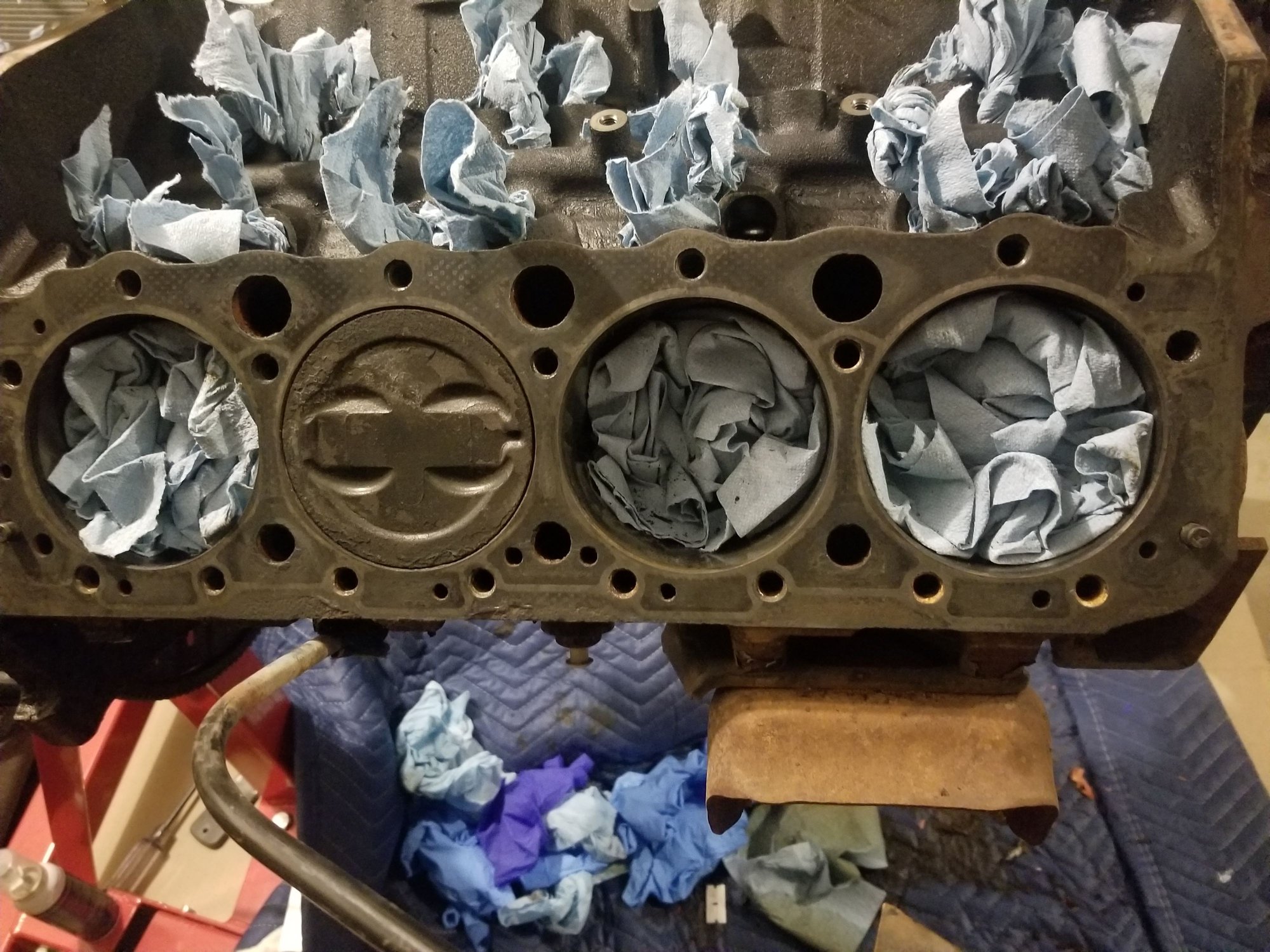

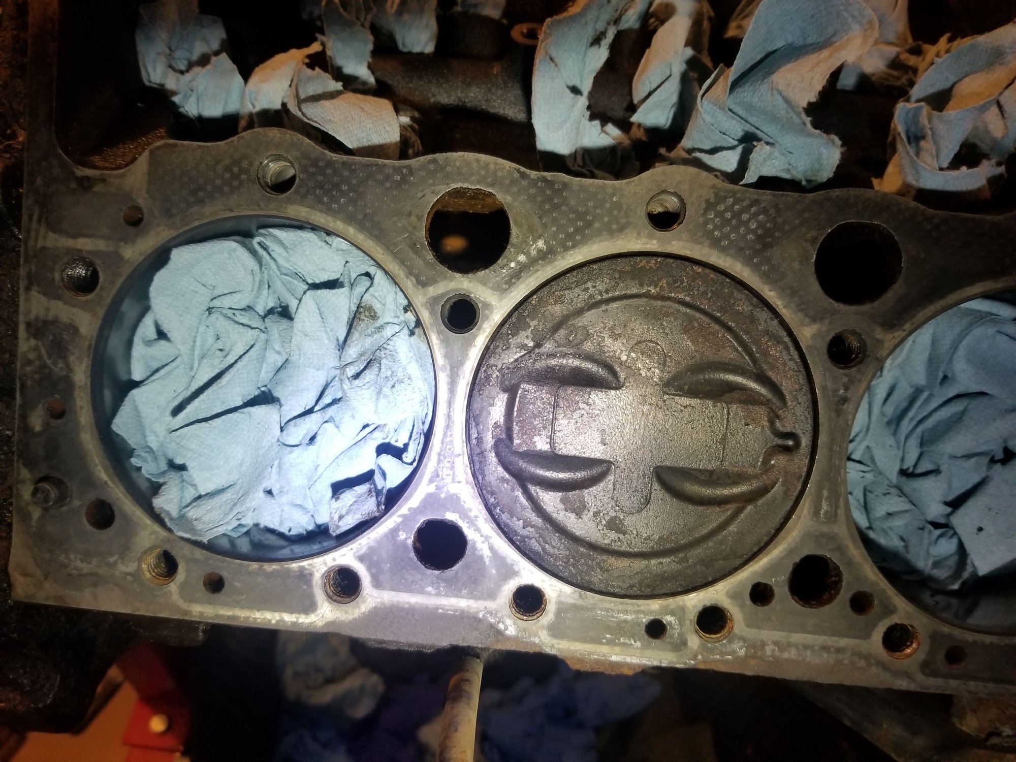

Hey guys I'm wondering how clean this deck has to be? I scraped it for 2 hrs with a razorblade and it's smooth but with some old graphite gasket stains is all. The lower coolant holes are a little rough around the edges but it seems all the vital sealing areas are smooth. See pics.
Bone stock rebuild.

When I was researching this, I read that if you can't feel it with your finger, the gasket doesn't know about it. If you have a straightedge, and run it over the surface and you can't get a feeler gauge under it, I'd say you're good to go.
EDIT: My block surface looked very similar when I put my gasket back on.

When we did my head gaskets we used the straight edge with a feeler gauge trick.

Totally normal. Scrape it with brake clean and a razor blade and as long as nothing catches with a fingernail you're good to go. Even though you have towels in the cylinders run a shop vac in them to get anything left behind.

Feeler gauge noted. Yeah there are a few spots that are a little rough with the finger nail around the bottom coolant holes and i scraped and scraped with the razor blade and its the best it will get.
