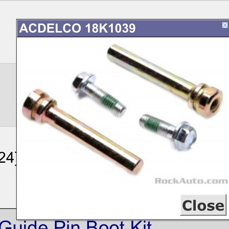

When I did the front brakes I lubbed up the slider pin with grease and used blue lock tite on the screw. Here's a picture on how it comes

Awesome. Even found that part on Amazon Prime. Thanks a bunch. I was completely confused when I went to change the fronts. Hopefully Brakemotive will let me exchange the LT1 style brakes for the LS1 style.
