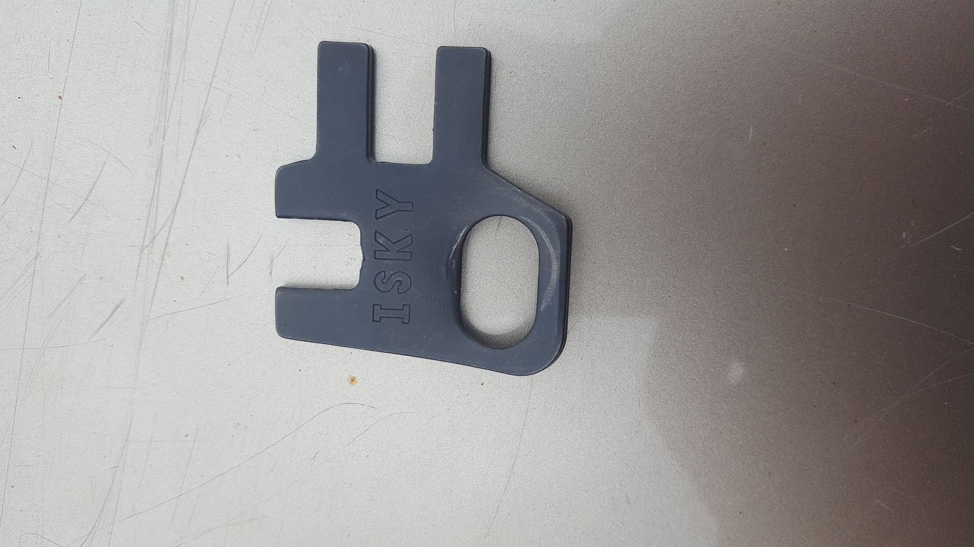

Went to fix an valve cover gasket on my motor and noticed rocker was off on intake valve of #6. Turn out that my 3/8 manley pushrod snapped at the top, and it bent my one isky guide plate. Has anyone seen this happen? Also since it bent the guide plate that means it caused the lifter to bottom out plunger wise, should i replace the lifter?

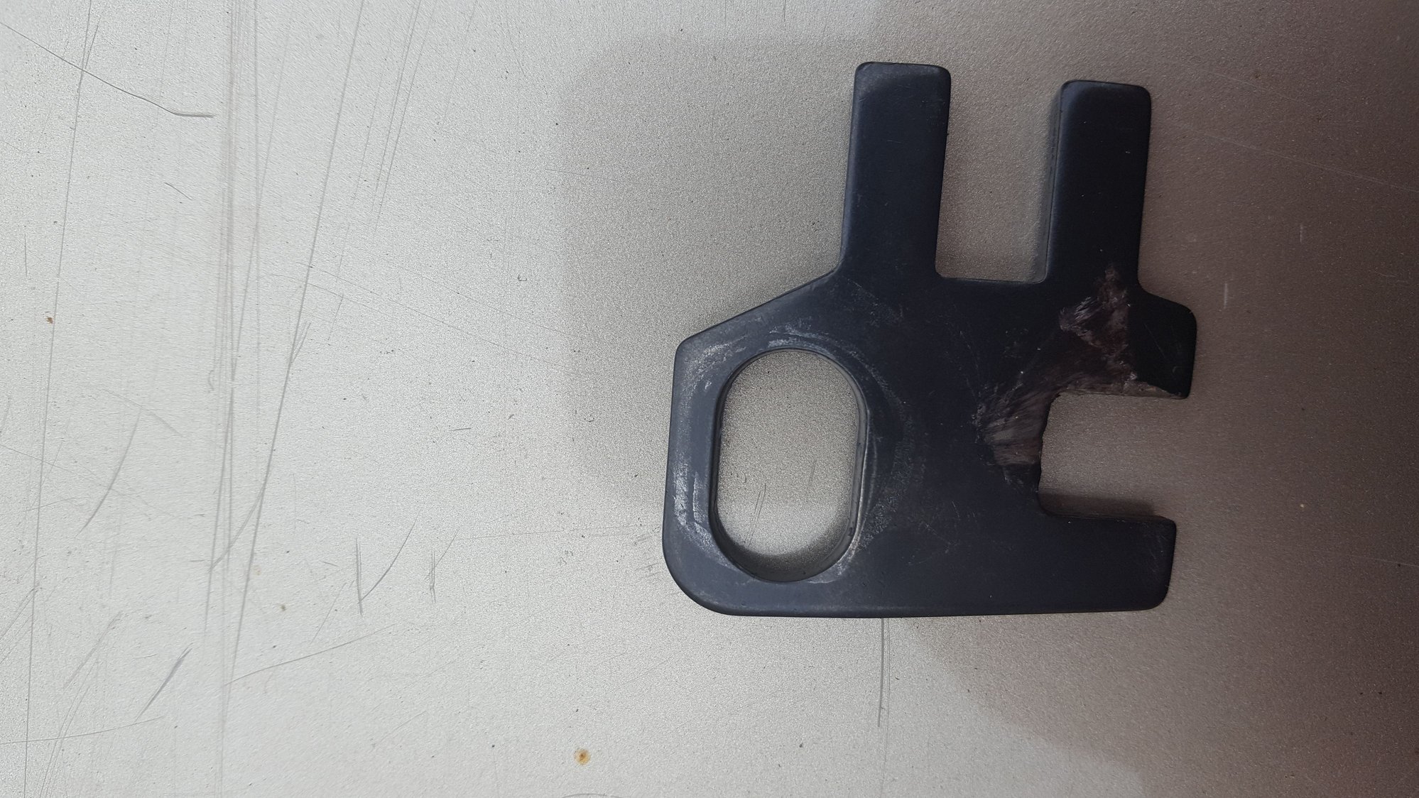

He said there was to areas of contact on the pushrod that shouldnt be there, the on to the left (pic below) i told was from when it broke and it danced around in the pushrod hole from the commetic head gaskets. The one on the right i have no clue.3/8 pushrod broke in half-20170929_175607.jpg. Also said 3/8 pushrod is way over kill and to big, but i like overkill. I still dont understand how it could sideload since i made sure the rockers were dead nuts in the middle of valve tip. I dont remember the pushrod touching the headgasket at all

My guess is either the guideplate loosened and moved based on those witness marks, or a fatigued spring caused the PRs to go nuts at high RPM. Maybe both?

Springs are brand new and shop checked them when they installed them. With the guide plate its weird, bottom looks like it has chatter marks but top has no marks . My guess is rod broke and from it jarring against guide it loosened rocker stud a tad.

no one told you that you needed to check and make sure the push rods do not bottom out on the plates did they. It broke because it was trapped in the cup of the rocker and was being flexed against the bottom of the guide plate. I have seen it a few times. Even lived it my self.
If I have said it once I have said it a million times. Push rods and rocker arm studs do not just "Break" there is always some thing causing it
