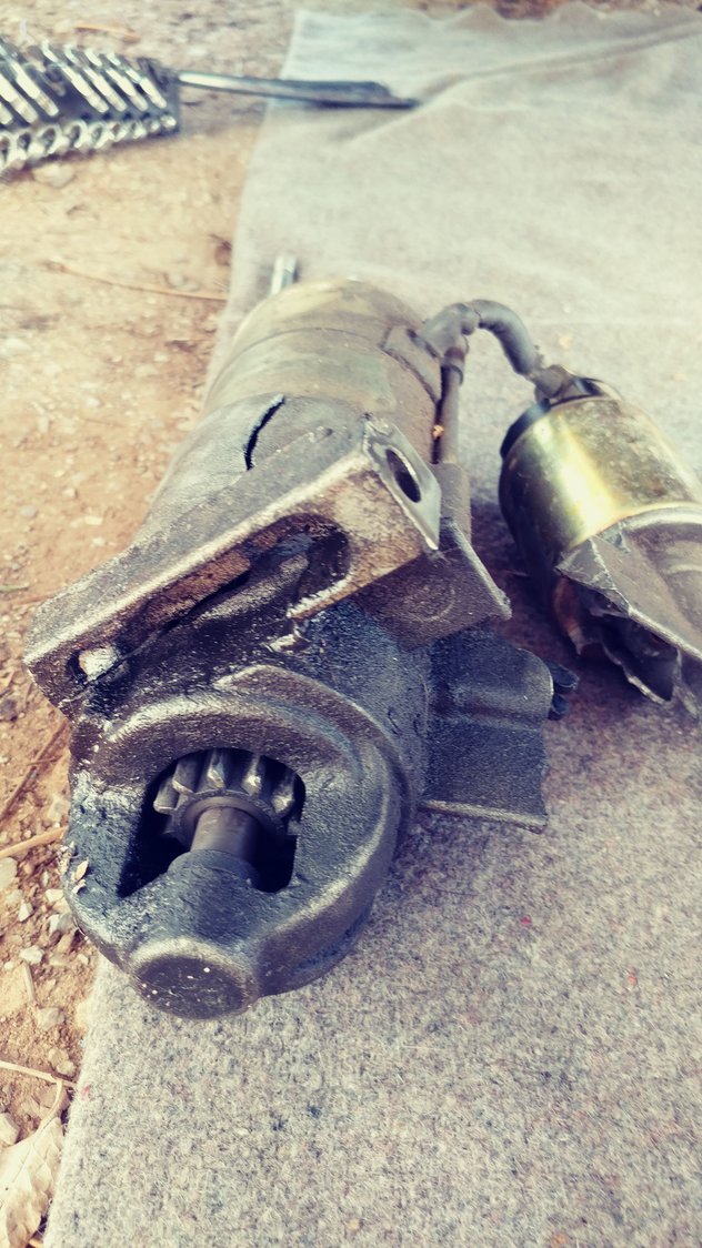

I had the same thing happen to me not long ago. Split my starter in two pieces and cracked it all the way down the bolt hole on the longer side.
what exactly happened? Was there a reason it started doing this?

I'm not really sure what caused this. My assumption is that the stock starter couldn't handle cranking over a higher compression engine.
