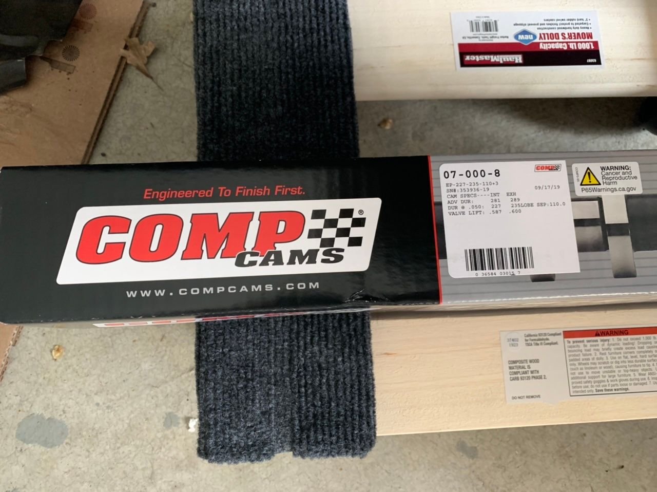

Oooohhhh parts coming in

Lloyd does very good work and is really good on communication. He spec the Lunati spring kit also for the heads?

He is putting in Crane dbl springs
