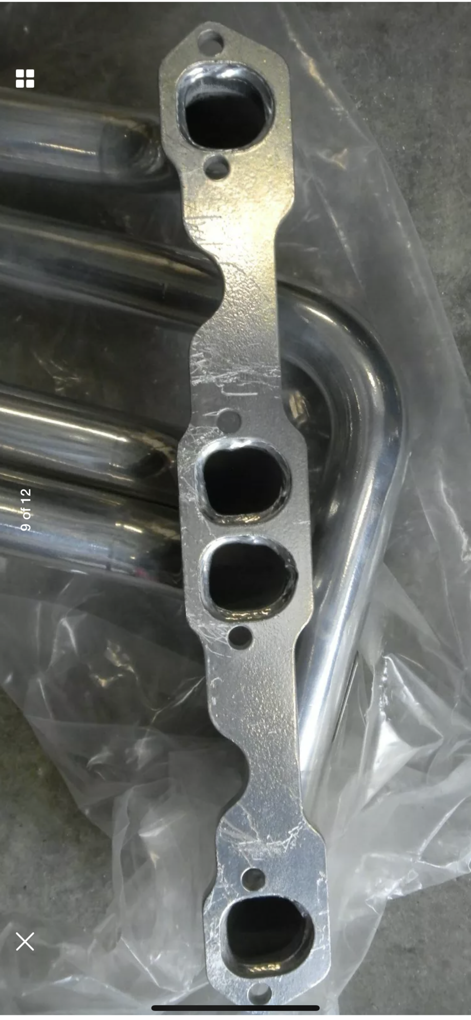

Also went back and found this pic of the header. Are those scratches maybe my issue? Typo in first post. Bought these used not new

I had a flange that was bent. the tuner used 2 metal gaskets and it's now fixed

Does not appear bent from what I can see, but I have some choice words for the shop that said it was all fixed. Lasted 5 miles.

I’d say check the flange with a straight edge but I know you really don’t want to pull the headers completely out. If you do pull it the area where it’s leaking should be obvious. Check it with a straight edge and find out if it’s high or low in that area and try to straighten it if possible. Header leaks do suck man, I can’t say I’ve ever had as much trouble as you’re having.
not what I would call a "smooth" finish. The FelPro 1470 have always worked for me but you could try, since the FelPro didn't work for you, the ones AtlantaDan notes. Might want to hit the flange with a long sanding block to smooth it out...assuming the flange is not warped
http://catalog.remflex.com/CHEVROLET...ket_p/2042.htm
If they don't you have a warped flange..
Your advice has always been spot on. What’s the difference between Fel Pro 1406 and 1470? Also I’ve seen people recommend the Remflex 2022 vs the 2042. I want to try remflex last as I read once they are on, they leave quite the mess that has to be scraped off. Gonna call the shop tomorrow to see what they will do. Also supposed to get 4-6” of snow so....anyone wanna buy a car lol?
