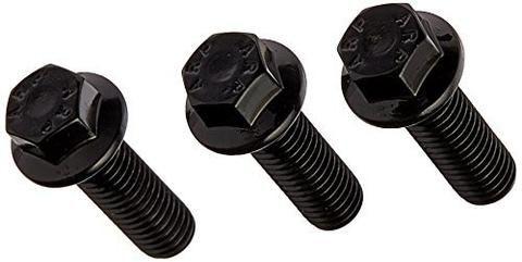

What header bolts are you using?

The text disappeared. They are 1”, 3/8 six point head and came with the tubes. They do not say ARP

Proper!
