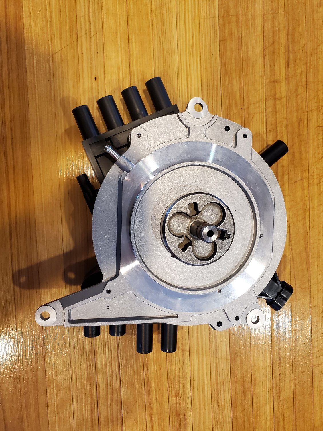

I just recieved my AIP Opti from SacCityCorvette today. I looked around for a while for reviews on this thing before I bought it and really couldn't find that much. At least not since the redesign.

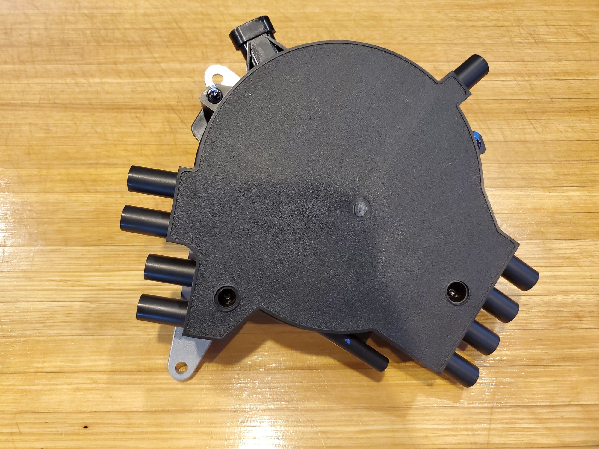

I bought the vented version. It included the harness. I found a few posts from other sites complaining about bearing play out of the box. This one has none. Not side to side or front to back. The cap looks kinda cheap. I wanted to replace it with an MSD I have laying around but they marked all the bolts and void the warranty if removed so I didn't bother. I plan to put it on the car in the next few days. I'll update this then.

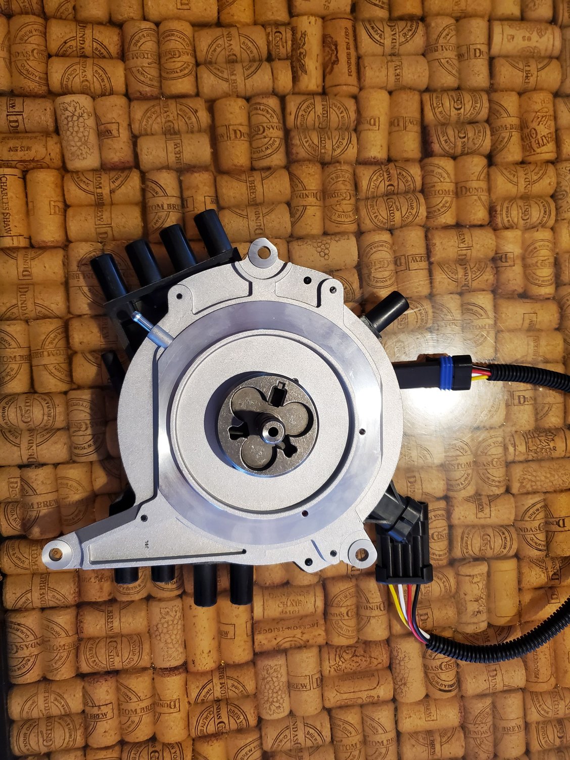

The new one showed up today. This one has a different cap on it. I know they updated the design at some point. I'm thinking the first one was a leftover.

Installed the new one today. Ran and idled awesome. First time it hit 4k, motor cut out for a split second and popped a code 36. Ran great after that. I cleared the code and it comes right back everytime I hit 4k. Like clockwork.
