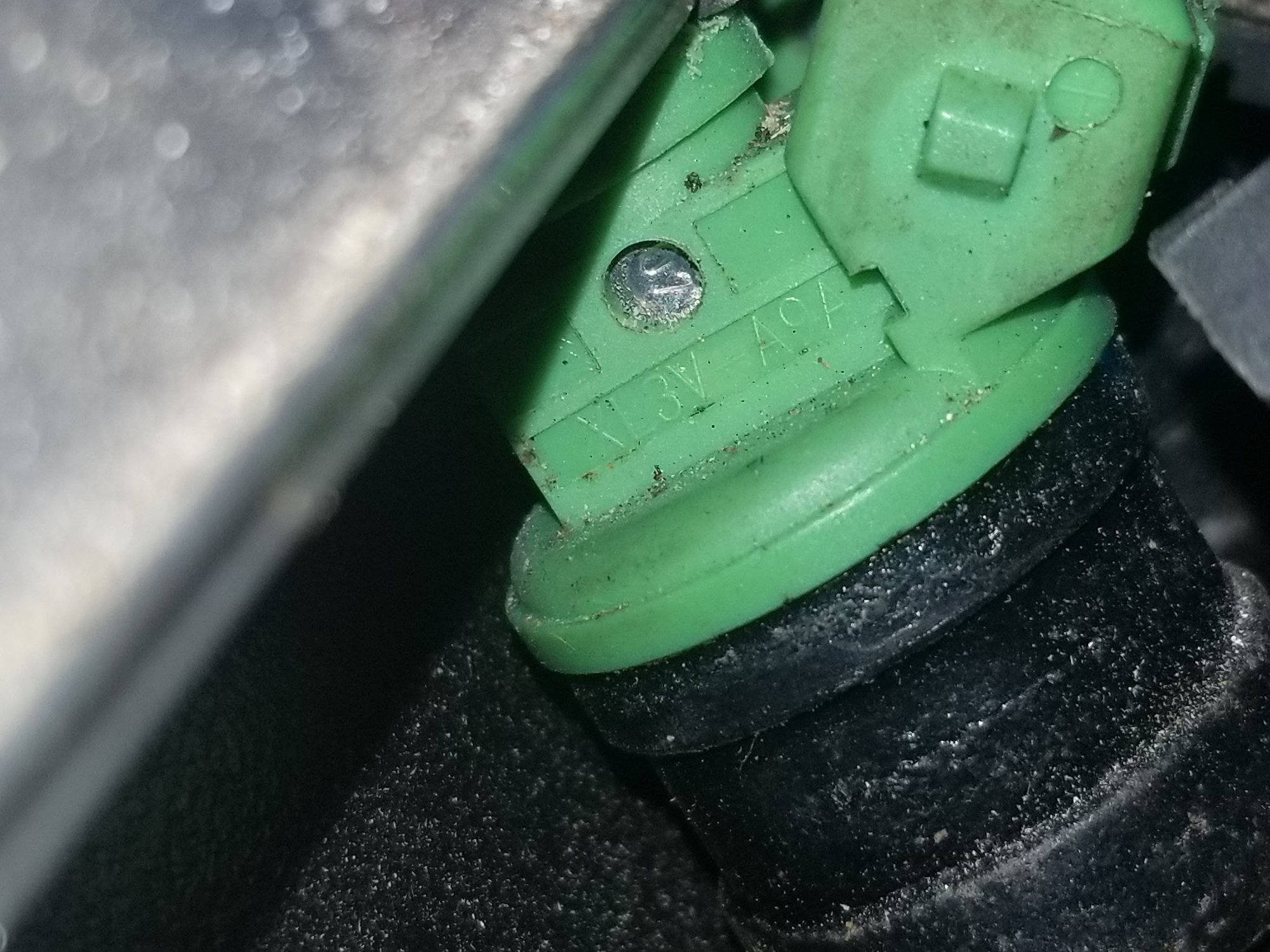

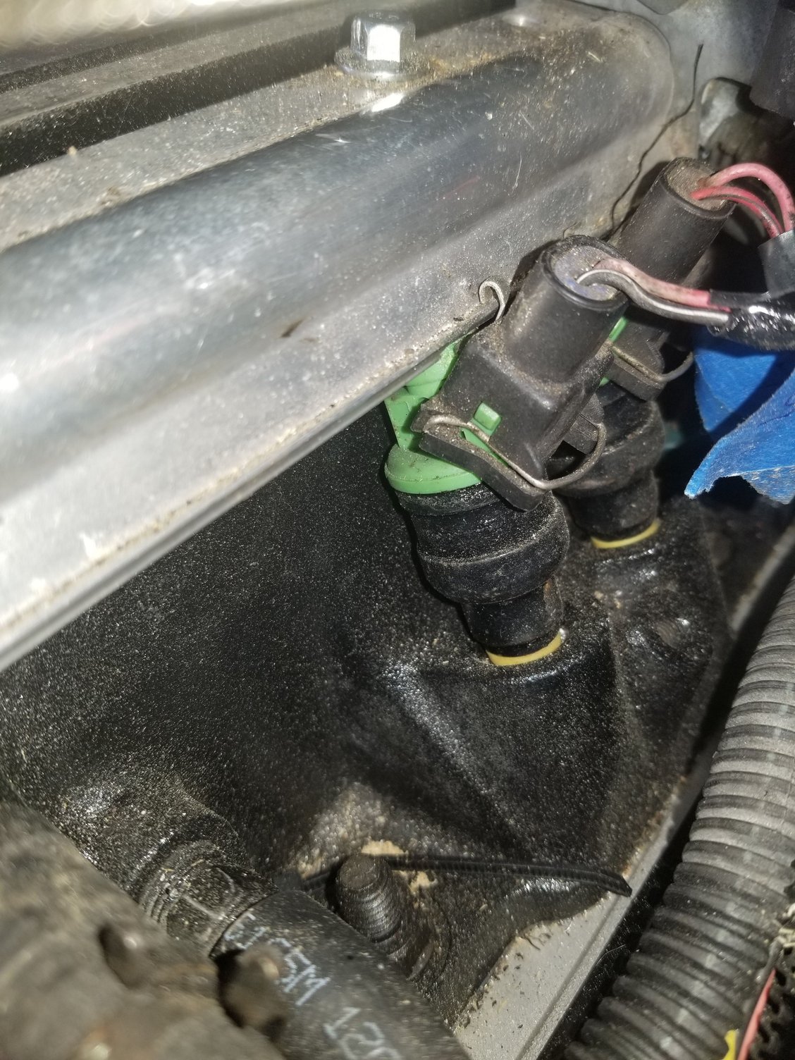

I may simply be over thinking this, but I had my pcm tuned by Moe Bailey and in the questionnaire thingy you fill out, I put that I had stock injectors, one is plugged now though and whilst perusing new injectors, I see that different colors are different flows, and I don't see any green ones like on my motor... am i missing something? Stock ones appear black in all the pics I am seeing.

Those look like the older style Ford SVO 42# injectors. They could also be some cheapo injectors that are made using the actual or look alike Ford green top injector bodies, unfortunately I've seen this a lot on eBay.
Best bet is to see if you can identify any markings on them. If you take off the connector you may be able to see better.

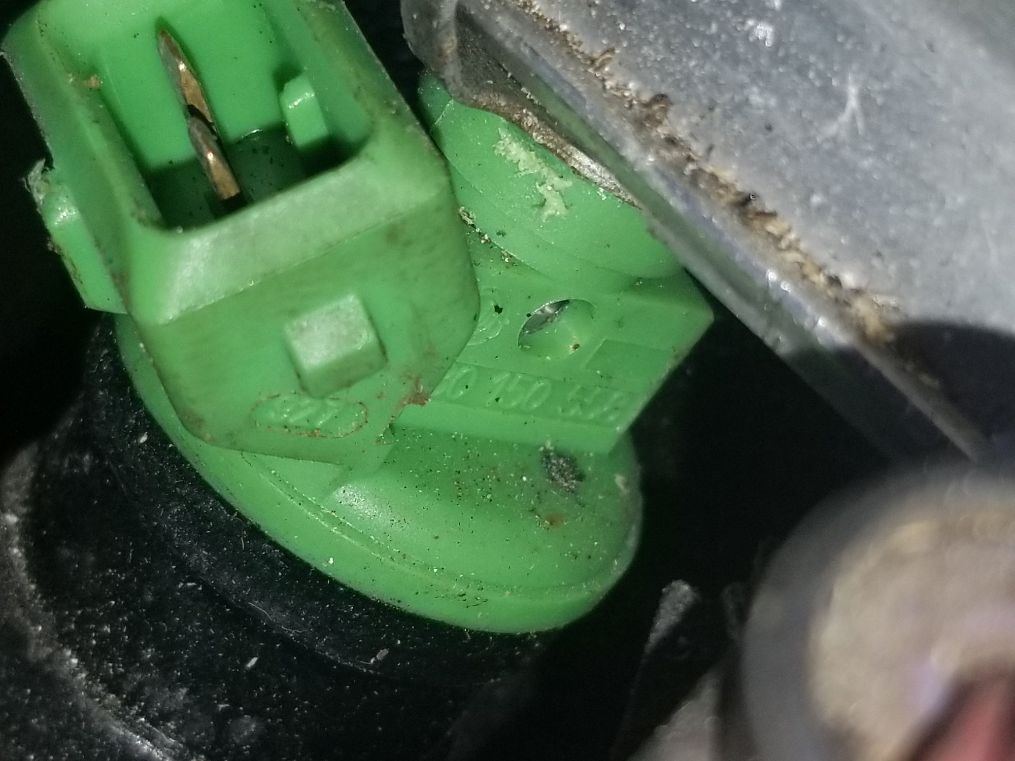

Everything I am finding says 42 lbs and I need to tune for that... I have an email in to Moe now...

Those appear to have the correct markings to tie them to a Ford SVO 42# injector body. That doesn't necessarily guarantee what's inside since we don't have any paperwork, etc. from the PO but strong chance you have 42# injectors there. If it were me I'd send them out to be cleaned and flowed so you know for sure. That's a lot of injector for an LT1, does your setup warrant that much fuel?
I know with the LS stuff it's ok to run too much injector since you just scale it back. Not sure if the same can be done with LT1s.
