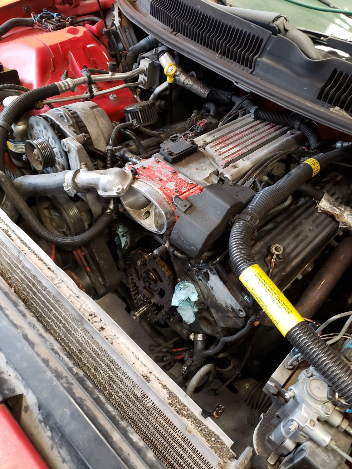

So I finally have the time to put all my parts on with this quarantine.
So far I have the car torn down to the timing chain due to a bad opti (wet) and oil leaking from my front cover. So I'm doing all those seals and my oil pan gasket, I have all the bolts on the pan out, just ordered a engine hoist chain for my cherry picker.

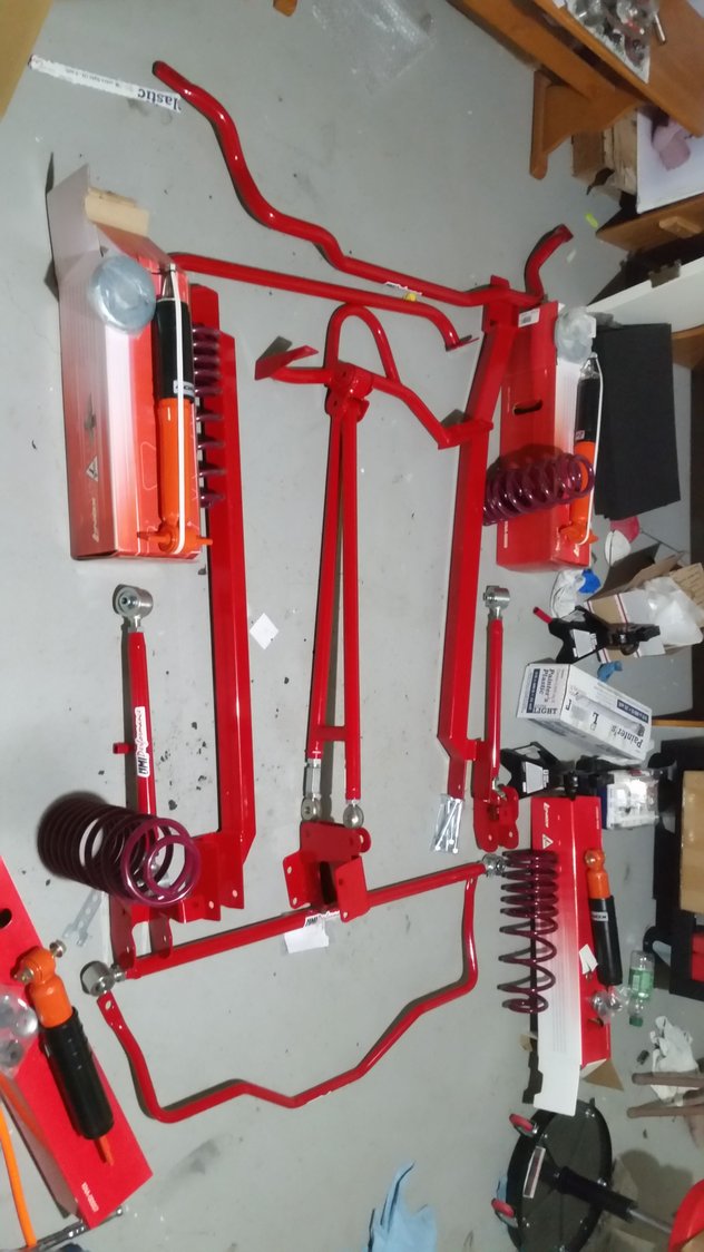

Here's a rough list of parts I have to install
-front/rear koni shocks with vogtland springs
-umi adjustable panhard bar + Lcas all with rotojoints
-weld in subframe connectors (dont have a welder so NA I assume)
-Fully assembled 3.90 Rear end with detroit tru trac
-Adjustable torque arm
-Poly Motor mounts
-Umi Front & rear sway bars
-Strut tower brace
-Full exhaust headers back (going from 1 7/8 to 1 5/8) 3 inch back, straighpipe, will weld in walker quiet flow and a cutout
-Lunati voodoo lt1 dual valvespring kit with 1.6 RRs
-Steering rack assembly w/ tierods
-Wideband o2 sensor
-ram clutch
I have the car on jackstands right now, I'm thnking of dropping the whole k member to the ground and doing all front suspension parts I have, steering rack, oil pan and motor mounts then put the k member back in and finish the front timing cover, a little unsure on how to support the engine other than using the hoist I have....then removing the headers and exhaust (then finish plugs and wires with the nice clearance). Before I put the new exhaust in I'll drop the rear, finish exhaust then put the rear back in with all new suspension parts. Lastly after I get it all back together test it make sure its workin, then do the springs and roller rockers...I'm not sure if I have the capabilities to do the clutch by myself. I have done it before on a lift with a friend who knew what he was doing. I think I can handle the mechanicals but working by myself under the car removing the trans seems difficult.

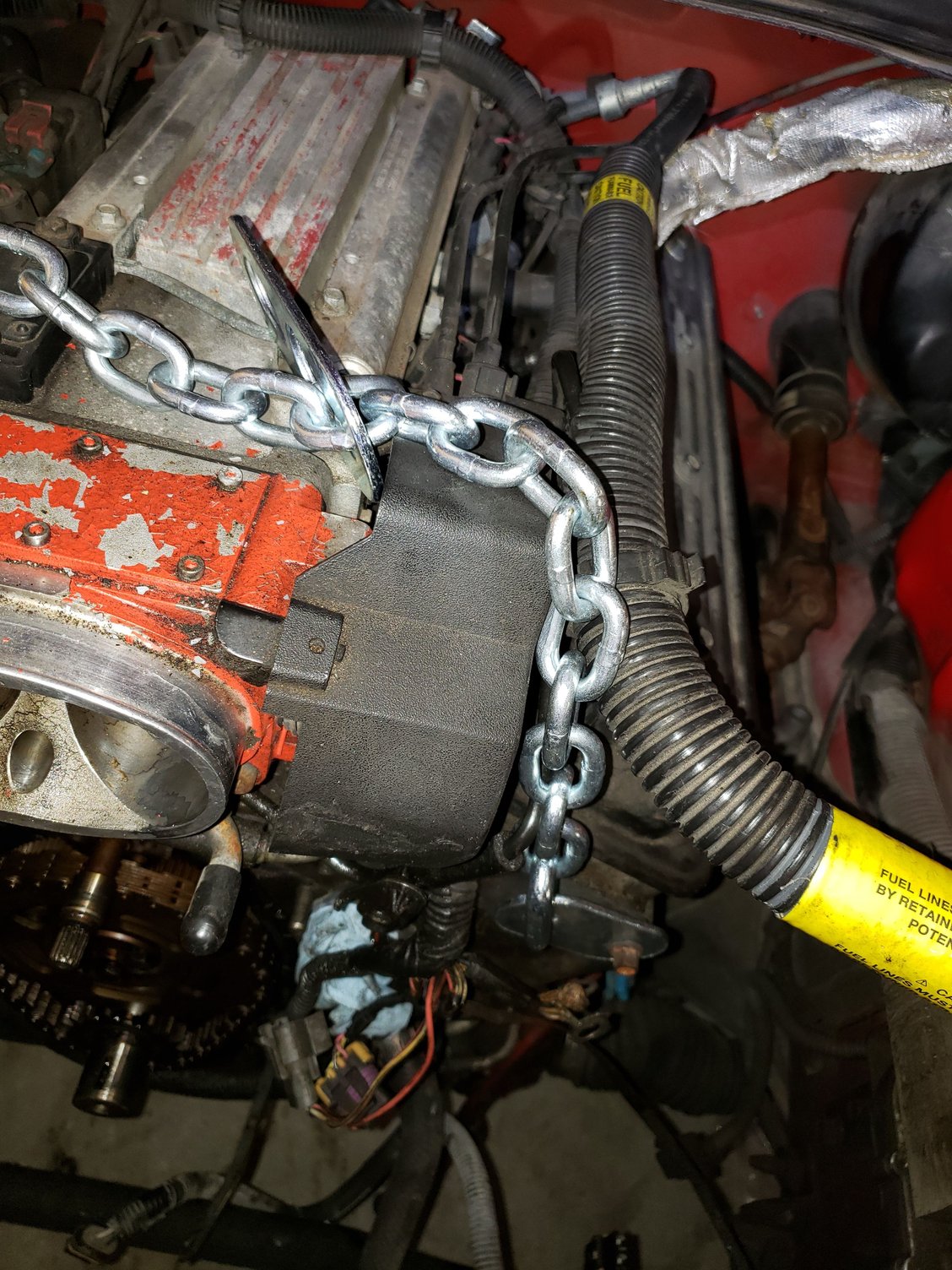

Here's an update, pretty sure I'm ready to lift the motor a bit and drop the k member to do the oil pan gasket.
I got exhaust off and torque arm and D.S too.
Slow progress but not terrible.

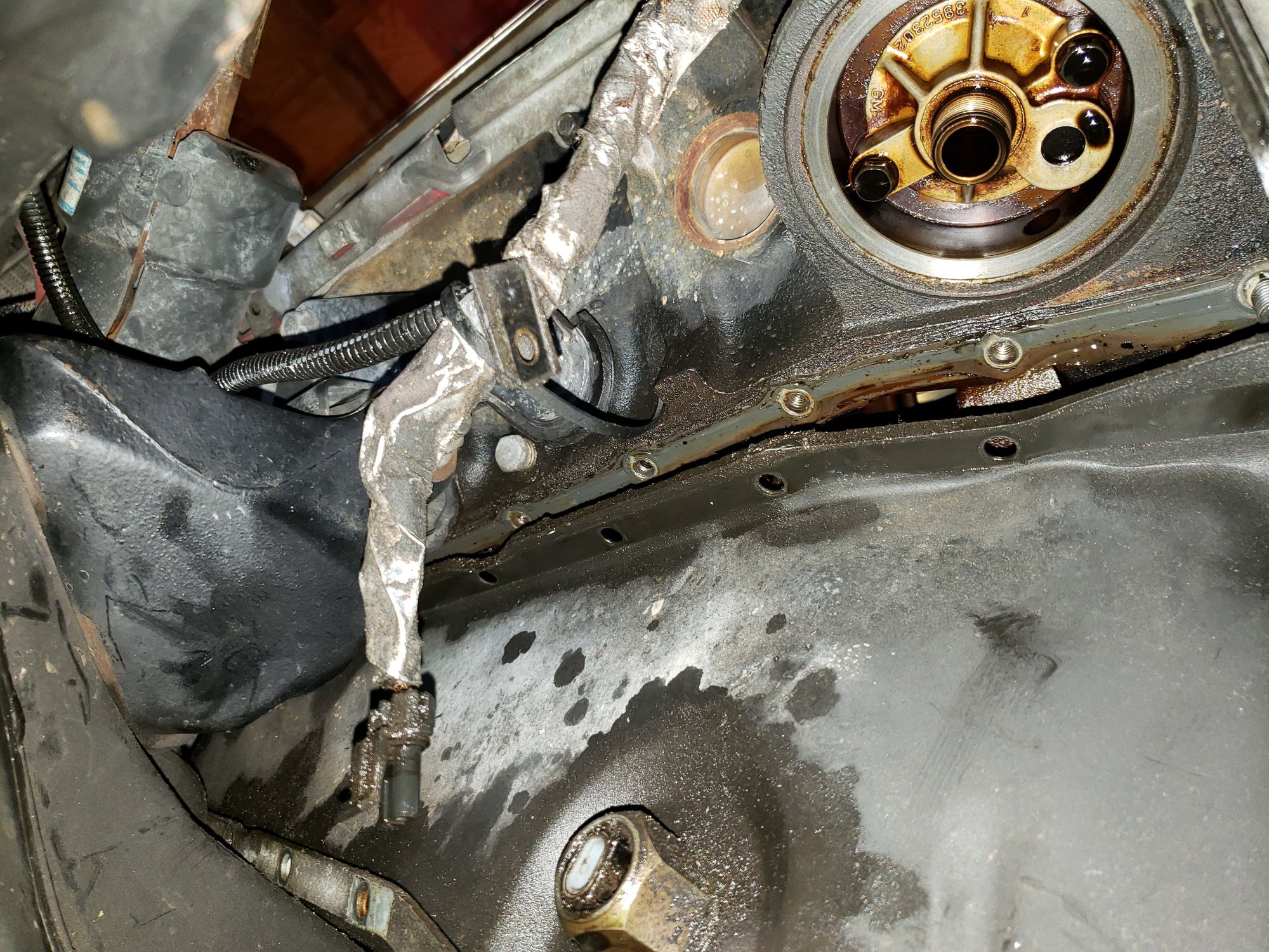

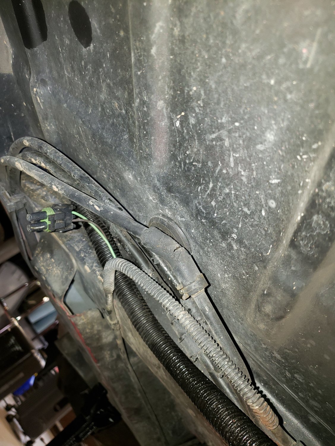

Did a bit of inspecting, I have an ac leak and trans
leak, (see pics),the drop is formed and casing is wet but I never noticed any spots. Seems to be covering most of the trans maybe seeping from the seams in the case?
Could not believe how many exhaust leaks, 3 of the 8 cylinders, then extremely black Mark's on the exhaust where it slipped together on all the joints...I bought aluminum tape to use on the slip joints, I think it would work really well to help seal. Unsure about the y pipe hitting the floor, had this issue before and it sure was annoying, I am going to do motor mounts, but I was looking at my stockers, dunno if there original bit they dont appear to have anything but superficial cracks, not bad shape to me, Similar to my trans mount.
Anyone around CT need a full a 3.23 rear end? Not looking to keep this one once I pull it..
Another thing, I'll probly add a picture tomorrow but I noticed a hole in the rubber joint that connects one of my fuel lines a little behind my y pipe...I am not leaking fuel so I assume this is for venting? Unsure, can that cause my to lose pressure at the fuel rails? I almost instantly bleed down all fuel pressure and I have a new regulator and newer fuel pump
Ac leak? How easy is that to fix?
Plugs and wires out, headers off.
Timing chain is next
Oil pan bolts out
Sensor was left connected by a few bare windings of wire...will have to address that.

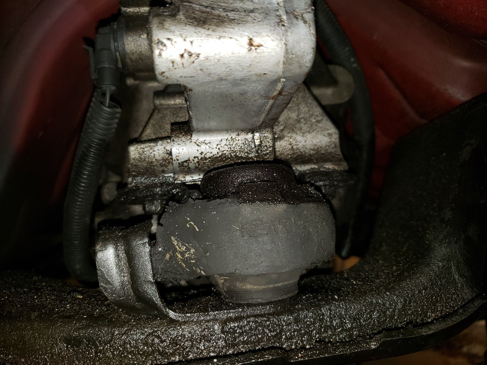

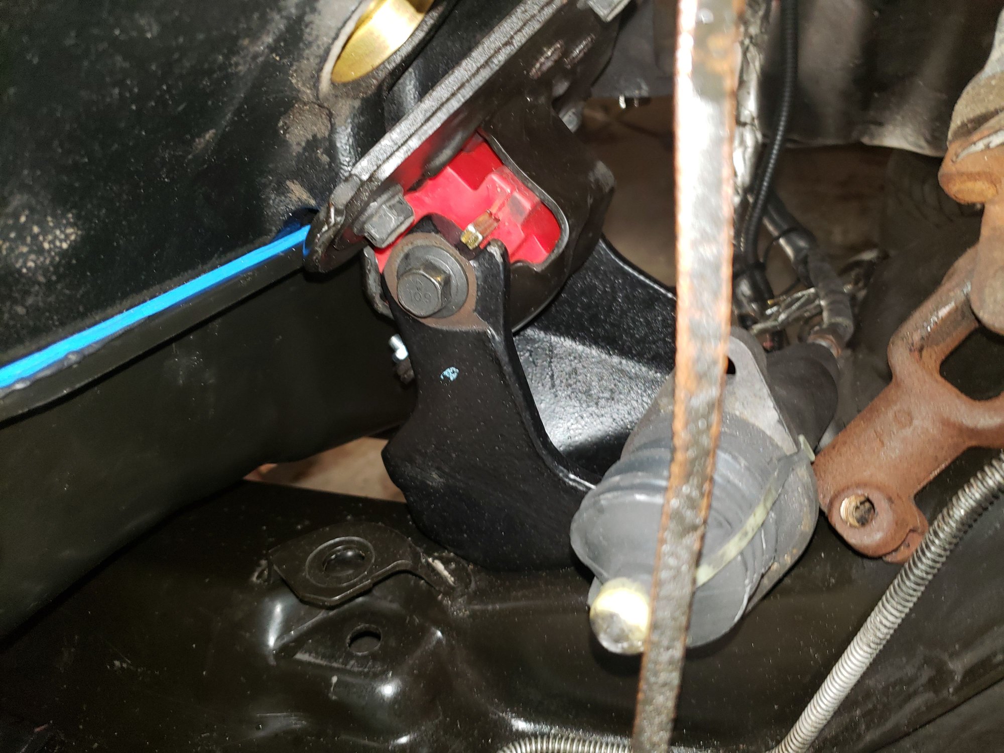

Does this trans mount look good?
Trans is wet.. drip accumulated on bottom..no drips on floor. Though, need to check trans fluid...

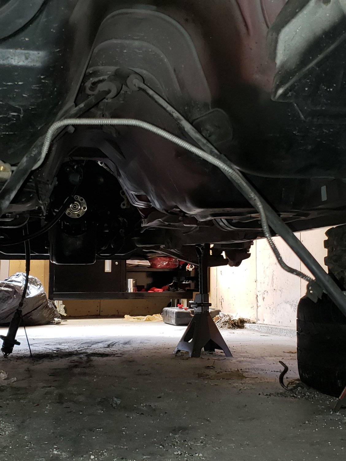

Got the rear out!
Was pretty easy...using 2 jacks (one under pumpkin, other under yoke and 2 jackstands under axle tubes i was able to lower it and roll it out of the way without muscling anything myself. Very happy with how that worked out
Transmission was not as fun. Using 2 jacks on front and back of trans with a ratchet strap to one jack i tried getting it out. Was not fun, ending up falling off jack and the tailshaft landed on my chest and covered me with delcious transmission fluid.
Trans is from a donor car. Apparently they broke off the reverse lockout then epoxyed it back on, i was thinking of deleting it but i have real alotof comments warning not to. Any ideas? Maybe i should just wire it up

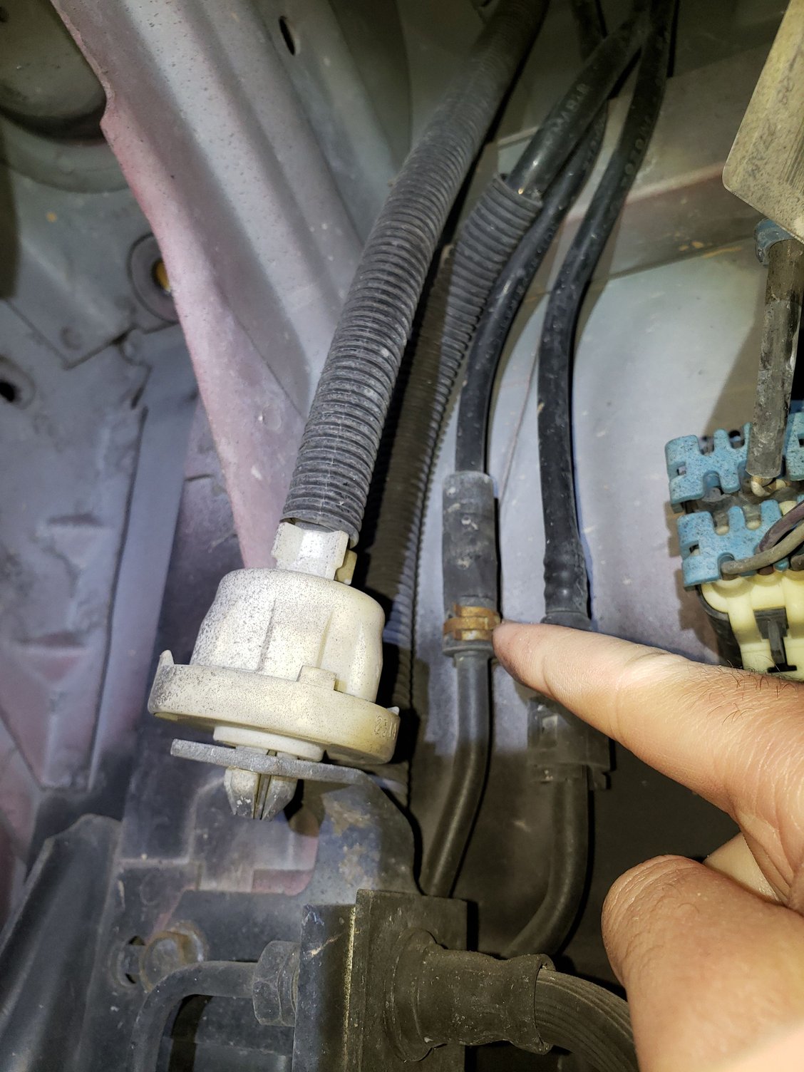

I have a crack in that rubber connector, i am not leaking fuel so i assume its for evap. Can this be causing my almost instant loss of fuel pressure at the fuel rail when i turn off the car?
Following that cracked line leads back to this
Opinions on lifting points?
After thinking further i think i need to move the passenger side as far back as i can so its more balanced

The EVAP line should have nothing to do with the fuel pressure leak down.
Old Apr 24, 2020 | 09:14 AM
Bengtson95's Avatar
Joined: May 2015
Posts: 367
From: connecticut
yeah I didnt think so...what is that evap line doing? What if I just left it like that?

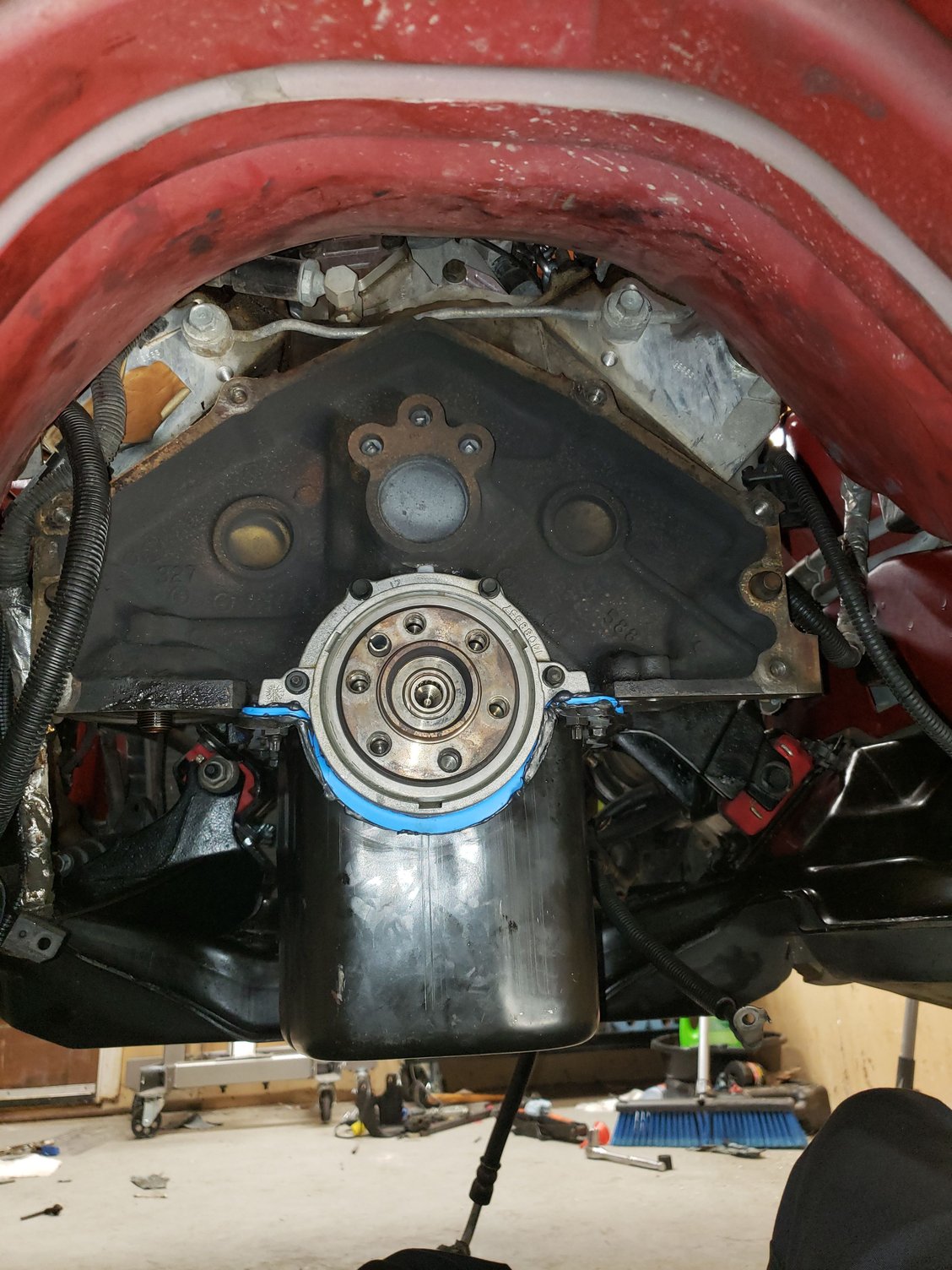

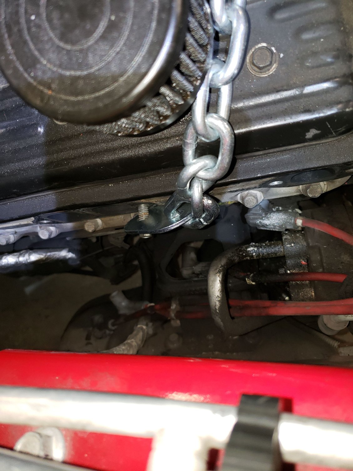

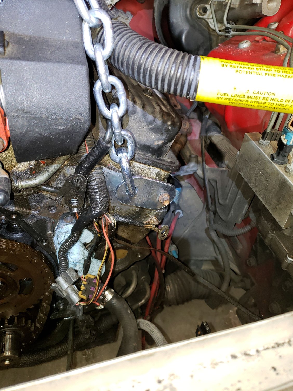

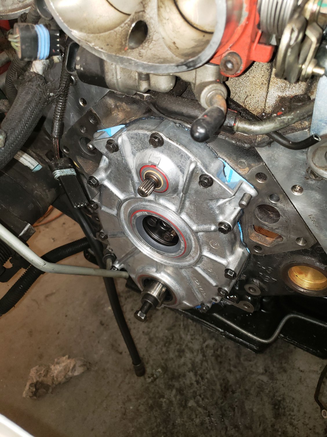

Another update! Hard parts are done! (Oil pan) lol...that was terrible to do! Lol
so far this is what I have done
new timing set
new timing cover seals
new rear main seal
New rear main seal housing gasket
Fixed vacuum leak for pcv system
also got a whole new pcv system with catch can to keep oil out of intake.
trans is removed (removed it by myself, NOT FUN trans fell off my supports and I broke the fall with the tailshaft on my chest lol)
-bought a trans jack for reinstalling lol
rear is removed
Went to install my opti, realized I only bought msd cap and rotor, so I looked online, I found a acdelco distributor (no cap and rotor) and in the picture it shows the Mitsubishi sensor...so I bought it, for 190...hoping the one I get also has the Mitsubishi sensor and it's not a ploy in the stock photo!!
Also...dont think I had shared this in info, when I removed my old distributor...unknown brand, I took it apart and the cap and rotor were severely corroded and there was oil inside the optical sensor area, also two of the terminals on the distributor were black, not clean brass. So that was definetly a bad part. Also one of the plastic rings on the shaft was broken and deformed probably during installation..will not have anyone else work on my car!
You can zoom in and see the Mitsubishi symbol
