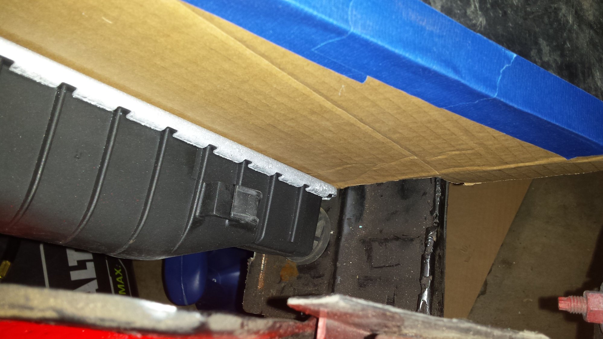

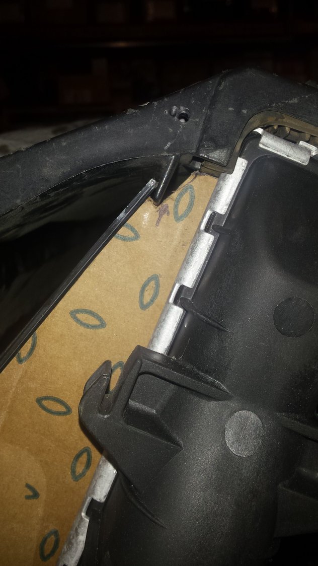

Cardboard is good as a proof of concept. The thing we can't see is the side bits on the bottom of the shroud. I'm guessing those were left open which is a no no. It'd probably also be a nightmare to cut those pieces out. This is the shroud I made for my car.
If/when I make another/redo this one, it'll be all aluminum as the plastic distorts with heat. I may do that sooner than later as I can just trace the plastic bits onto an aluminum sheet, cut it out, and snap it all back together.

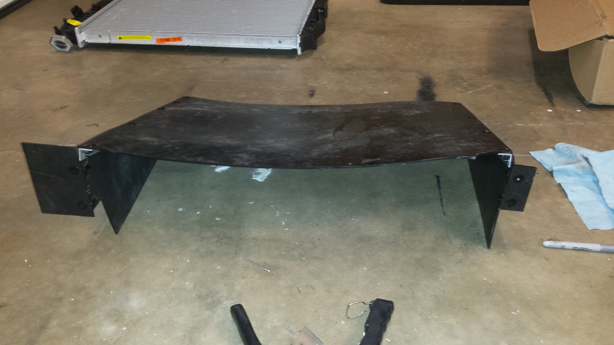

Forgot all about this, here are some more pics of my shroud. I started with cardboard. Hell, I dyno'd with cardboard last year as I was in the middle of making it.

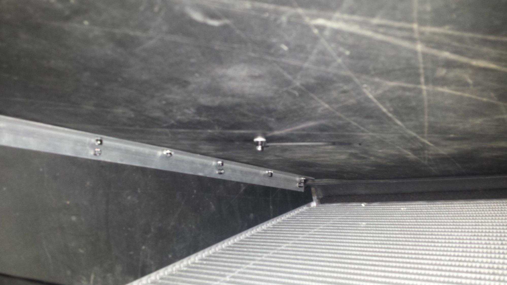

This goes all the way up into the upper shroud, there's a lip it tucks behind on top.
The side pieces were more of an asspain to concoct.
I probably made a half dozen sets of these things before I got a shape I liked. This was not one that I liked.
I believe this was the piece that I liked. Here you can see the lip I was talking about before.

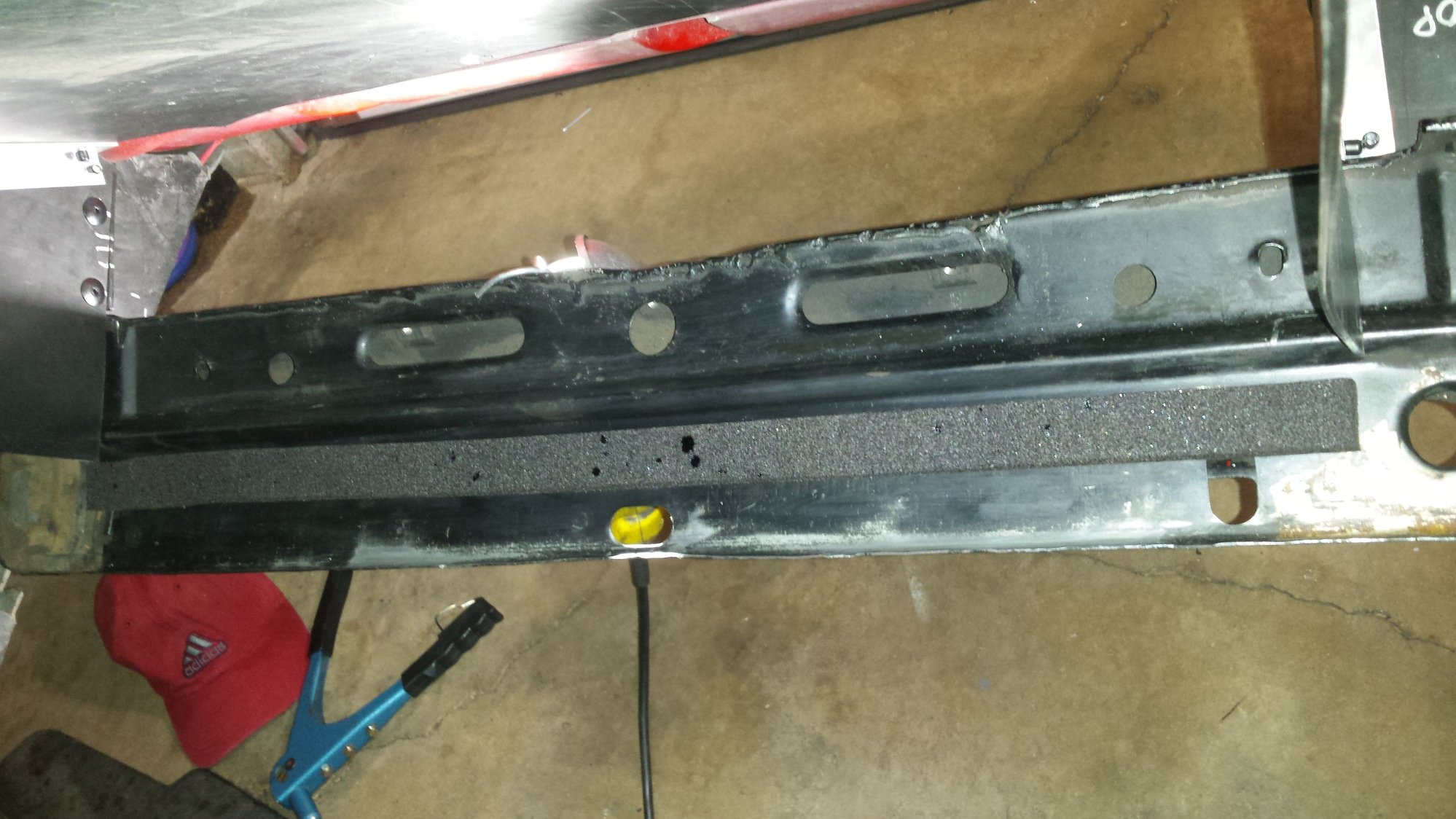

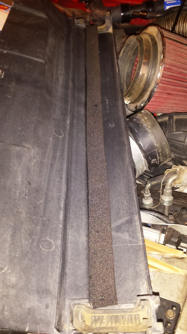

I put this expanding foam tape on the bottom, it grows to 1" thick.
Same thing up top.
Here you can see the side extensions I added so no air could sneak around the shroud. If you make one, use aluminum. The plastic deforms significantly with heat.
