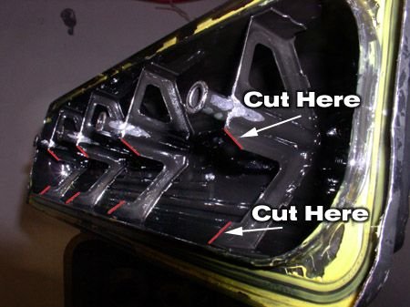

If you have stock metal LT1 valve covers you need to trim the intake side of the baffles. Easy
