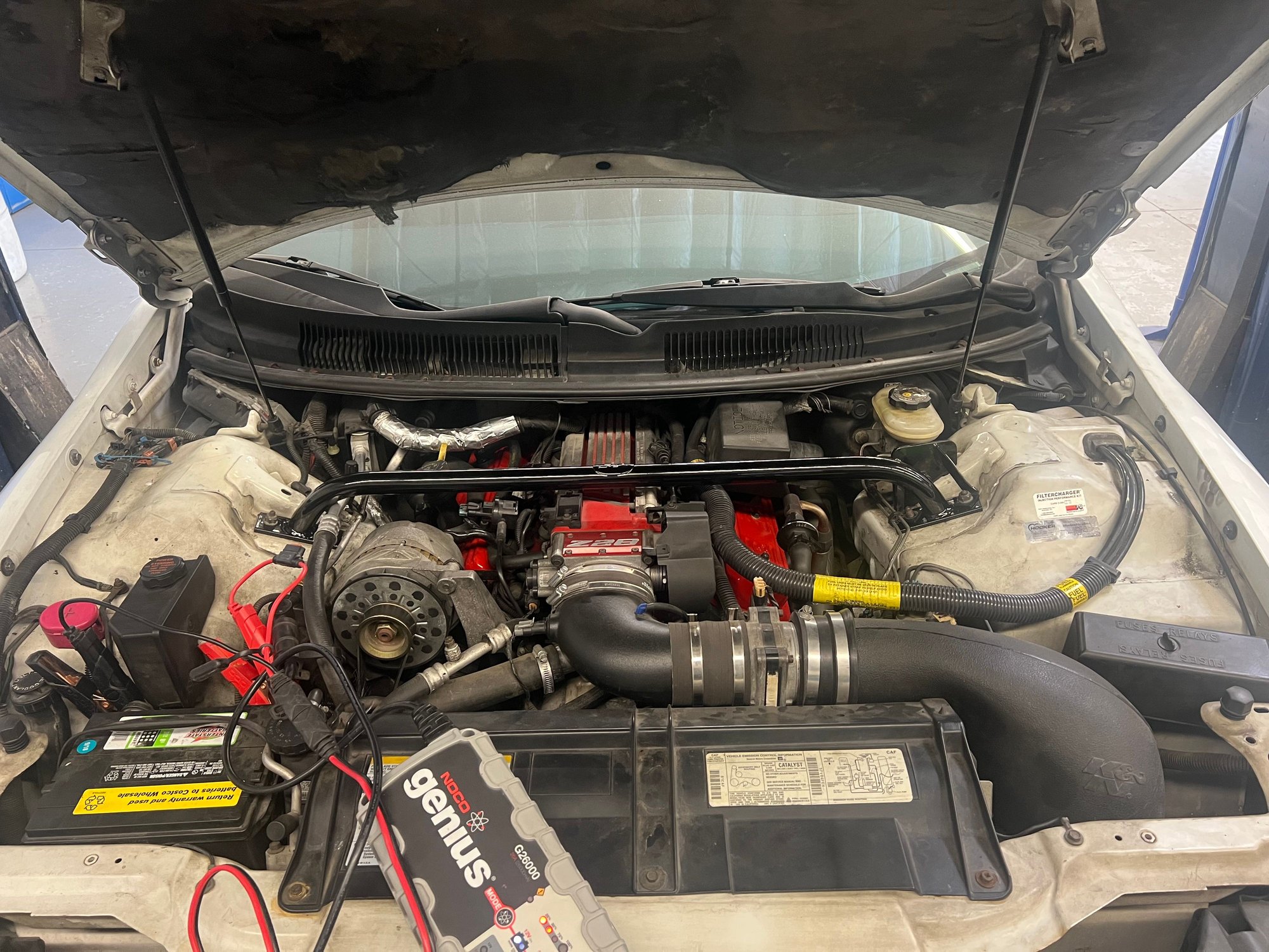

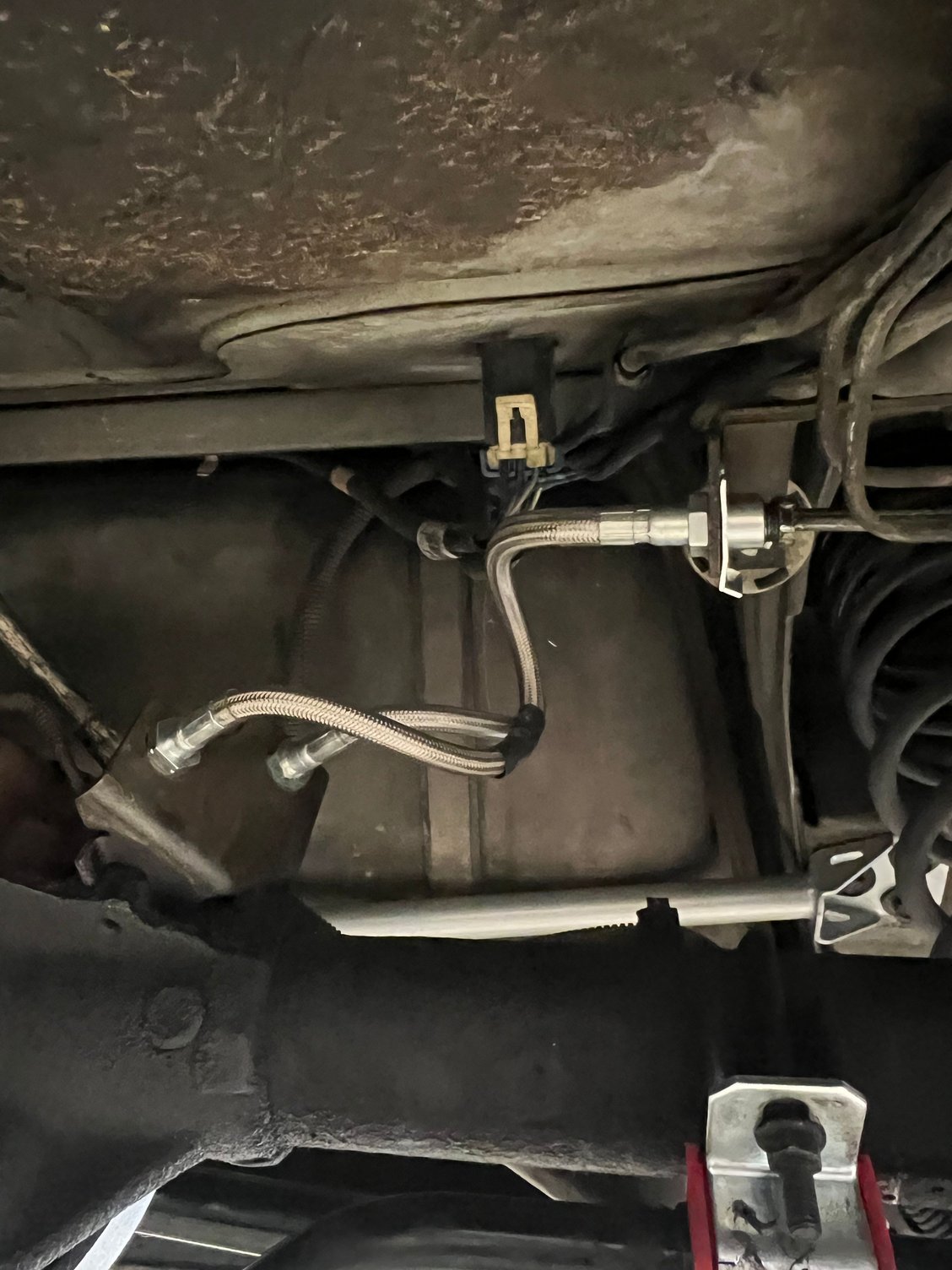

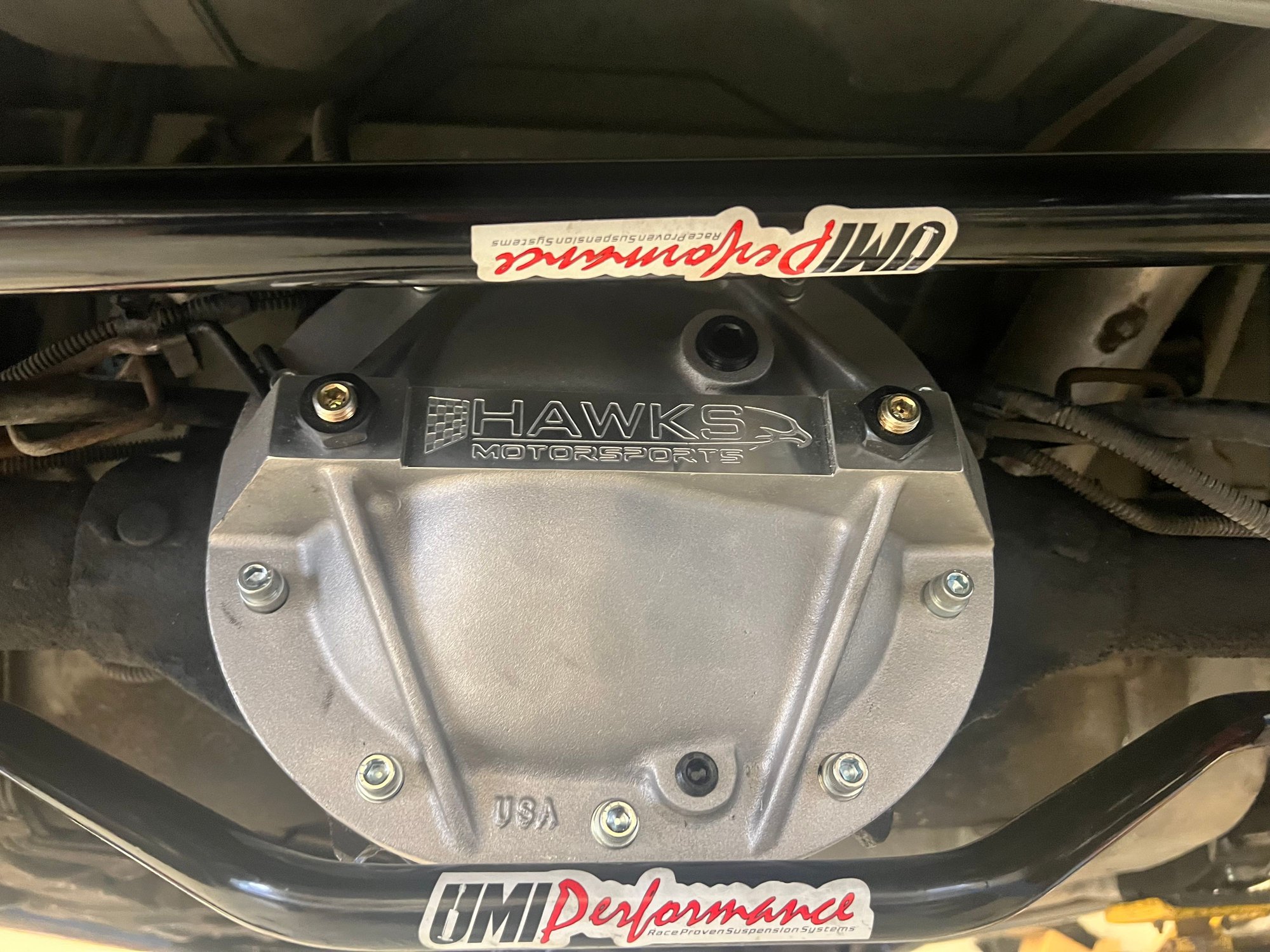

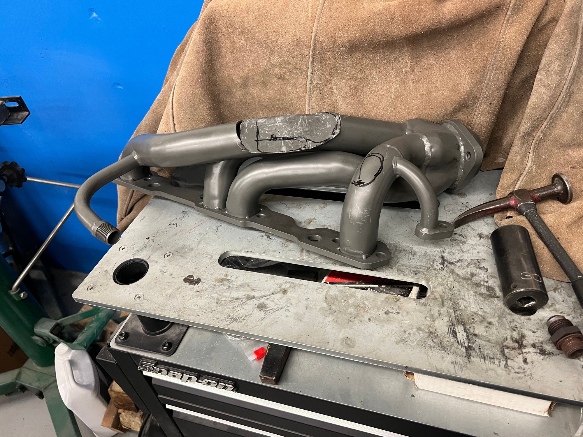

Hey Guys
Quick update.. after basically rebuilding the headers they are on the car! We also did the spark plugs, plug wires with boots, rear stainless lines, aluminum driveshaft, rear axle cover and powder coated the valve covers and strut bar. Car runs even better, I can’t wait to have it tuned so it ties everything together
