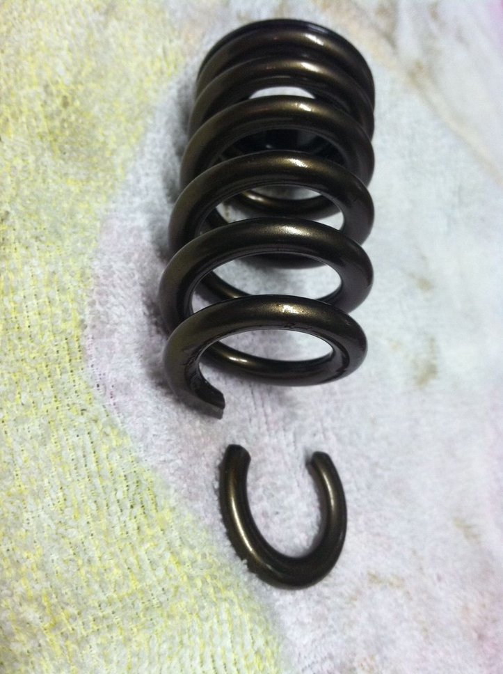

OP, in addition to post 3 (read do that), discuss with Lloyd a cam vs the XFI Comp you are considering. Regardless do not use Comp bee hive springs with the XFI, use the Lunati kit made for the LT1. Lloyd can tell you in extreme detail why not to use the Comp springs

A few years ago when I contacted Lloyd about springs as I had become a member of the 2 piece Comp 918 group. Lloyd said he would not install or sell 915's or 918's for this reason. I bought the Lunati LT1 set from him, I also run the Comp XFI grind cam
Your Comps appear to not having the issues the 26918 bee hive springs had

The Comp cam card for my XFI spec the 26918 spring, which is why I initially used them. Checked them at 5k mi, 10k mi....and at 15k mi I had the 2 piece version. They were installed at 1.800" height. Reportedly they had a "bad batch" as at the time Comp went :offshore" for them. 918 failure was considerably more common than other springs at the time. Lloyd said he would not use them as a result.
Of course any single spring failure results in immediate piston to valve issue as there is no secondary spring to hold the valve up. The Lunati kit is a dual spring. Fortunately for me damage did not occur as the retainer was still capturing the broken spring
I only rev to 6400 at the track as the cam stops making power about 500 rpm before that, The Lunati spring has been fine for years now. YMMV
