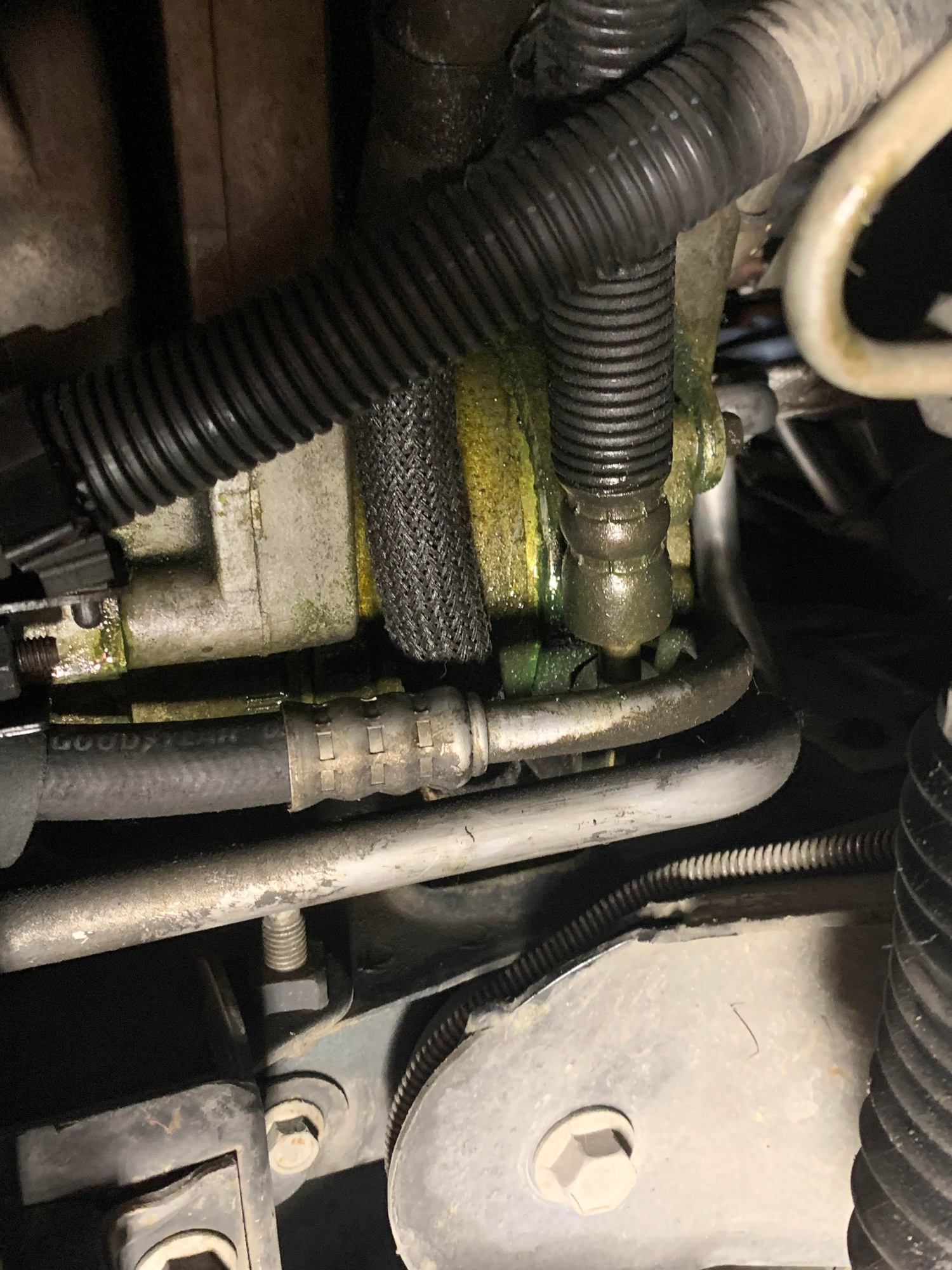

Hey all! I am a long time reader and just recently picked up a 1996 TransAm over the winter. Not sure if this was the right place to post this one. All is good (with the car) but I have noticed a micro oil leak but also a coolant leak. The coolant leak seems to have increased so I investigated. Looks like the oil drain plug may be leaking. I have noticed a radiator hose that is leaking looking from the bottom of the car. Looks like the previous owner did repair that is starting to let go. Does anyone happen to know what house this is? Having trouble searching for a replacement. Attached photos of it.

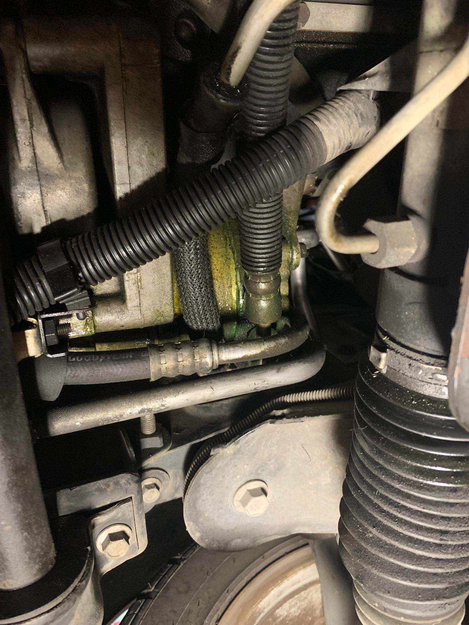

Ive done some further investigation. Still looking into the oil. But the coolant is not actually coming from that repair (surprisingly) It looks like it elsewhere. Looking at the bottom up I can see coolant than dripping from whatever that is below the water pump, then onto the cv boot then the floor. Not sure if its the water pump or what. Definitely need to clean up down there to see whats going on.

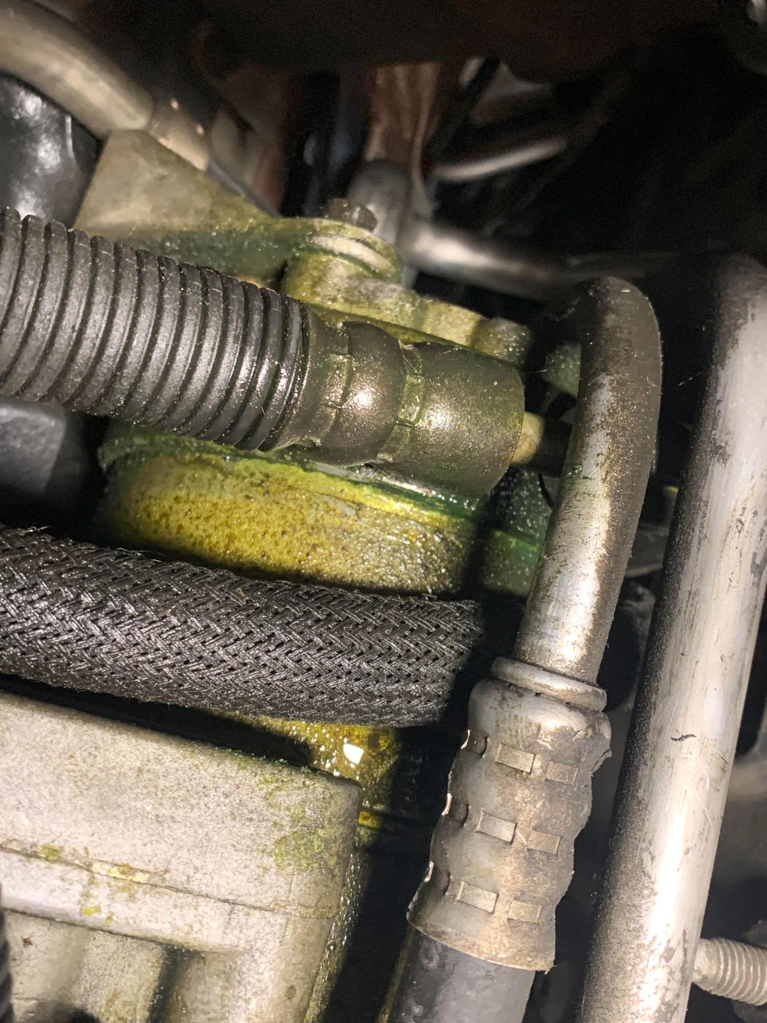

You sure that's coolant? Looks like refrigerant dye to me and it looks to be right under the A/C compressor. Unless the coolant has been changed the '96 comes with DexCool/Orange.

That's definitely refrigerant/dye.

Def dye, it's all over the compressor to boot.

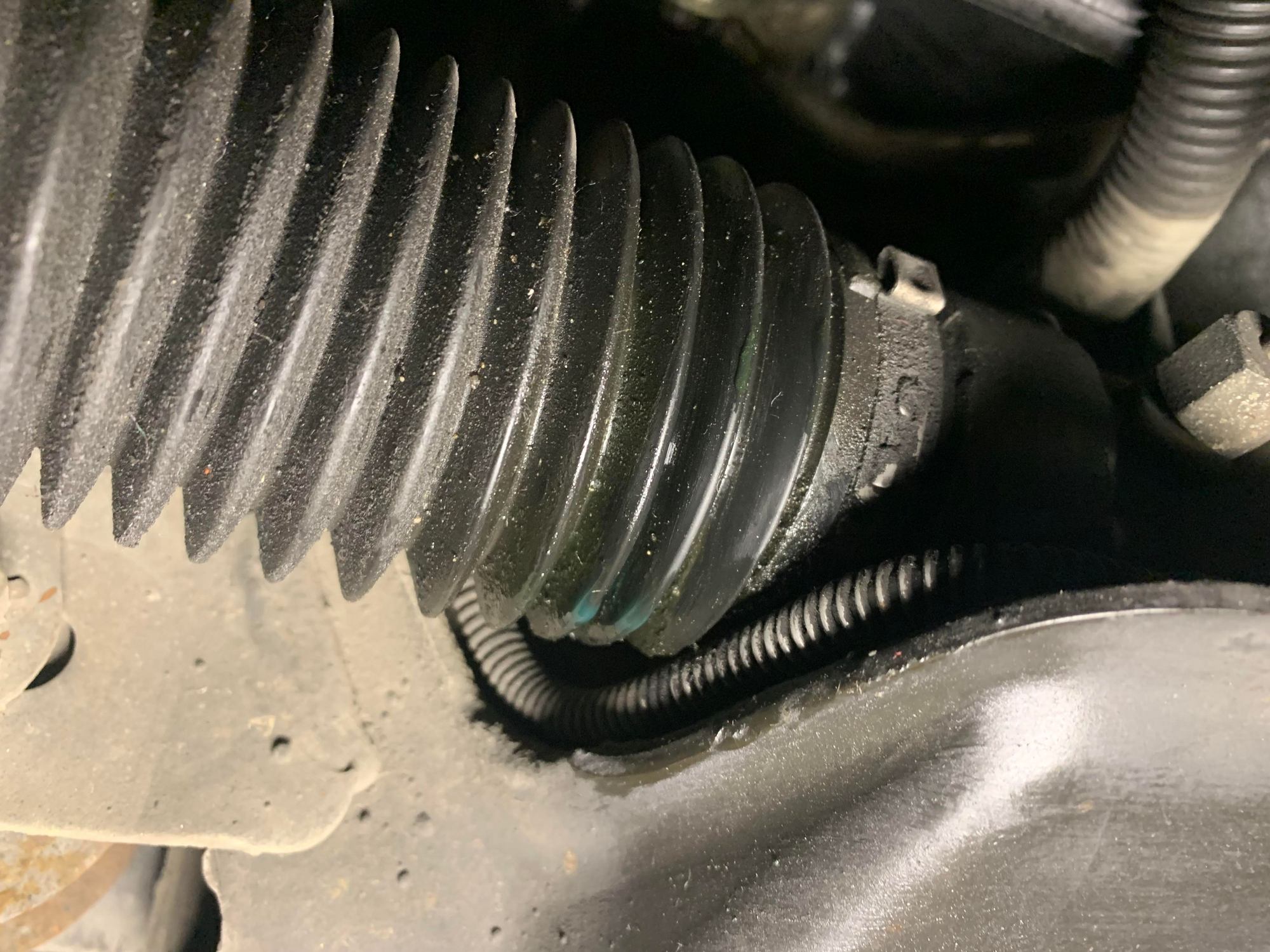

The coolant appears same colour. If it was originally Dex orange someone changed it at some point. Will take things apart to look at more tubing and the water pump. I suppose there is a possibility that someone died the system still. Maybe something is dripping at the top of the compressor just hard to see anything.
From coolant reservoir and fluid on floor

Get a black light. Wait until it's dark and shine it on that area. If it lights up like Chernobyl, then it's dye. Also, check the top of the compressor to see if it is as soaked as the bottom side.

That look like PAG 46 with UV dye that's on the AC compressor to me. If the coolant is leaking down then it's most likely coming from one the hoses on the water pump.

Got a black light. Looks like dye and maybe a leak somewhere on the compressor. No apparent coolant leaks except a micro leak at the thermostat housing, maybe the gasket. Thanks for the help all. Will need to look into changing this compressor out.

There are a series of o-rings that are on a shaft that enters into the back of the compressor. it's is held in with a snap ring and is under pressure. I'm certain that's where the leak is coming from but it could be the o-rings on the line connecting to the back of the compressor that's leaking. May not need to replace the compressor and it's just the o-rings.

My bet is it's leaking around the pulley and it will have to be replaced. I say that only to say if you are in search of one, I've had real good luck with an "AC Delco" bought off Amazon:
Amazon Amazon
Just make sure if you have to go this route you irrigate the A/C lines with a cleaner. Whatever I used was a foam and then used compressed air to blow it out. Worked very well. There is a chance the compressor is blowing junk into the lines and if you just put another one on that junk can ruin the new compressor. Not a sermon. Just a thought.
