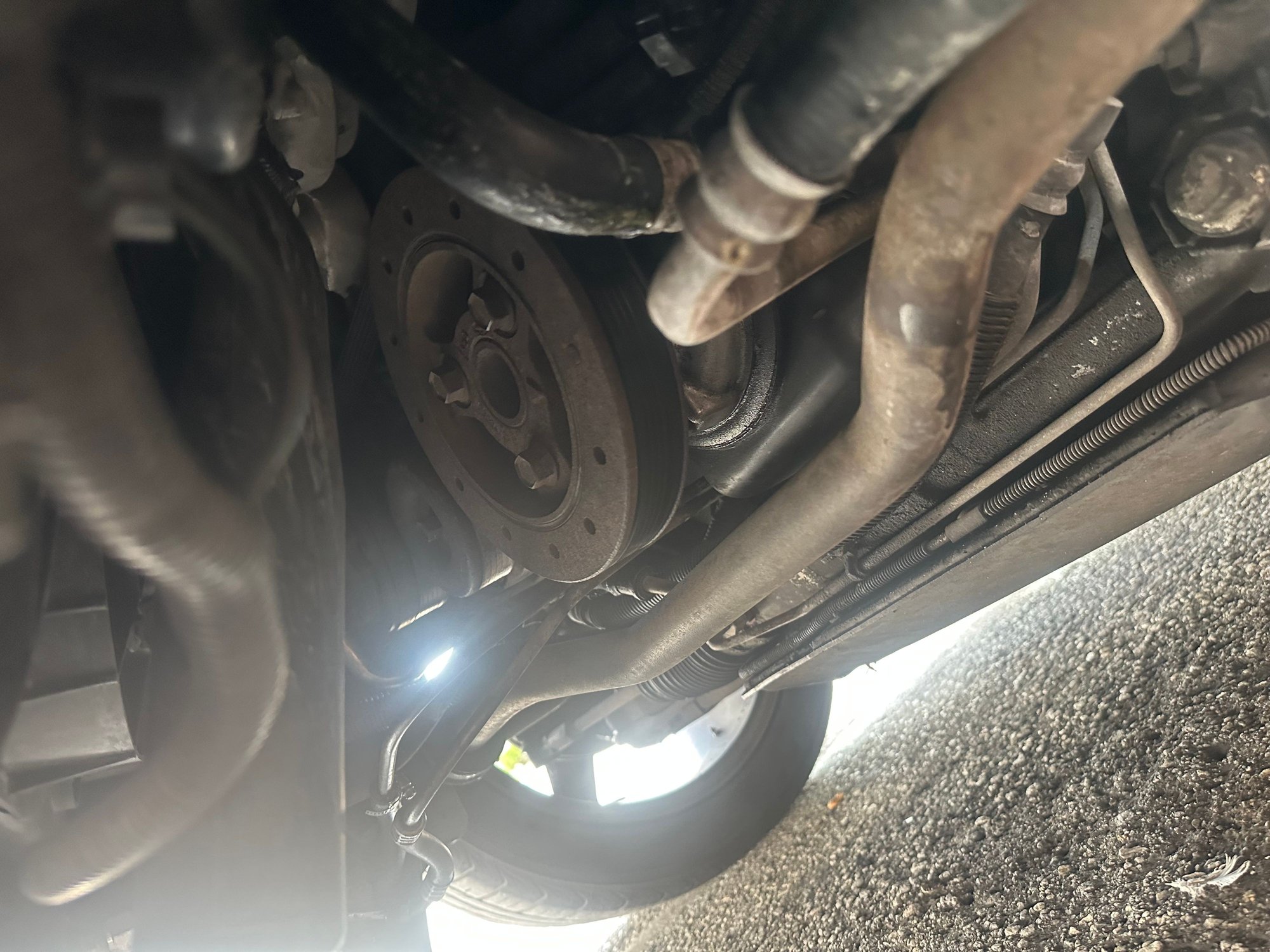

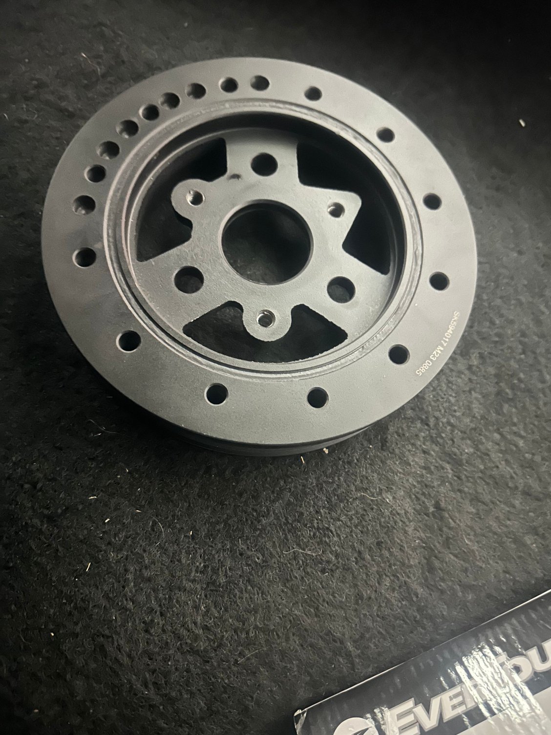

Old Jun 22, 2025 | 08:49 AM
LTX's Avatar
LTX
Joined: Sep 2011
Posts: 301
From: Miami Beach, Florida
This is the new one.
This is the old one still on the car.
As you can see the old one has a little arrow right downward. If you look at the new one, am I installing where the tip of the triangle is on the new one, the same direction as where the little triangle is on the old one?

Old Jun 24, 2025 | 09:41 AM
Summitracing's Avatar
LS1Tech Sponsor
Joined: Jan 2008
Posts: 2,233
Likes: 1,523
@LTX,
Your assumption is right. The arrow on the stock LT1 balancer and the machined triangle on the replacement both accomplish the same thing. They’re visual aids to help clock the balancer during installation. These balancers are designed to bolt to the crank hub in only one orientation, thanks to the offset 3-bolt pattern. When lined up correctly, the arrow or triangle should point toward a small rib or nub on the crank hub itself.
