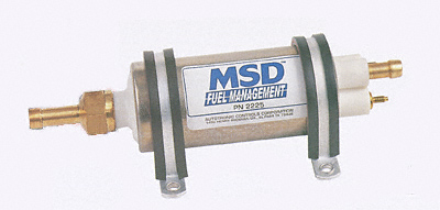

Well my fuel pump started whining more then usual... so im lik eehhh i assume its the stock pump (99,000 miles on it then) so what are my options are far as inline fuel pumps my mechanic said in the driver side fender well is where he puts them usualy

Hey if the intank pump goes, the inline one probably isn't going to do much for you I don't think, aren't they usually to boost the fuel pressure??

You can't just add an "in line" to replace a failed in tank pump. It doesn't work that way.
What he just said...an inline pump "aids" in supplying, it doesn't "do" the supplying. You have to replace the stock pump. Others have already made good suggestions here...
