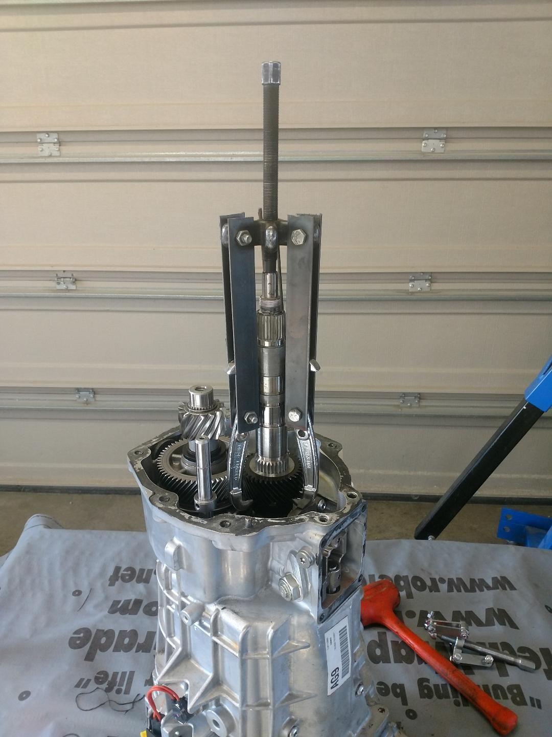

  • Be prepared to pull every splined gear and synchronizer hub! The video's I watched showed many of these gear and synchronizer hubs simply being removed by sliding them off the shaft by hand once the snap rings were removed. I did not have that experience. This transmission was BRAND NEW so tolerances were very tight. (This is a good thing as loose 5th and 6th gears on the mainshaft was a weak point of T56's.)
    • I used a 2 and 3 jaw puller that was modified with strap to give the puller arms significantly longer reach.
    • Every gear that is pulled will need to be pressed back on. My home shop has a very large arbor press but it didn't have the reach needed for any of the gears due to the length of the shaft. Also I would have been unwilling to use a hydraulic press on the gears installed after the mainshaft and countershaft are installed-you would be pressing against the small tapered end bearings with incredible force to install 5th and 6th gear. There may be a better way but I used several different lengths of 2" steel pipe fittings and all-thread in combination with large gear puller to press the gears back on.

Pic of Puller-Also used bearing splitter/gear puller where possible.
  • Press setup using 2" pipe couplings and various length fittings. Drilled hole in cap. Worked great! Finished and ready for install!
