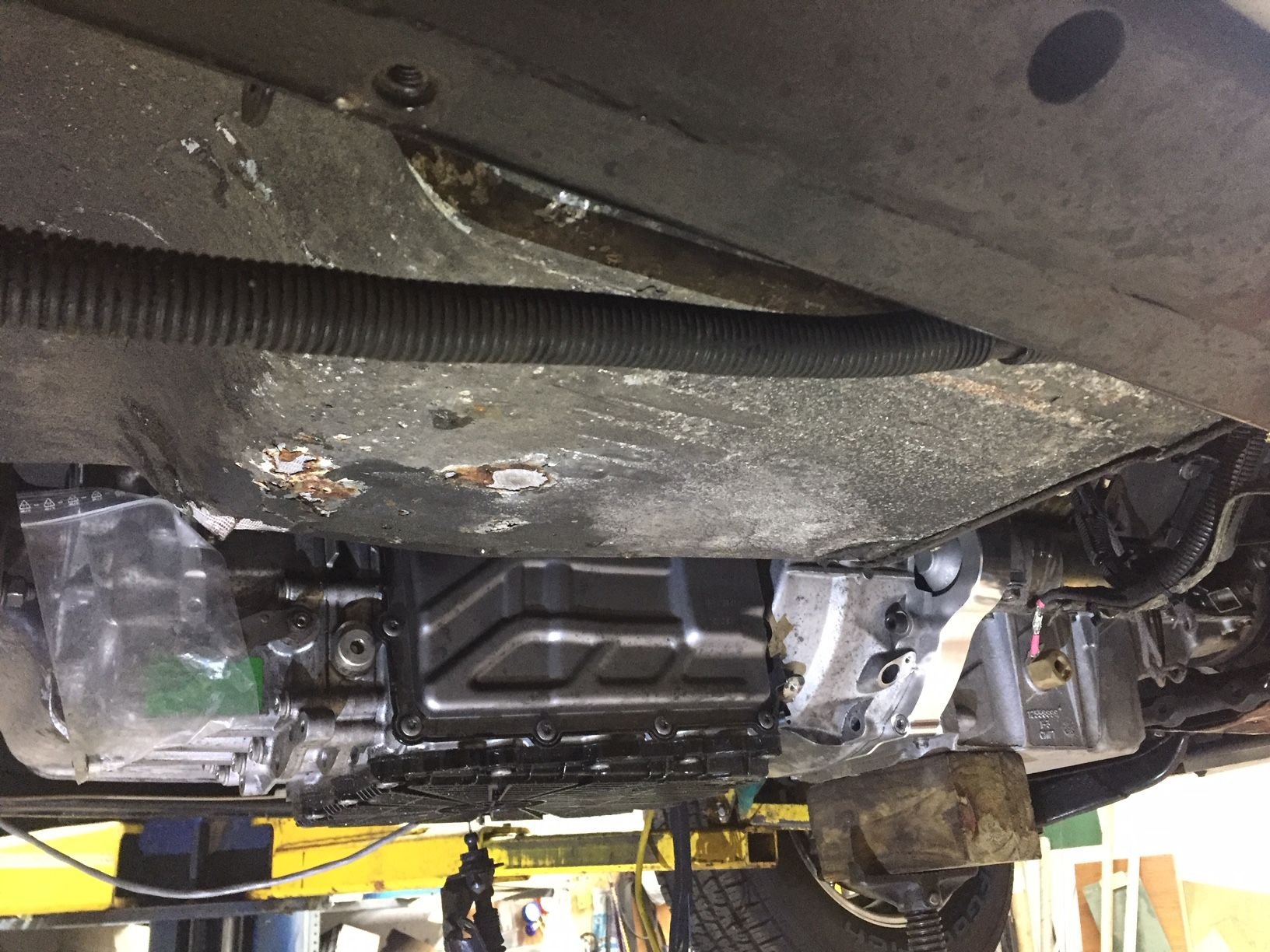

I test fit the DCT into my turbo LS powered C3 vette. I does fit with no change required to the tunnel or firewall. It's a little closer to the firewall than the 4L80e because the adapter plate comes straight back a bit, but nothing is interfering. If I keep raising the DCT until it's forced against the tunnel, the middle, center of the DCT touches first right around where the shifter cable comes through the body.
I should have measured the height of the 4L80E output shaft before I removed it. The DCT output shaft appears to be around the same height, maybe a tad lower, but not enough to create a bad pinion angle.
Now I'm going to fabricate an adapter to the rear trans support. I plan to leave the support in it's current location and build the adapter so it can support either 4L80e or the DCT.

Looks like the DCT oil pan is a fair bit lower than the engine oil pan ?
Yeah, I noticed that as well. However, I think the 4L80e oil pan was also a fair bit lower than the engine oil pan (F body pan if I remember correctly). I'll make some measurements.

Did some measurements.
Both the 4L80e and the DCT hang lower than the engine.
Turns out both the 4L80e and the DCT oil pans are tapered rather than being at right angles to the engine block. The side near the engine hangs lower on both and tapers up towards the back. The taper on the 4L80e is slightly more aggressive.. The DCT hangs about 3/8" lower at the engine side. That's tolerable.
However, the DCT hangs about 3/4 to 1 inch lower in the back than the 4L80e did. I can't raise the back any more without modifying the tunnel.
I've got decent ground clearance now with the 4L80e so an extra 3/4 to 1" wouldn't kill me, but I'm not happy about it, especially with a plastic oil pan.
Curious how much ground clearance there is in a BMW. Tomorrow I'll drop the Vette back on the ground, with the DCT still up there, and measure the ground clearance.

The back end of the pan is almost flat, so not much gain from a low profile one in my case.
I dropped the car on the ground and jiggled the suspension. The front of the oil pan can fit a 2x4 under it. The back is about 3/8 too low to fit it. Overall, I'd say the back is about an inch and 1/2 too low. If I raise the back (will need some major tunnel work) the clearance will be good front and back.

The tunnel work to make the DCT fit in the Turbo Vette is not something I'm looking forward to. It's not a question of having a lower profile pan, it's the top of the trans that is interfering with the vettes tunnel. Also, I've really been enjoying the 4L80E and the controller I designed for it at this time in the vette. So I've decided to put the DCT into one of my BMW E30s along with another LS engine.
