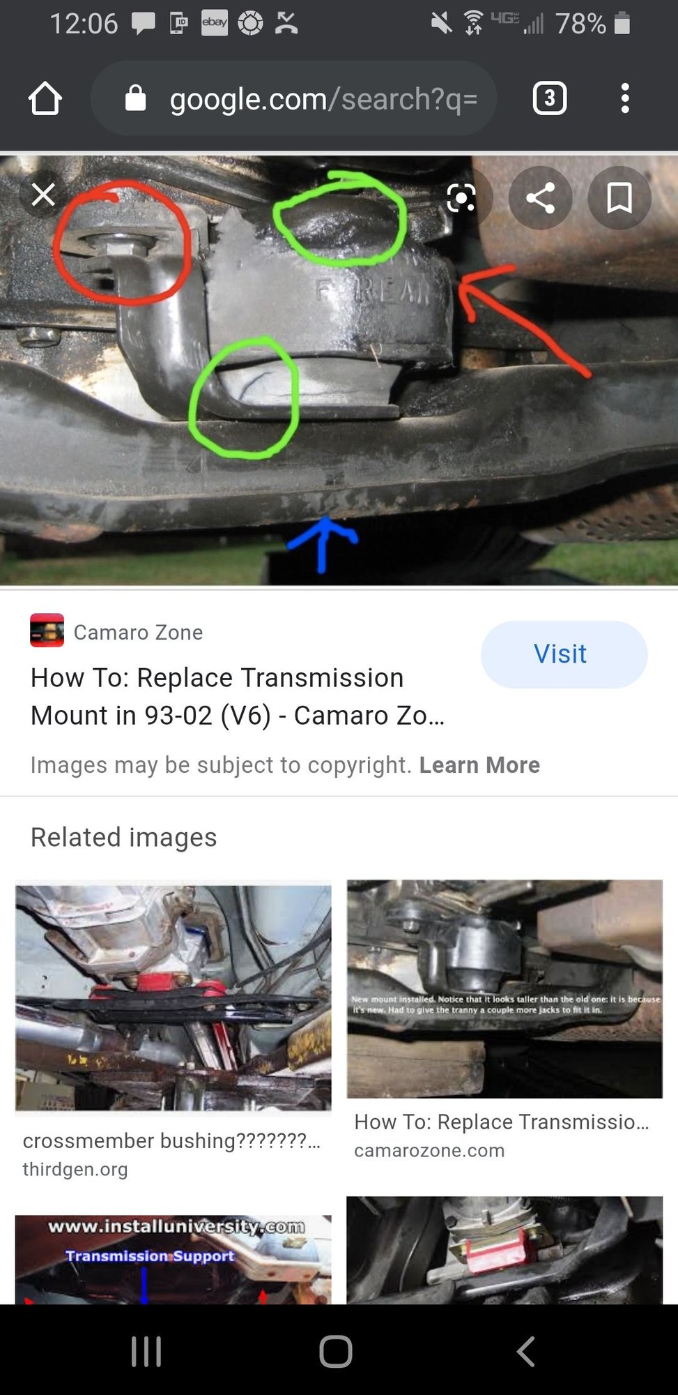

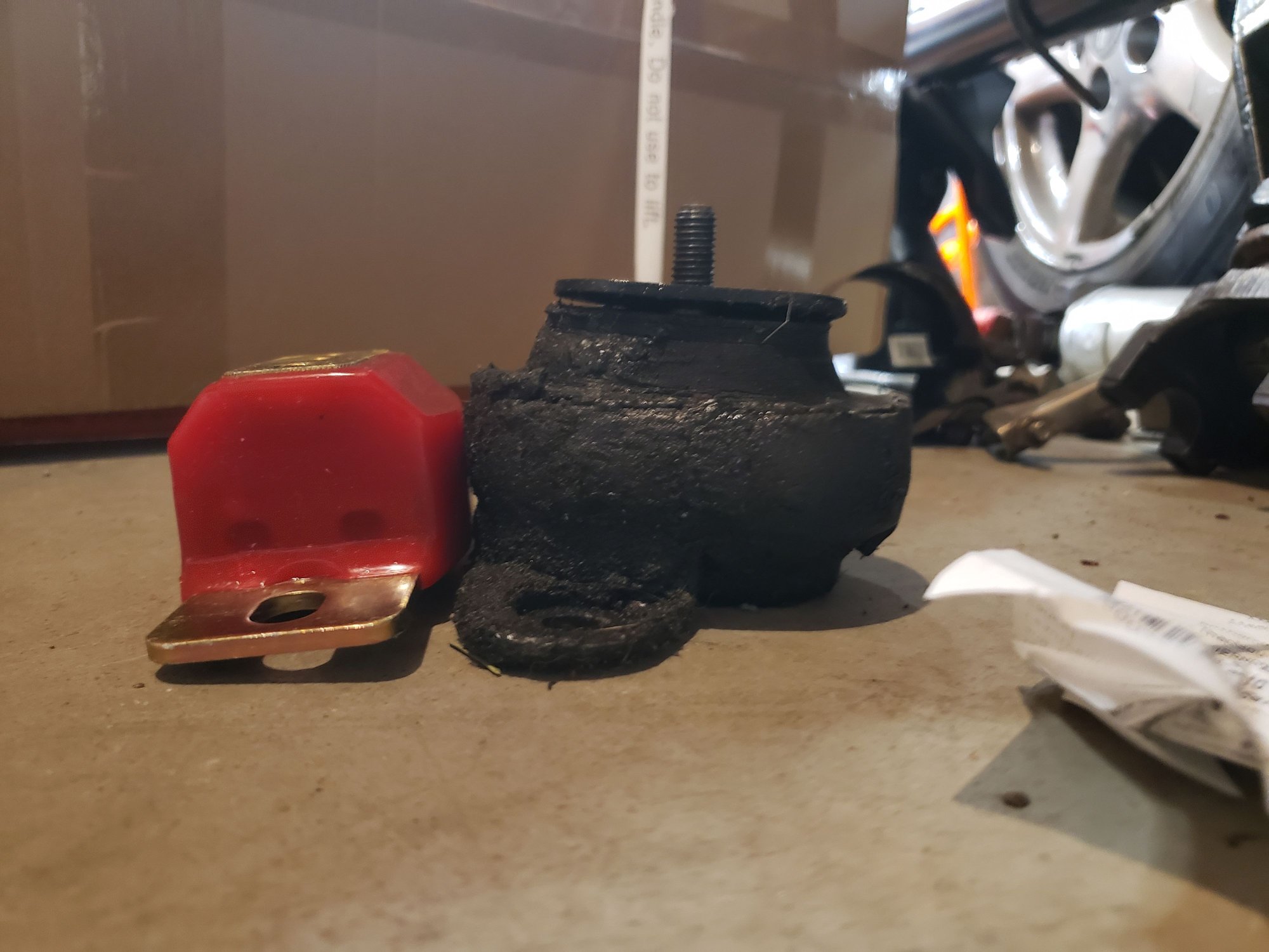

So i swapped from auto to manual years ago and I had bought the correct mount (rectangular one) and when I put it in and drove it the shifter just bounced up and down, so I took the trans mount from the doner car to try it (roundish one). And it seemed to work great and never had an issue...
Well fast forward to now I got the car all apart and the rubber trans mount I had on it just looks like it needs replacing (cracked rubber) so i was looking and it seems the style i have been using is for the 6cyl cars? Can someone elaborate? Also is the v6 and v8 trans crossmember the same? I did a search but couldnt find anything...it seems like I have the v6 crossmember too?

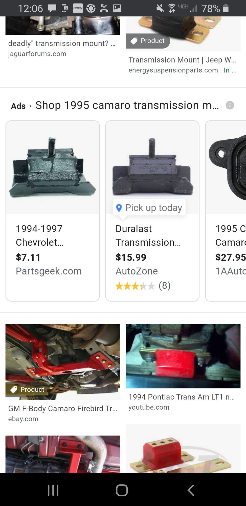

This is the one i have
This is the style that seems to come up for v8 cars

The mount on the bottom is the one you should get. It has bolt holes instead of a stud like the factory piece. Make sure you leave off the spacer supplied with the new mount as it may cause driveline vibration. I put an Energy suspension poly trans mount in my car back in 2003......it's still in there today.
