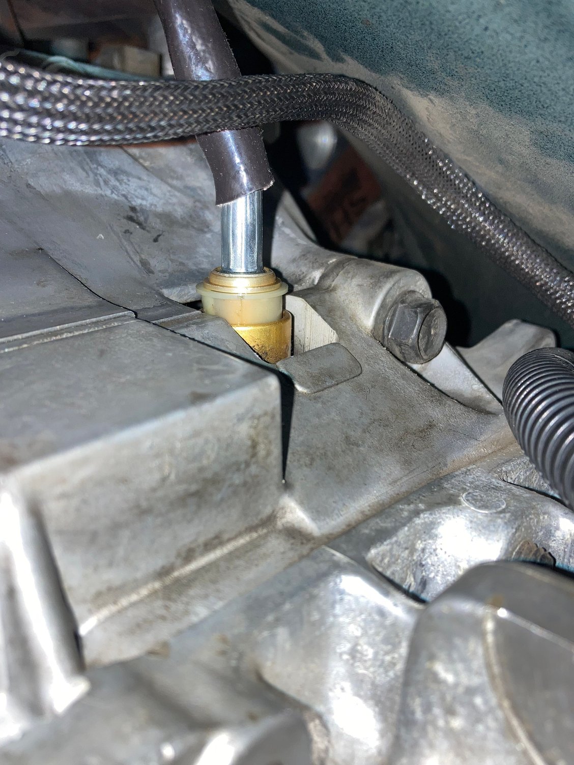

I am installing a new Tick clutch master cylinder. Car has the original OEM slave and clutch.
When I reconnected the MC hydraulic line back into the slave there was not a distinct "click" and it looks to me like it may not be in all the way?
I cannot push the connector in further, and it feels pretty snug when tug on it. There also appears to be some fluid between the metal fitting and the white plastic clip, but no dripping.
I have NOT turned on the car yet and the pedal is firm when I push lightly on it by hand, same as when I finished bench bleeding in car.
Before I take the next steps, does the plastic clip look like it's in all the way? If not, how do I get this to connect fully? Is there supposed to be a "click"?

It looks pretty good. The click is slight. With a removal tool, you should be able to gently pop it off and put it back on again and go slow to feel the fingers grab. This shows a similar view as you have: https://www.motortrend.com/how-to/13...clutch-master/

Thanks. I disconnected and reconnected the line (Lisle 37000 A/C line disconnect tool set) and better this time. Although it is inserted to about the same depth, there was a definitely a "subtle click" and this time there is no brake fluid under the white plastic clip.
The concern now is that the pedal only moves an inch or so with reasonable force (car still turned off). I am afraid to push too hard and damage the MC seals. When the hydraulic line was disconnected, the pedal would barely move (i.e. line closed and properly bled).
I am wondering what could be preventing the pedal from freely moving? I didn't think it was like brakes, where the pedal loosens when the car is turned on and gets some boost.

Its not boosted, so the pedal is independent of the car being on. Did you change anything on the transmission or did you just swap the M/C? If the later, maybe there is something binding on the physical pedal? Did you remove the clutch pedal return spring per the Tick instructions? (A lot of times during stock driving, that spring breaks and leaves some metal crap hanging around.)

Update: I let the car sit for a week, checked the pedal, and apparently the quick connect "seated" itself and there fluid flow. Didn't even need to bleed the slave to get great pedal feel.
The car still won't go into gear after it gets warmed up, even after adjusting the pedal to several different heights, but the pedal no longer sticks half way up
Trying to figure out next steps...
Before the hydraulic related symptoms, the clutch felt very solid. And from what I am reading, the slave doesn't sound like a common issue.

Ya, the shifting problem started before I parked the car (i.e.was the reason I parked it). And here in AZ, in a garage, there is basically no humidity to cause rusting/sticking.
No slave cylinder mess on the bell housing. And there has been no loss of fluid in the reservoir.
So this weekend, after input from Tick, I tried a MityVac bleed at the reservoir:
The results were surprising. Upon pulling 10-in Hg, there was a continuous stream of large bubbles regularly spaced at about 2" apart in the clear tubing coming out of the reservoir. This continued until the gauge dropped to 4.5-in and the bubbles stopped. I held this this vacuum for about 30min and no more bubbles....until I pumped it up to 10-in again and the large repeating bubbles returned.
I did this several times and ended on a 4.5-in vacuum with no bubbles. But if I had pulled 10-in again, there would have been more bubbles.
And one interesting thing was that the MityVac catch can captured about 1 oz of fluid, most of which was new clean fluid, but some of the old residual fluid from the slave also made it's way up into the catch can.
Then I did the same shift test as before: Car in the air, engine on, depress clutch pedal, engage the gears...and it was good for a few cycles through all the gears (including R)!! But after 3 cycles it would no longer engage any gear.
Seems like air must be getting into the system. So I checked under the MC and under the car and at the hose quick connector and everything is dry.
Still confused. Was really hoping the new Tick MC would solve the problem since my symptoms are text book. Pressure plate appears to be a potential.
The worst part is that my driveway is narrow and steep, so getting the car onto a tow truck could be tricky....if it it gets to that.
Yes, there is a BIG difference between 4 and 10. At 10 in., you are pulling air in through the M/C seals - the vacuum is too aggressive. 3-4 in is just about right and will get the trapped air out. Once the air stops at 4 in, you can rest easy that the job is done.

EDIT: the MityVac + testing with the car on the ground (not on lift) seems to have been the trick. For the moment, upon a quick test, the car now shifts into gear and I did the Tick "rev test" and no bucking. Will adjust the clutch and do some tests in my driveway before venturing out of it.
OK, good to know about the 4" vs. 10". I saw a lot of folks mentioning 11 to 12" as the upper bound, so I thought 10" would be safe. Oops.
You have been very helpful and I really appreciate the input.
Tomorrow I am going to test it with the car on the ground based on Tick's suggestion. They said having no resistance at the wheels can skew the results. I am slightly hopeful since the last test (post MityVac) was an improvement (since it did go into all the gears for a bit). I am thinking that maybe only the right wheel (the one I couldn't see) was rotating during the test causing it to not go into gear.
