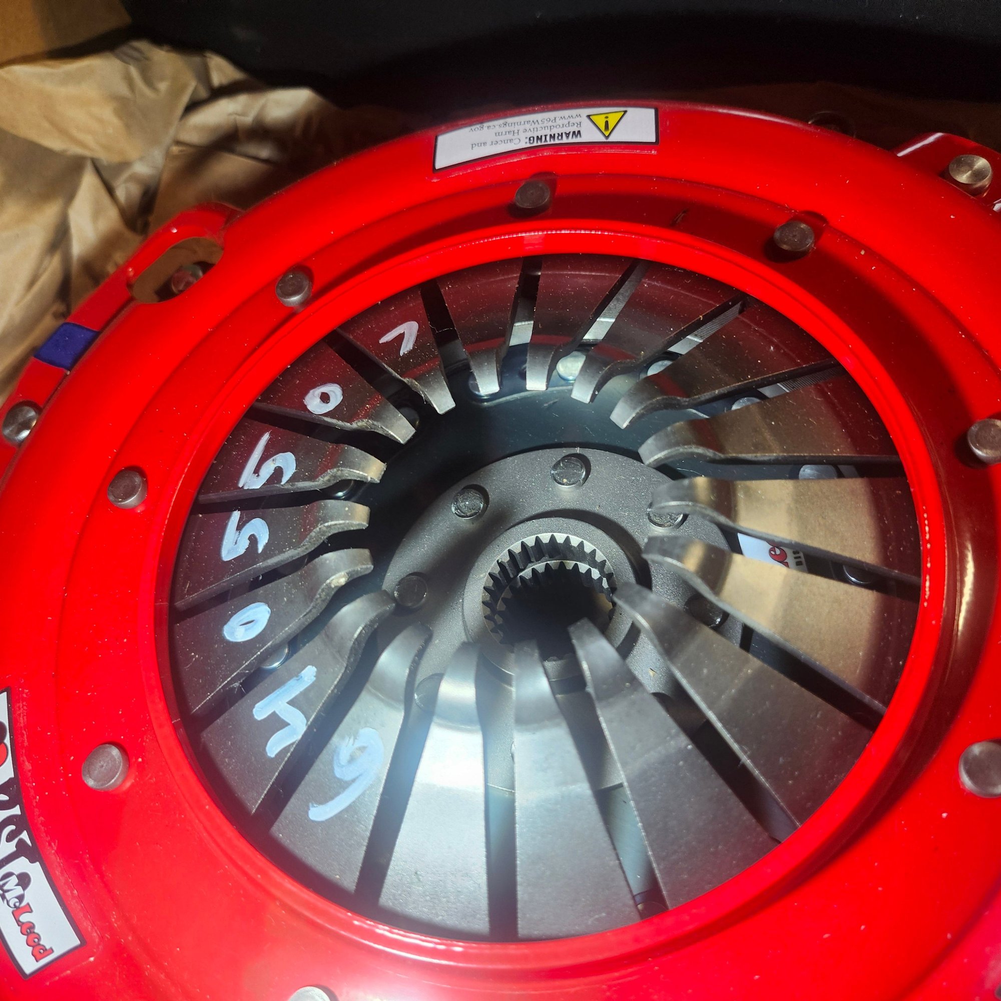

By All means stay as far away from McLeod twin disk clutches if you have a T56… there have been plenty of threads about their clutches destroying input shafts due to their poor, flawed design of the clutch hubs and excessive tolerances on the splines.
My opinion is that the ones who recommended these clutches simply don’t put many miles on their cars. Their clutches hold power just as well as the other twin disks out there. But they won’t last due to their poor major design flaw and you will likely complain about the chatter the entire time, until it fails after a few thousand miles.

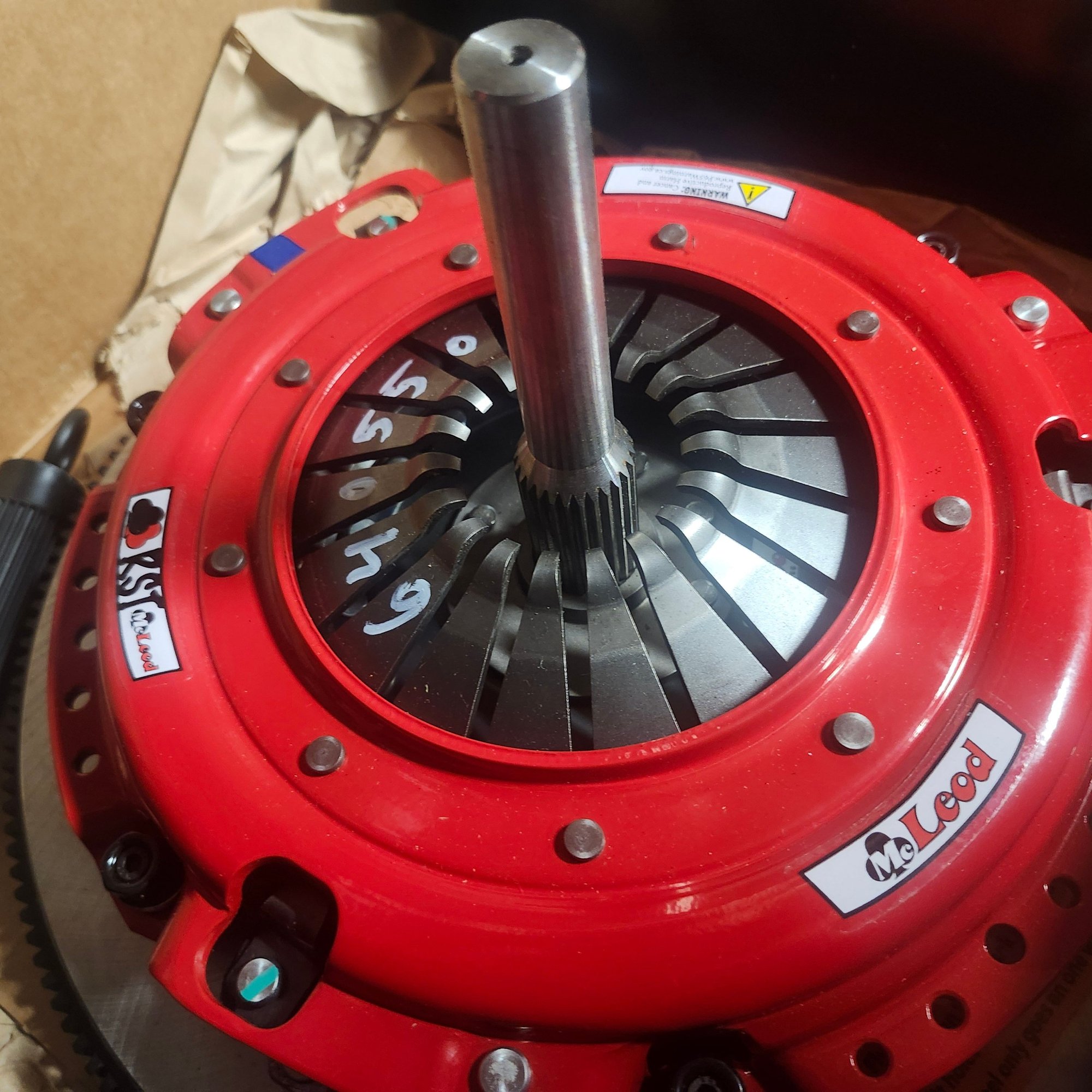

After reading your post I looked closely at the splines on the disc hubs and fitted a quality spline alignment tool that I have used for previous clutch installs.
The spline fit into the disc hub nicely with a minimal amount of play, and definitely nothing I would consider to be abnormal.
So please clarify what it was about the hub spline did you feel was not up to spec?
too loose? , not enough cross section engagement with input shaft? or other?? I also wonder how much power at the crank these cars are making that have input shaft damage.

FYI...Since my last post I did some research and found several negative reviews on RST & RXT as you described. (wish I saw this sooner)
I also contacted Summit about a return and exchange on the RST for the Tilton ST246. I also I emailed Tilton Engineering tech support and got this answer:
Clutch is balanced during assembly and tested flywheel is balanced to Tilton tolerance (measured in grams) Flywheel weight 19.6 lbs, total clutch and flywheel 46 lbs, disc spline hubs lengths are .600 and .650". They responded really fast. Chock one up for a company that provides awesome tech support!
I feel confident in this being a superior product.and will do a return on the RST in exchange for Tilton ST246
