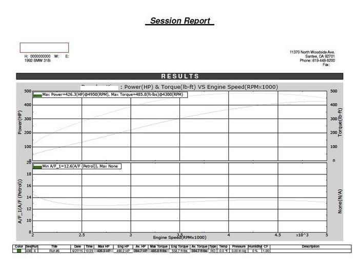

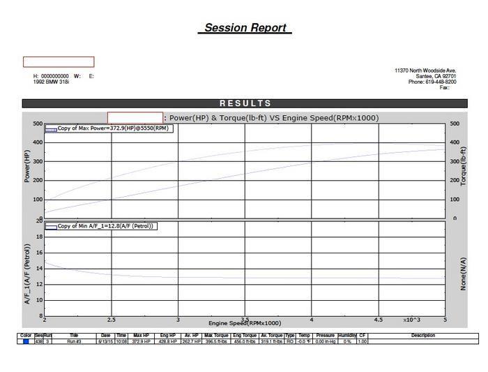

Hey Guys got a little issue going on with my nitrous set up.
Car 92 BMW 02 Lq4, cam, T56, ACT clutch/flywheel new, LS6 intake with Nitrous outlet money maker, jets 52F 23N. -4 bottle to nitrous solenoid , 3/8 or 5/16 (cant remember) hardline to solenoid. -3 solenoids to jets. Walbro 255. Nos brand powershot noids. System is triggerd via WOT switch and window Switch. Timing is pulled (I believe 1-3 degrees at most) via IAT resistor.
The jets im using should be good for a conservative 100 wheel. On the dyno Im only getting about 50 (see graphs below) with an elevated AFR.
With the Walbro 255 I should have plenty of fuel, I thought maybe I was dropping fuel pressure but on N2O AFR's stay consistent.
The issue is the AFR's are high and its way down on power
Not really sure whats going on, Ive been troubleshooting for a few weeks now. Any Help would be awesome.
NA pull
N2O pull

Originally Posted by Hardcoresoldier
how is your fuel pressure? is it staying consistent?
I have no real way of knowing except by looking at the AFR on the dyno which looks like it stays pretty consistent.
The fuel solenoid feed comes directly off the hard line from the pump before the filter/regulator that supplies engine.

Originally Posted by AJatNitrousOutlet
You may be really undertimed, but it's hard to tell without knowing what your timing is actually at. Also, you may check into some different solenoids. Those are extremely small and are only designed to give a 125 shot-
Thanks for the input, I am in the process of trying to track down my base timing. However my gut tells that since its making decent power 372whp with a very mild cam that timing shouldn't be THAT far off, but honestly who knows.
As far as the solenoids Holley has them rated at 175hp at max flow. https://www.holley.com/products/nitr...parts/18020NOS
Even if they were only designed for a 125 shot im not getting even close to that.
