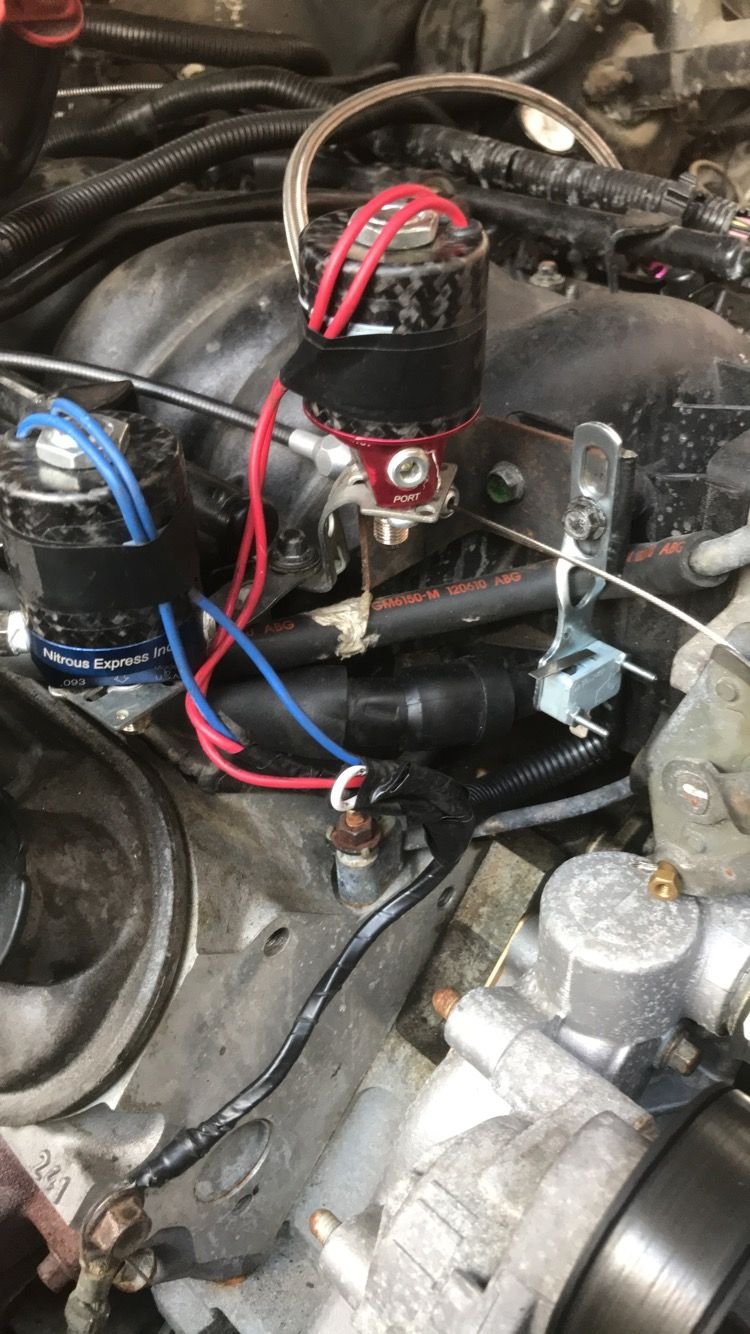

How does this wiring look? Have both solenoids together on power and ground, grounded to cylinder head and power into one side of the WOT switch, still need to run power from the WOT switch to? I was thinking to the alternator so it always sees max voltage and only on when it’s running
Old Oct 16, 2019 | 09:31 AM
02EBC5Z06's Avatar
Joined: Sep 2017
Posts: 758
Likes: 437
From: Massillon, OH
Well, unless you plan on spraying the car every time you go WOT, you will want the WOT switch to be interrupted by an arming switch so you can run it wide open on motor as well.
Old Oct 17, 2019 | 08:26 AM
1988montecarloss's Avatar
Joined: Nov 2011
Posts: 972
Likes: 139
From: maine
I have a momentary switch on the steering wheel, forgot to write that haha

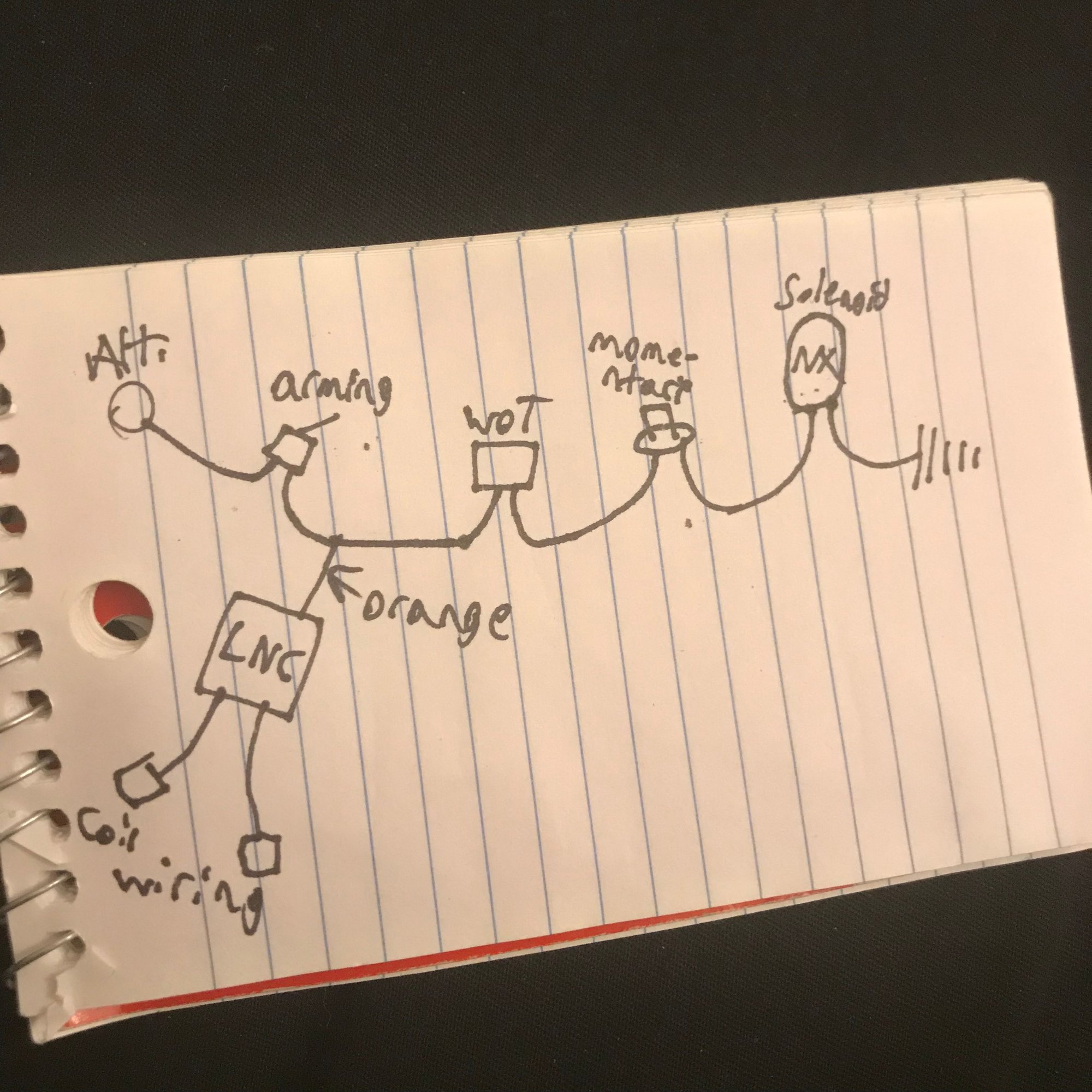

Old Oct 18, 2019 | 05:06 PM
Joined: Nov 2011
Posts: 972
Likes: 139
From: maine
This wiring setup look okay? Running an LNC-002 to pull timing for the nitrous, can I power everything off the small stud on the back of the alternator? Also running a 20amp inline fuse
Old Oct 25, 2019 | 05:52 AM
2002kirk's Avatar
Joined: Aug 2011
Posts: 97
From: Ypsilanti, Michigan
definitely mount the nozzle after the MAF. If you hit the MAF with it, it will skew the MAFs readings/possibly damage it.
