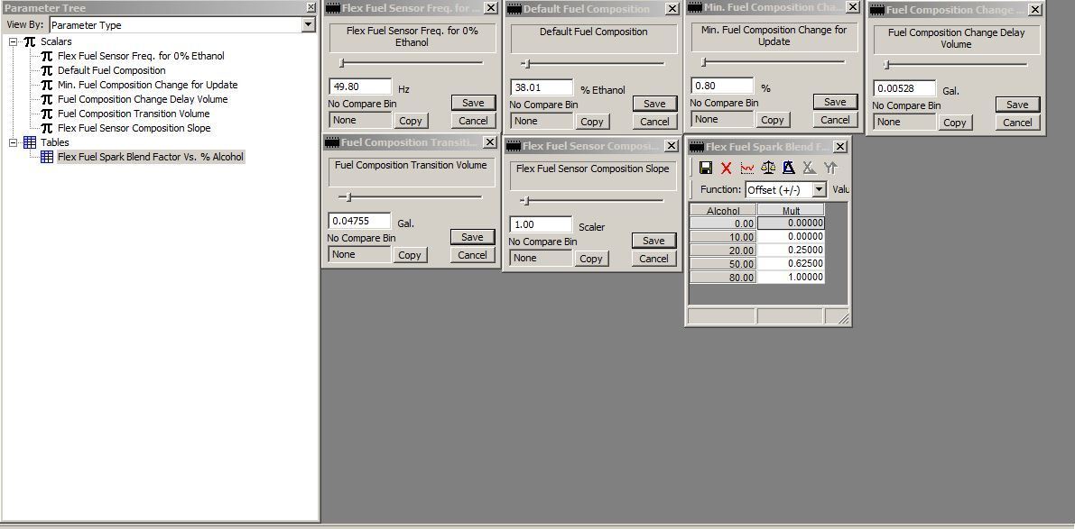

I dont use hptuners but get alot of people asking me to enable the FF for them using Tunercat which is the only tuning suite that i know of that will enable on a non factory P59 FF calibration. Here is a xdf i made for the hptuner guys with Tunerpro. Each different OS needs a xdf specific for that OS and you would need the user defined parameters enabled on you hptuners. See below for the table values that need to be input. Hptuners should have the rest of the spark tables to change

For those of you still fighting for the right OS that will do flex fueling and has 3 bar OS's available, Chris has two bin files in that .zip
One is for the common 7603 express van OS, the other is a less well known 7604 OS which is the only OS that also features lean cruise.
You must have a way to open bins and convert to your flavor tuning file,
Or you can have pick of the ones presented as .hpt files below. The first is still a NA tune, MAF on etc. The second is a 3 bar OS, which just happened to make 1074hp at the wheels with a 6.0 80e bosch 210's and a china billet s480
