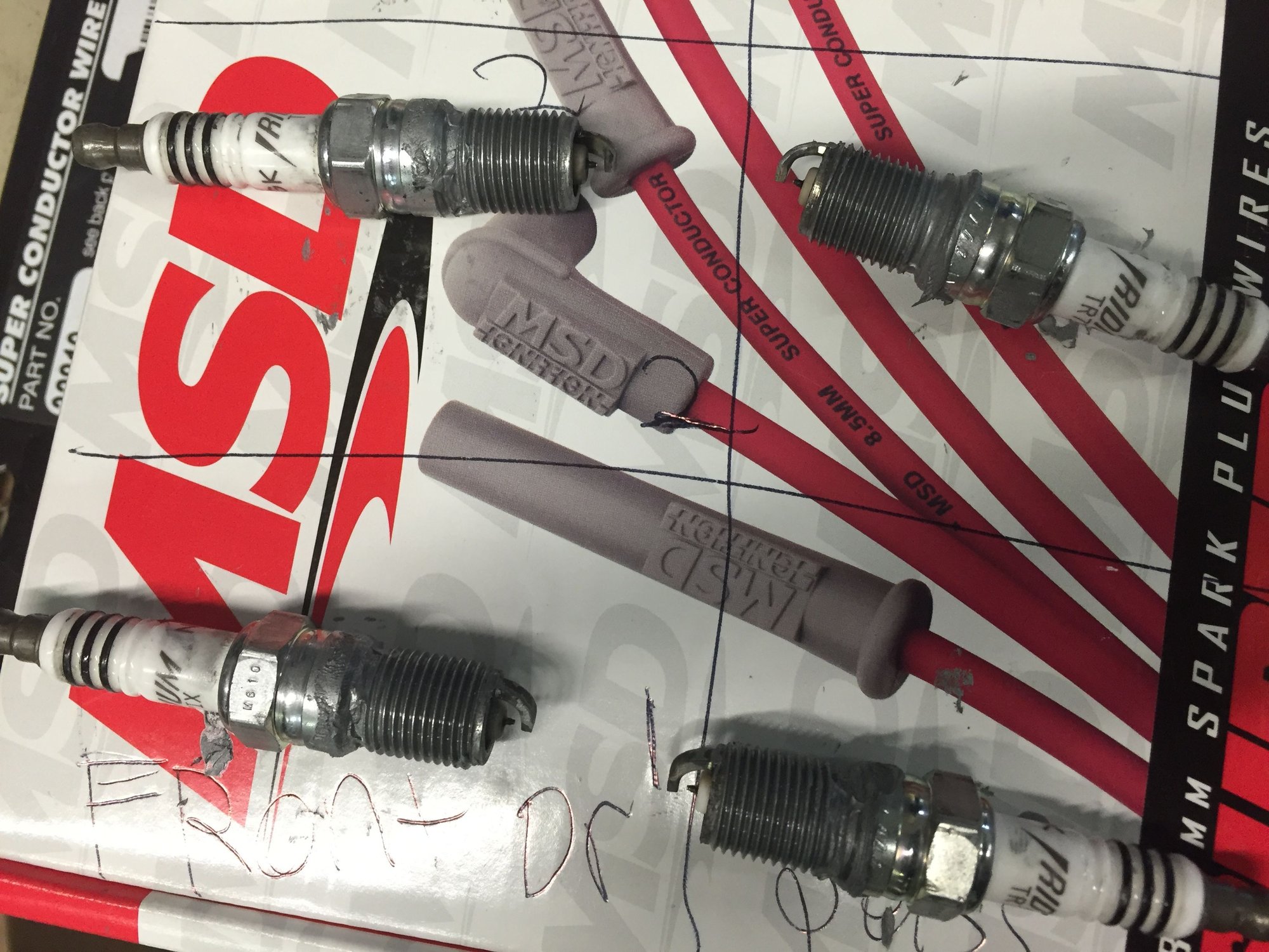

I have a 01 camaro with an lm7 engine, Texas speed heads, ljms cam, 80lb injectors Lonnies double pump kit, tr7ix plugs, msd wires, and a Huron speed turbo kit. I took the car to get tuned after I installed the turbo kit, new cam and injectors and it was having issues he said to check compression. So I did a compression check and everything is within a good % of one another, fuel pressure reads fine. I pulled the valve covers and everything looked fine under their. When I pulled the plugs #7 was much darker than the the rest of the plugs and the car only really runs rough at about 1800-3000 rpm. Are there any other tests or anything else I should check for? Maybe should I have another tuner check it out?

I swapped the #7 injector with #2 ran it and checked the plugs the #2 plug never got any darker than it was. Also swapped around plug #7 and #3, the plug cleaned up immediately in #3. Cylinder 7 plug didn't get much darker than it already was either, I might need to run it longer though.

I had a friend once who put way to much antiseize on his plugs and it ran terrible. Cleaned them off and it was good. To much on the threads and you lose the ground for the plug.

I got some tr6's and threw them in and it seems to be running a lot better it's still a little choppy under acceleration, but it is noticeably better. The car isn't completely tuned though, so now I'm not sure if it's tune or the car. I didn't put any anti seize on the plugs should I pull them back out and give them a small amount?
