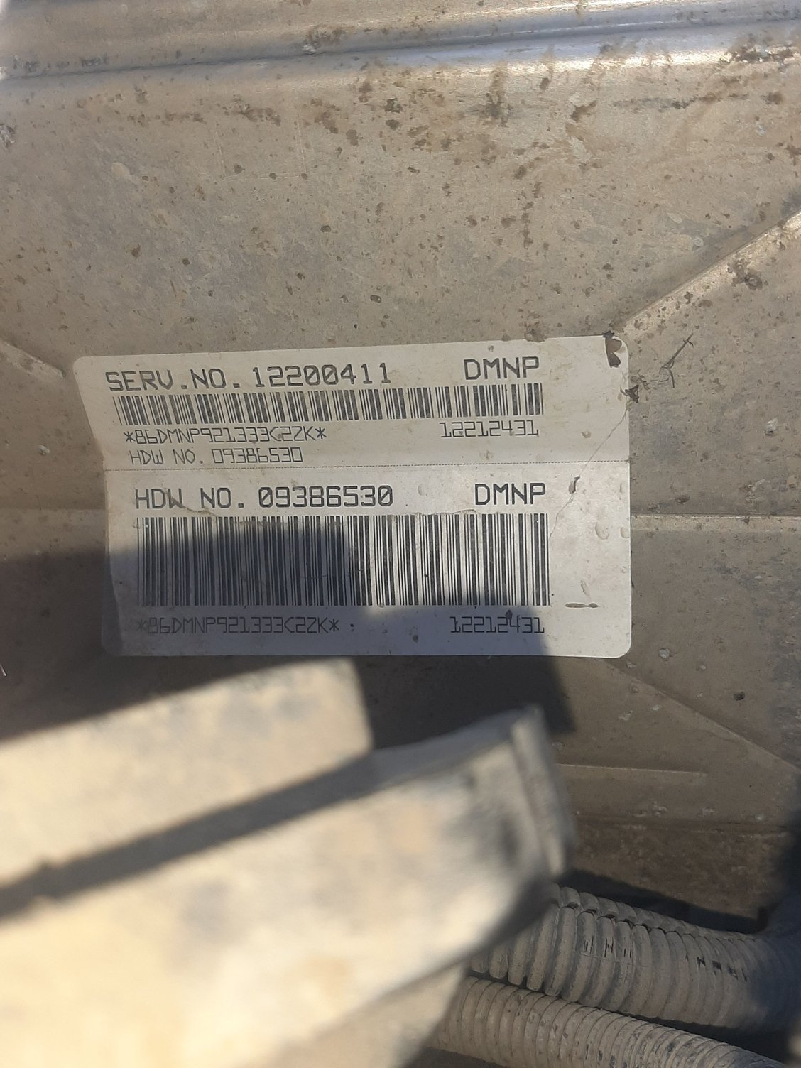

Ok, NSFW, I got my cable today and read my OSID..
It's OSID is: 12212156
Cal ID: 12212431
HW ID: 9386530

There are 2 very good XDF's for that OS, it's actually the most ideal OS for working with as every possible engine size, transmission type and vehicle platform are support for it.... including the SBC Vortec 5.0/5.7 when used with the proper engine segment.

IDing the PCM is simple if you have the sticker still attached
As for the OS, you'll learn that when you first read the PCM..
