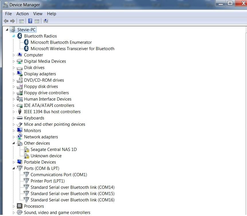

Being the fool I am...I bought the OBDLink MX+ ( arrived quickly too )
I have bluetooth etc, and I appear to be connected to the device ok....even though it was a bit of a pain with drivers. But now when I open PCM Hammer, it just seems to sit there frozen ? no menu options available.
I dont believe I have any conflicts to prevent it working, albeit with 3 COM's assigned.

I think you need to update drivers or software, I think the yellow ! is saying there is an issue. I also had a hard time with the drivers, if you buy a new device and download the software, you should get the drivers for it, just saying.

The yellows are not relating to the new MX+ device.
One has been on the PC for years, the other my NAS drive even though it works perfectly.
Maybe the ecu I have sitting here is dead in some respects ? as it was bought with some other stuff, so is an unknown. And I find it very odd that even though the OBD software appears to connect to the ecu ok, there are no fault codes.....which there should be loads for an unplugged ecu.

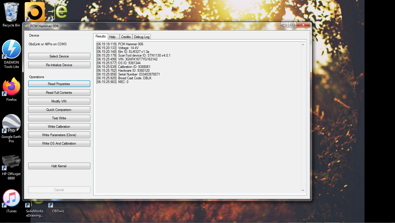

From: Norn Iron
via laptop

Hi all.
App is definitely hanging up trying to initialize the Bluetooth Com Port.
Try removing the Bluetooth dongle from the PC (or otherwise disabling it), Restart PCM Hammer and try selecting a DIFFERENT Com Port.
Then Re-enable Bluetooth device and try App again.
You basically want to get PCMHammer to re-initialize the Com Port settings!
Mike
PS PCMHammer SHOULD at least get to the point of selecting a device EVEN without ANY Bluetooth or USB devices present.

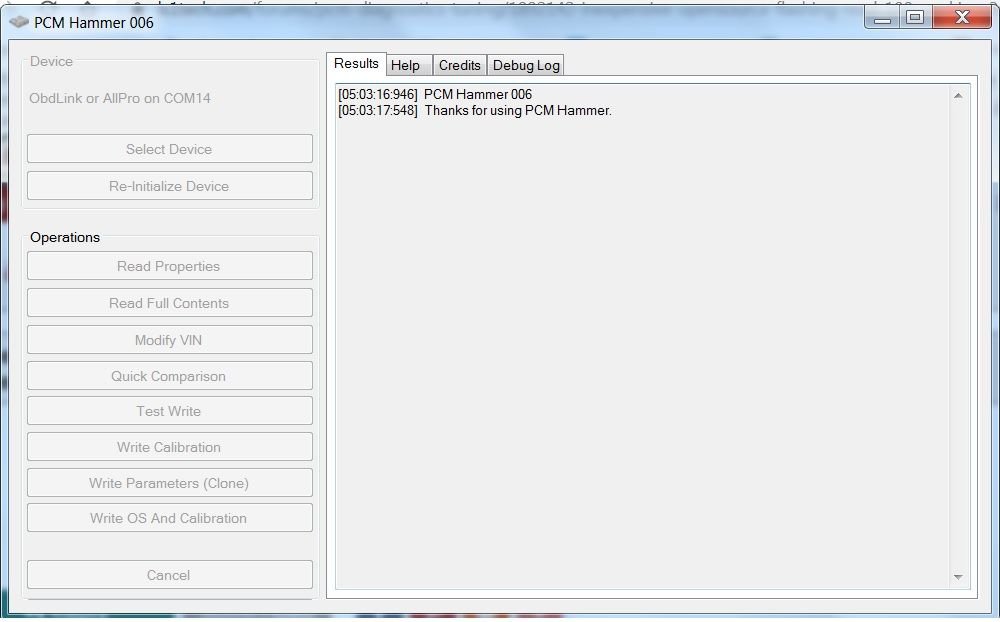

Well, I tried doing my 1st read, and I get this.....
Not sure what to do.
Thanks.
Thanks.
I would say that there is definitely a communication error.. But voltage of 16.3?!? Little high don't you think?? lol

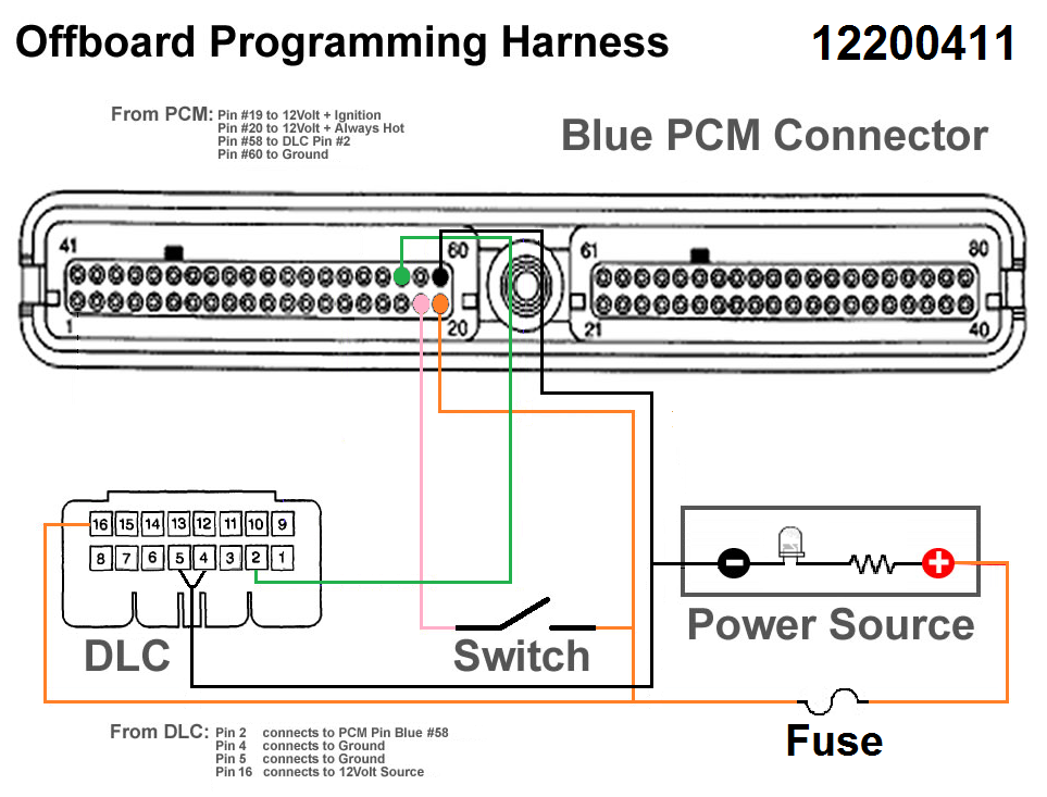

Dave V, on your OBDII, what pin out do have? I think I found my issue, the obd plug I got from a Silverado is different then what I found to use, and then the instructions is different then the diagram, so, pin 4 and 5 are grounds, what pin number is for data, and what pin is power?
And what pin are you using to ground the pcm, I have pin 1.
Thanks.

Hi all,
Here are the Pinouts for a Bench Harness for the '0411

I'm not using a bench harness.. I have the full parts truck (2002 GMC Sierra) and did it in vehicle
I would use the diagram that MudDuck514 posted..

Likes: 28
Got it!!! My pcm doesn't have a pin for #1 pin.
Thanks.

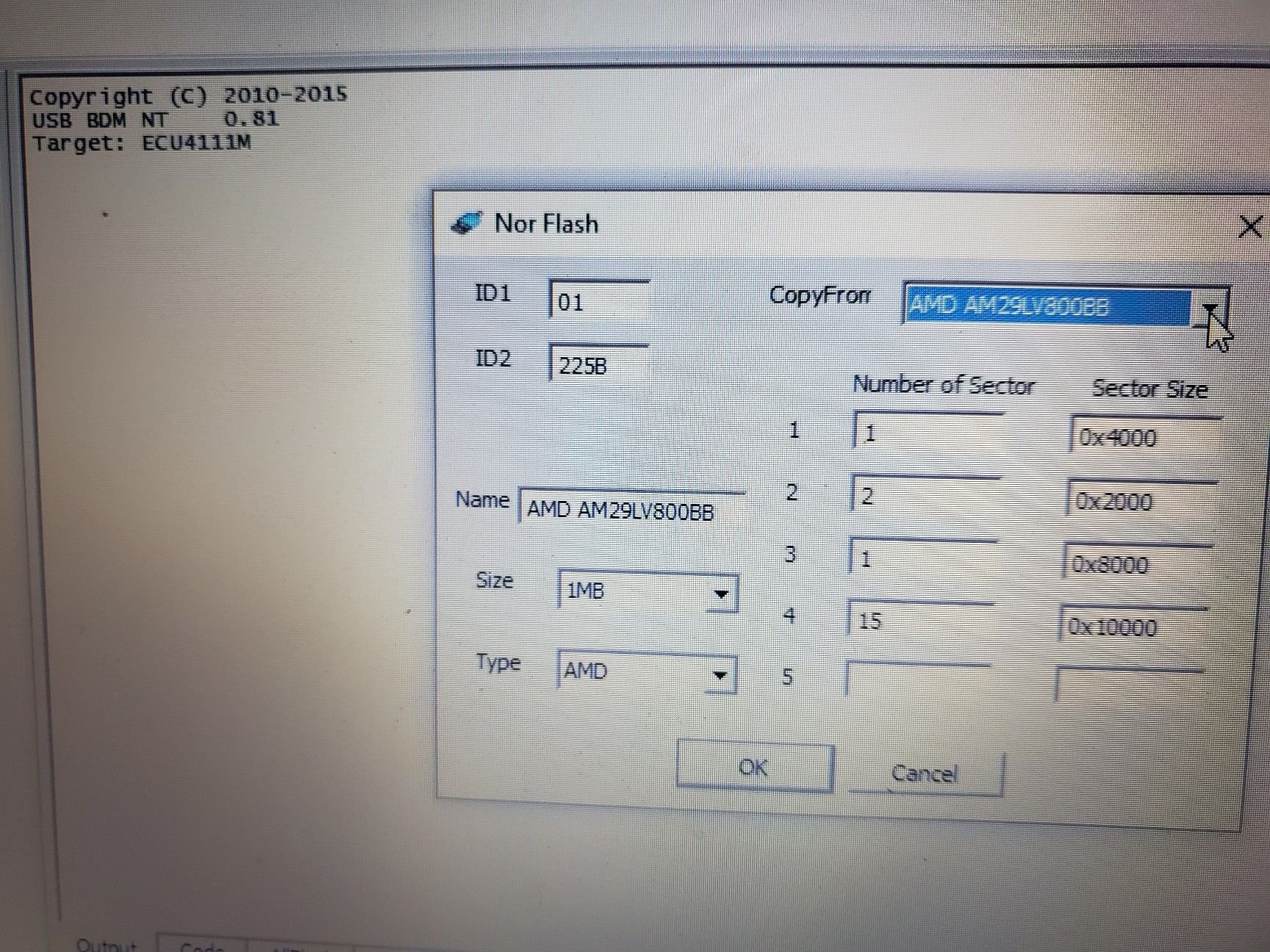

First batch was intel 28f800. 12v to RP. No pull up. 100% sucess
Only had a problem with one, it was same 1mb p59 type, but discovered am29f800 (AMD flash)
Made new flash type. Do not have data sheet. Ultimately I had Success with NO BOOT BLOCK LOCK. I did not use 12v or 12v pull up anywhere to unlock. 100% write and read success
Edit= if I applied 12v to the rp pin on the amd, then it seem successful but the erase wouldn't erase 100% and the write would not write 100% it all seemed to work just fine but would not verify erased and would not verify the write. By trial and error or accident (I don't recall) I successfully erased and wrote and verified with out 12volts to the RP pin. (boot block pin).
From memory this pin rp needs 12v on Intel f800 and the wpp? Needs 12v on the intel f400 512 pcms (411) maybe boot block isn't what it's called.... Write protect maybe?

Can you share the configuration file that worked for USB-BDM flashing with the AMD chip? That's what I need to bring my test P59s back to life, and with a little more trial-and-error I should be able to release a version of PCM Hammer that supports P59s.
Pretty sure I just used ECU4111M for the amd. Had to make the chip identify as another preloaded amd 800 chip by setting the ID1 and ID2 to match my amd chip id
