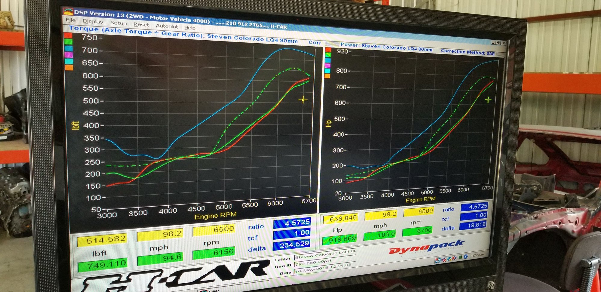

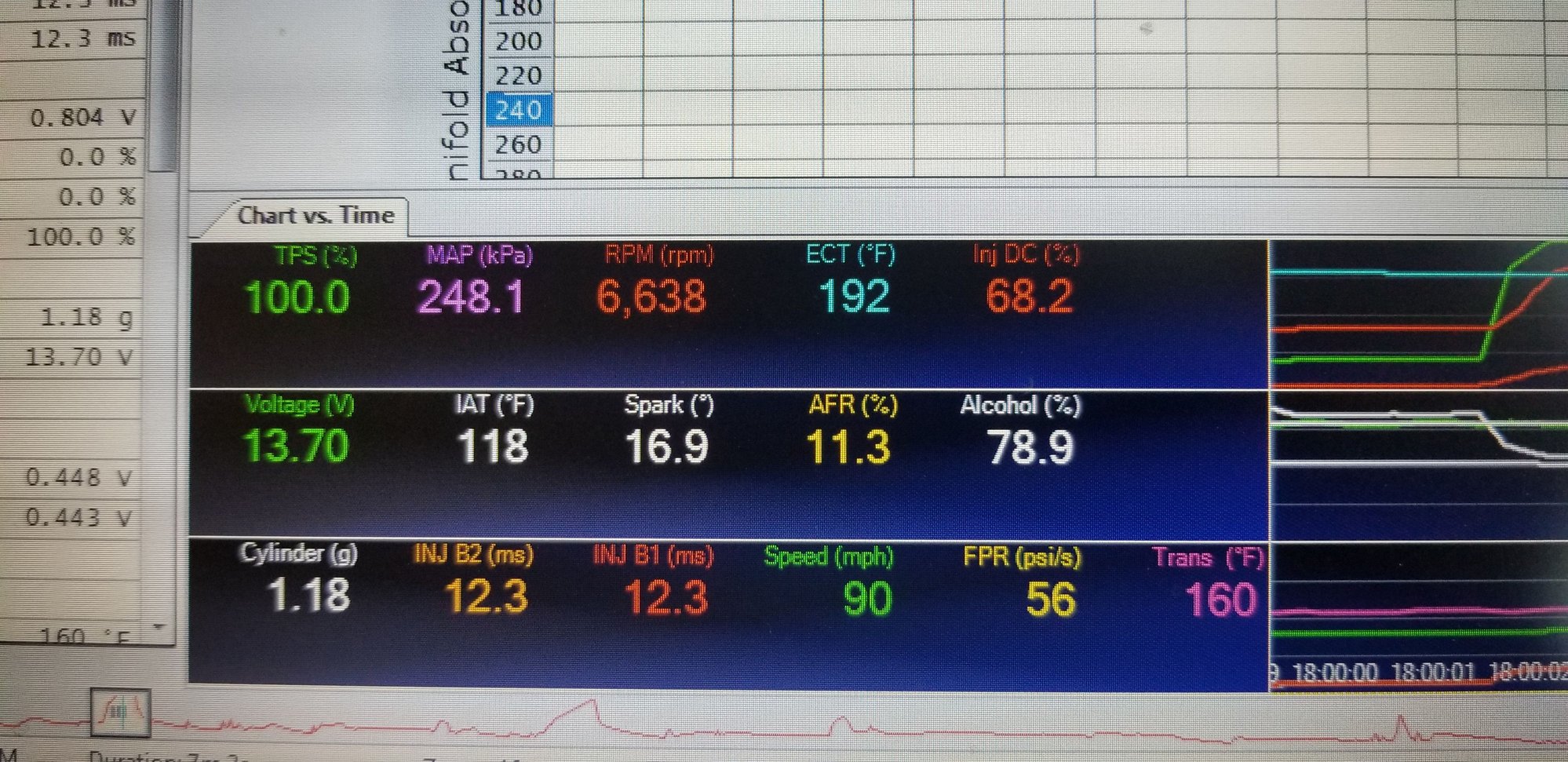

Need help fine tuning my setup, am I rich? Lean? Pushing it? How's the timing? Actual boost number are about 1.5 psi below the screen shot. IAT rises to about 160 if I stay in it, then pulls 2 degrees
stock lq4 gapped ljms stage 2 80mm on e85

AFR is 11.3 which is plenty safe especially running E85. You could be running a little leaner and maybe pick up some more power as well as adding a few degrees timing---as long as you do not have knock. I don't understand the 248kpa and your Airmass is only 1.18.

Probably a scaled tune. I scaled mine to get more use out of the timing table.

It started as a base tune from denmah, I'm pretty sure its scaled. I've never gotten a knock so I'm concerned a little that they don't work or are disabled somehow, or just lucky? it shows they are enabled in the tune.
thanks for the input, going in for some dyno time next week, will pull plugs and see what it looks like. I get a lot of mixed input on timing and air/fuel with e85 and boost. Trying to find a good standard or base

Feels great after some tuning, I added timing to Total 18.5 at 20 psi

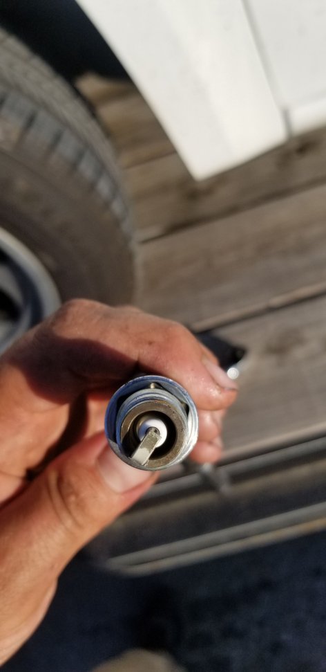

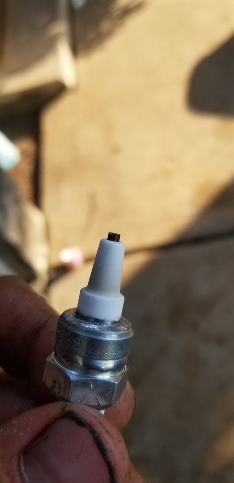

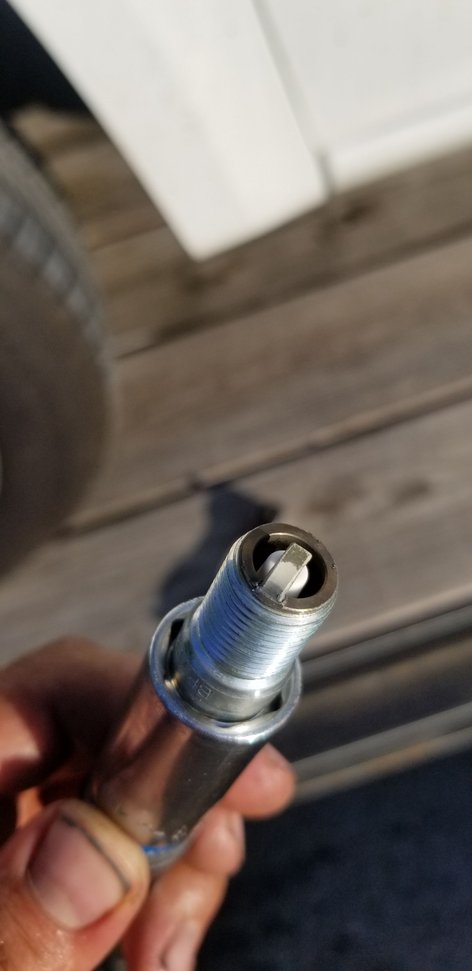

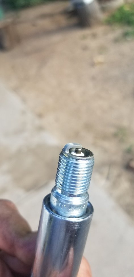

What do you think about the plugs? It was reading 12.4 air fuel on the dyno wideband but 11.8 when I got on the street. My wideband was in much better condition though, so I'm more inclined to think that mine is correct

how many threads have heat in them?

It seems to just touch the top thread

What kind of plugs?

Ngk br7ef

Originally Posted by Steven Little
Ngk br7ef
good choice, surprised you didnt have more heat in the threads though. They look ok to me.
