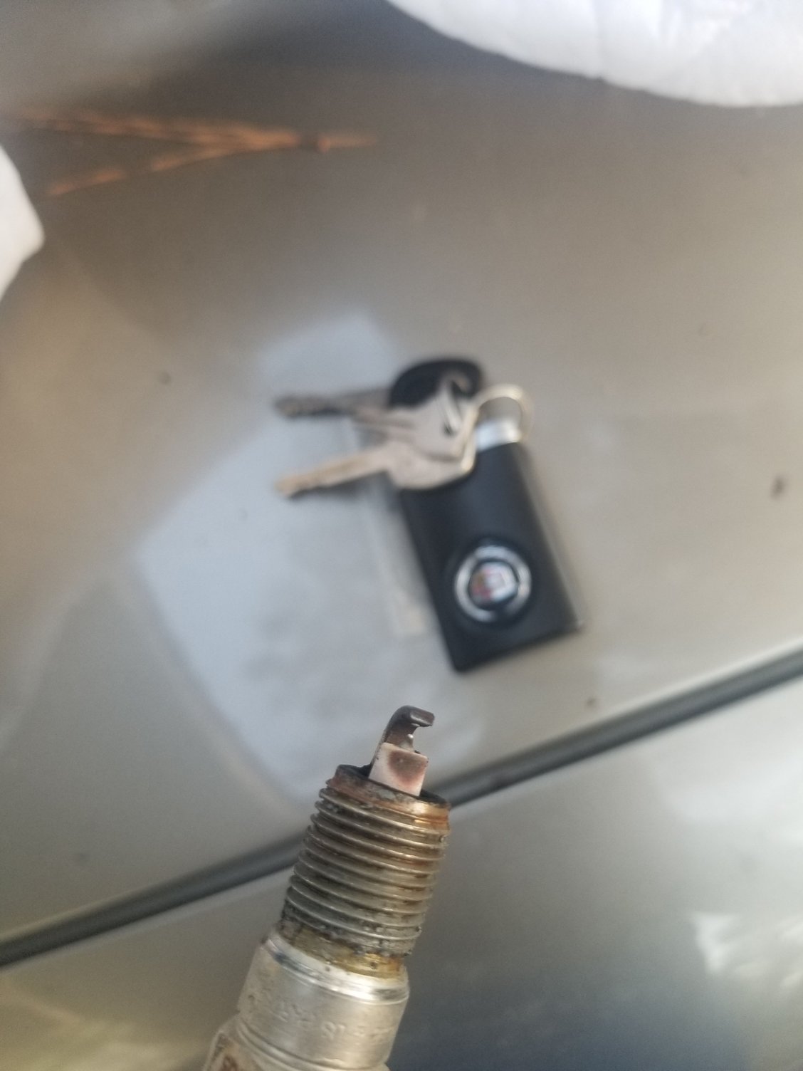

This was the old spark plug I pulled out
