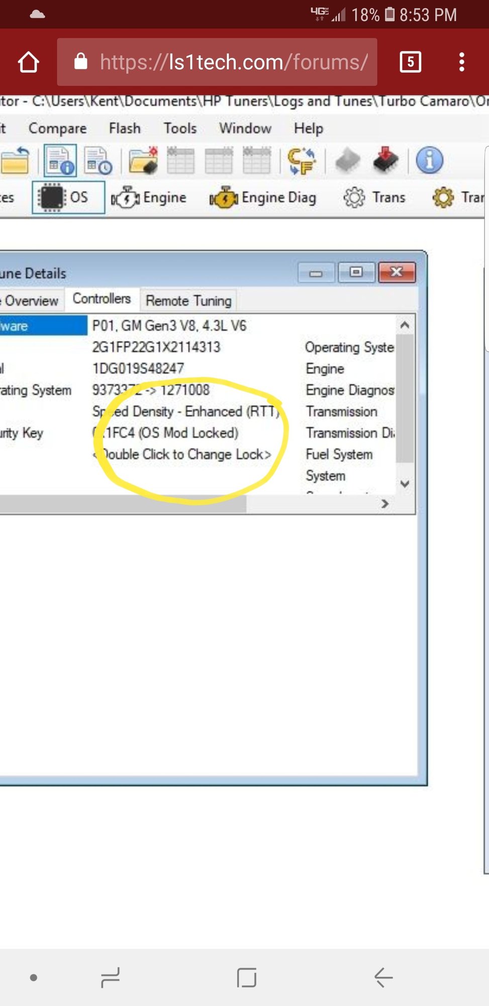

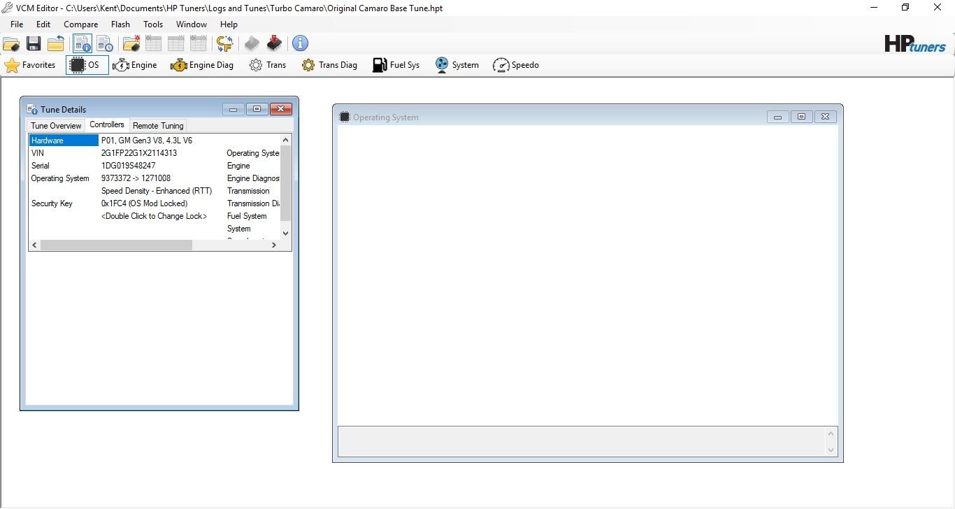

I'm finally at the point to start on a basemap, so I put in the battery, power up the ECM, and read the tune. The computer calibration has been modified to a Speed Density OS and fortunately it hasn't been tuner locked (as far as I can tell). The problem is that when I open the OS window, it's blank.
From searching the HP Tuner forum and this forum, it looks like my best option is to reflash the ECU with a Tech 2and I should have the option to use a 3 bar Speed Density OS. Is this correct?

It says in your pic it is locked???
if so instead of trying the tech 2 why not bypass it with PeteS160's way. He has a video. Ill find it for you. 1 sec.

As I understand it, the "OS Mod Lock" is different than a "Tuner Lock". If it were "Tuner Locked", I wouldn't be able to read the file or even make changes, but I am able to do both. When you upgrade the OS, the other OS options become unavailable and the ECM is "OS Mod Locked". In order to get a 3 bar OS, I have to start with an un-enhanced tune file and stock OS.
I have heard some say that a Tech 2 reflash will work, and others say that it won't. If that doesn't work, I'm considering loading the tune from the spare ECM and seeing if that will work.

The Operating system window is blank because it has been updated to a custom OS.
You cant use that tune as-is to convert to a 2 Bar or 3 bar. It looks to have been modded to a 1 bar SD RTT tune.
OS Mod lock means it has been converted to a custom OS and you can't mod to a different custom OS
Not the same thing as a tunerlock.
You will have to start with a fresh non-custom OS
A Tech 2 reflash to stock will work.. Use your right VIN number when you do so (so the Tech 2 loads the right setup for the car), then you should be able to read it back with HPT and convert to a 3 Bar without killing any more credits as long as it has been licensed to your cable already.

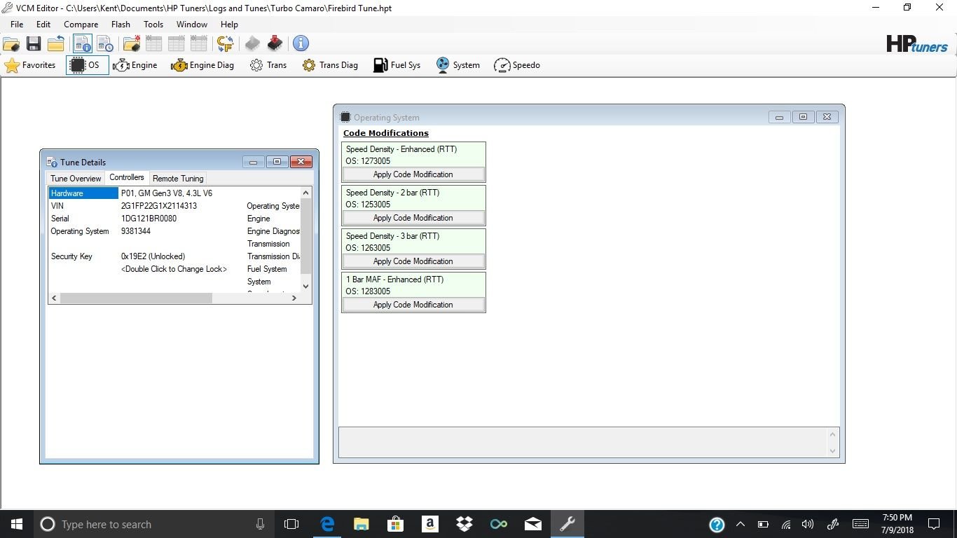

I ended up using the tune file from my 2000 Firebird, chose "write entire", and successfully wrote it to the Camaro PCM. I even read it back to make sure. That was 2 credits.
The Camaro ECM stored the Firebird VIN, so I used Edit>Change VIN Wizard and got the VIN changed back. That was another 2 credits though.
At least the OS change was free. Thanks again for that piece of advice.
