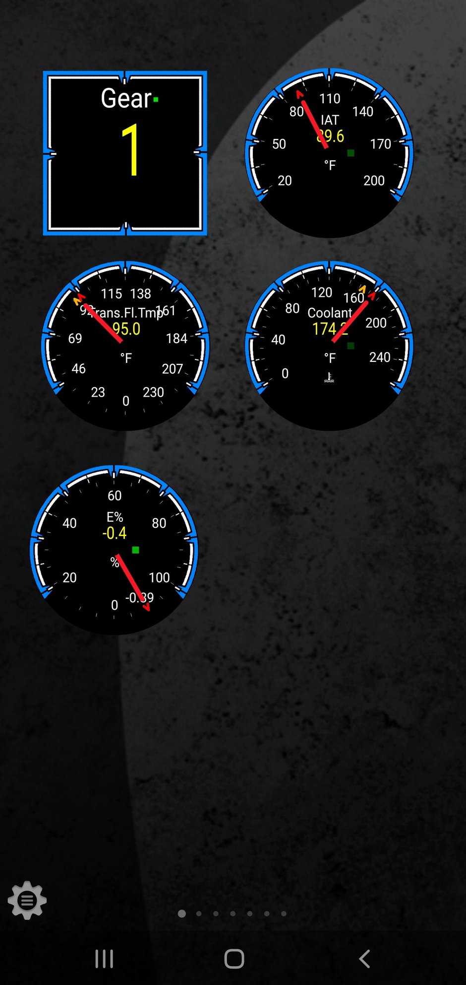

I have a tablet with torque pro app for some additional gauges. Does anybody know the equation to get alcohol percentage to work? The option for it is there in the gm predefined set, but it doesn't work.
Hard sensor and ethanol content does work with vcm scanner. Thanks!

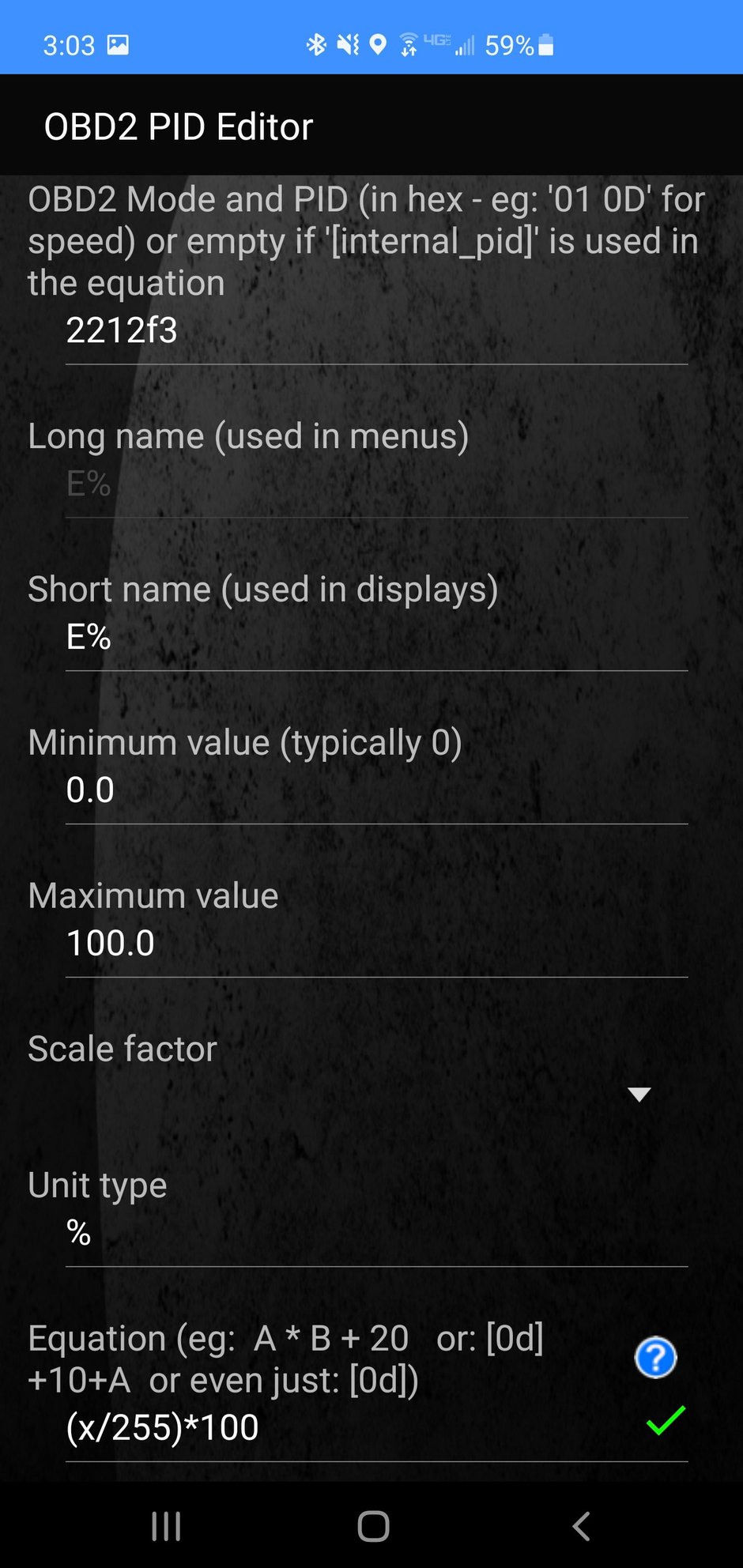

Try this:
Mode 22 data pid
DATA: 22 12 F3
Equation: (X/255)*100

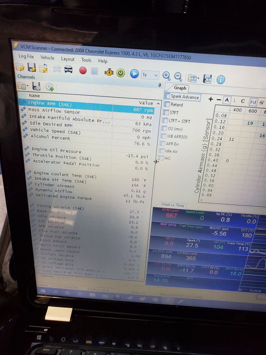

Finally got around to trying this today and it did not work. Was reading -.4 and the HP tuners scanner is reading mid 70% alcohol content.

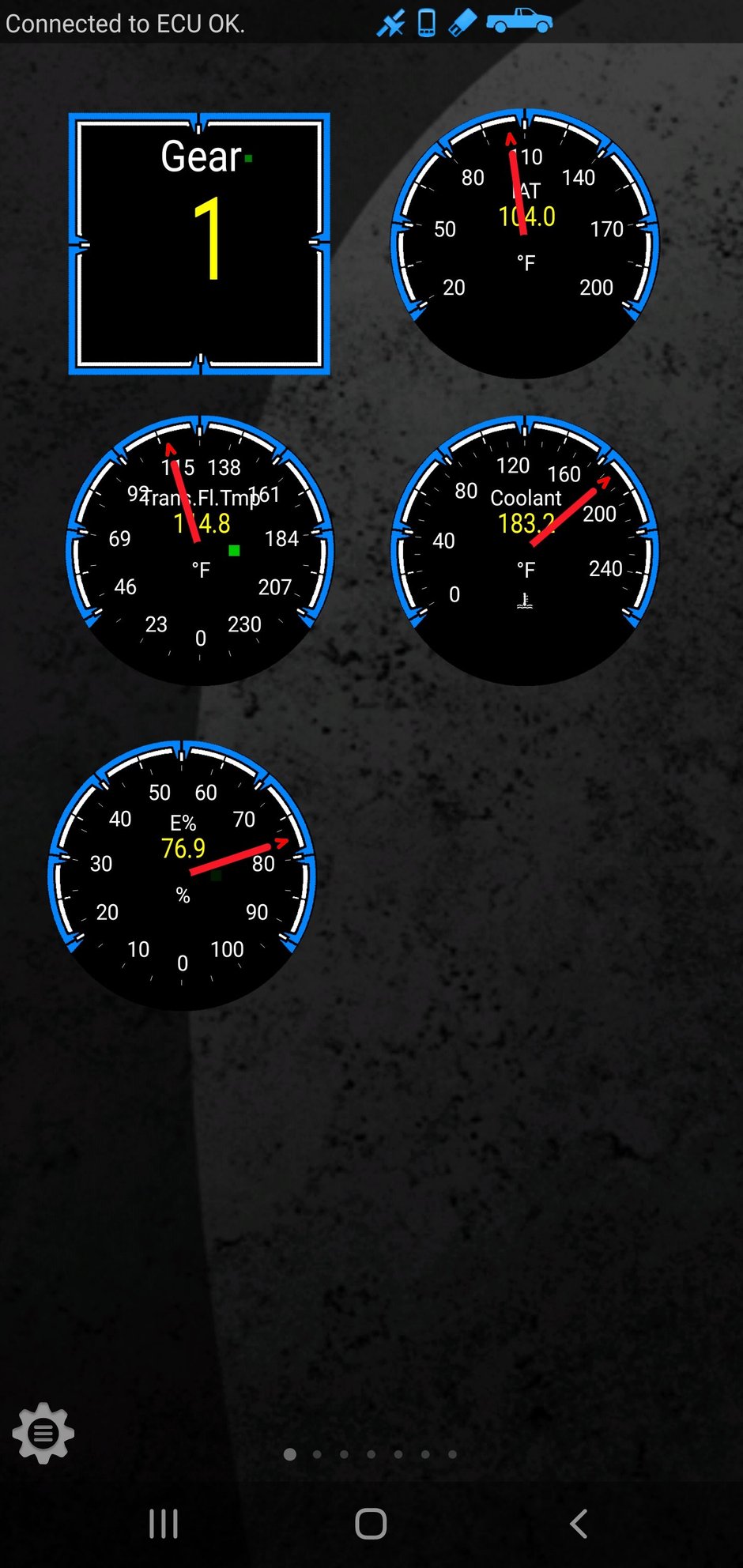

I think I figured out out. I will have to monitor it at different ethanol contents to make sure it matches the HP tuners scanner but it's at least in the same ballpark now

Above PID info is correct and in Torque speak the equation is A / 2.55

DATA: 22 12 F3
Equation: (A/255)
(X/255)*100 did not work for me for some reason.

You can't use x as a variable in torque.
A is the first byte of the response and B is the second byte of the response. When you see equations with A*256 and B or whatever it's actually a 2 byte response.
