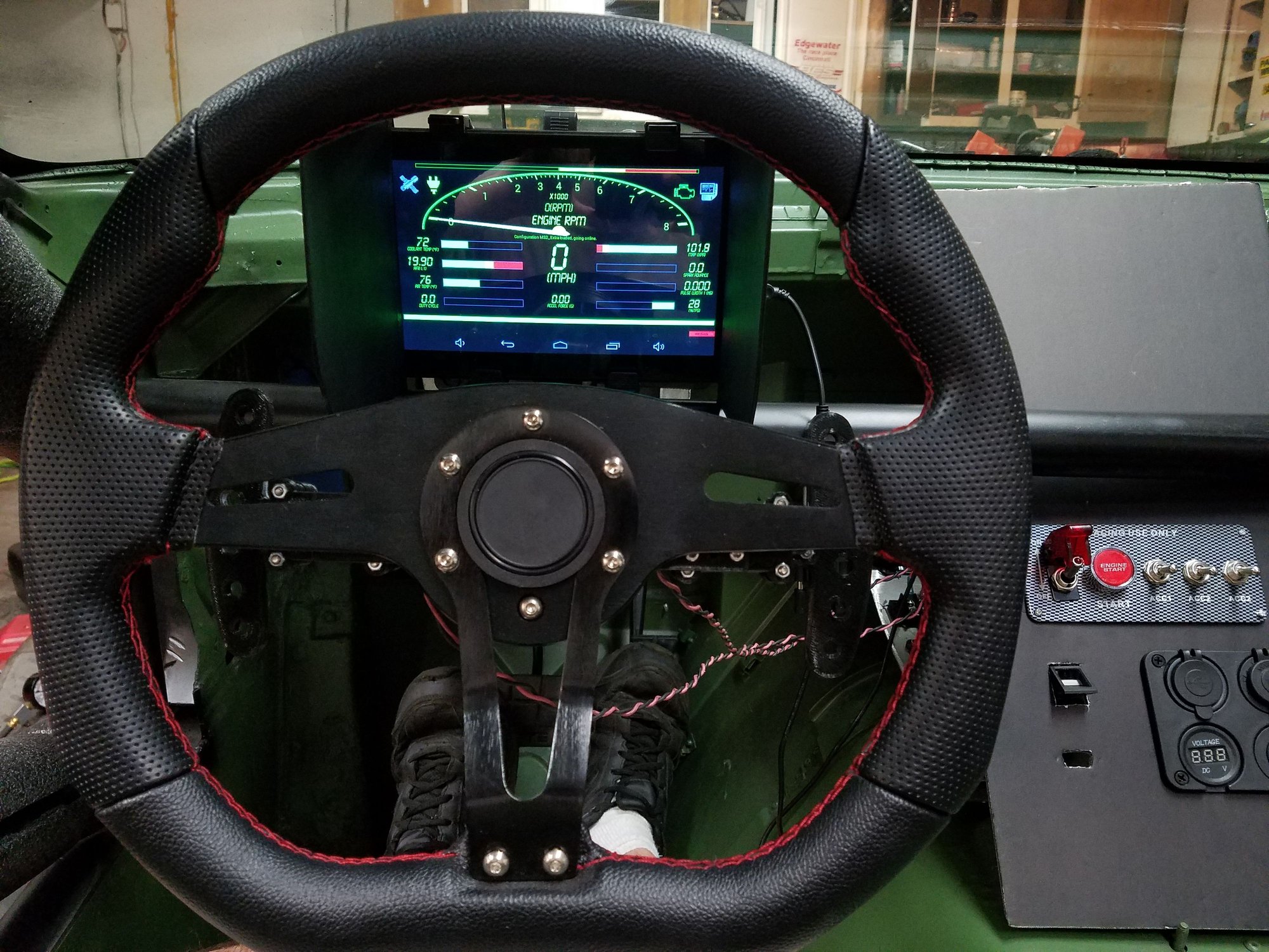

thats a good alternative gametech and for people using factory gauge sets that may be the way to go. but for a lot of us we are doing something similar to joes setup above and using this as the primary mount, also a double din radio may not fit or function in our vehicles. also cost is an issue as well. a decent android radio that actual responds and functions quickly and is reliable is usually $300+ where as I'm looking at an 75-100 tablet, $35 dongle, and $10 magnet mount directly on my old gauge location. then its directly in front of line of sight where I can monitor it and use it for speedo, rpm, etc my primary gauges not just additional. but none the less its still a good alternative and may be suitable for others in different situations.
so now the question is.....what tablets are people using for gauge function and gauge function alone that you are having good luck with and what apps or mods are you using to have it power on and off with ignition power(or are you just manually doing it every start up/shut down?)

I'd recommend NOT buying a $50 Chinese tablet. Connectivity, screen resolution, and glare are a major major issue.
I'd personally recommend picking up one of the budget Galaxy tablets for $100-130 with putting an anti-glare screen on it.

I started using a visor designed to go over a tablet mounted to a drone controller. Very cheap. Even with it, the glare is unbearable at times.
Get a decent tablet with good backlighting and anti glare screen protectors. The cheap tablets are OK, but they're not great.

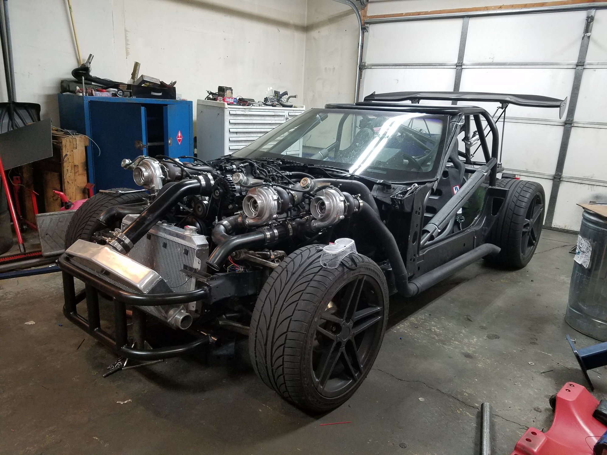

Joe, what car are you in there?
Old Dec 28, 2018 | 02:26 PM
JoeNova's Avatar
Restricted User
Joined: Mar 2014
Posts: 7,192
Likes: 109
From: Ohio
