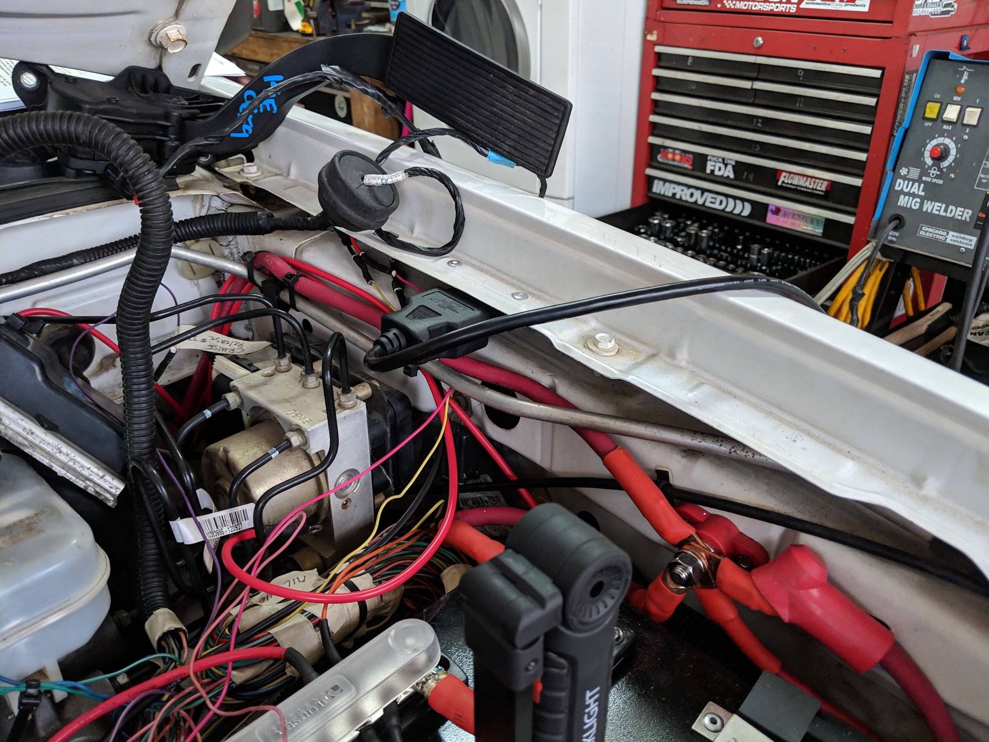

letsturbosomething, your correct on the powering on and off as well as startup for apps. I'm doing this currently via tasker app on a android tablet. we discussed this a page or so back. also maestro is right on the data lines. my P59 ecu has two, most swap wiring stuff says to delete the second wire but no reason as too why. so when building mine for giggles, i wired it in with power and ground to a additional obd2 plug and mounted it under the lip of the fender underhood. i now have two obd2 ports i can read, flash, etc from either. pretty handy actually. have my obd2 Bluetooth dongle on the underhood one out of my way, and hptuners on the underdash one so i can edit and monitor while i set this thing up lol

Pic of said additional obd2 port stashed under fender lip...don't mind the spaghetti, this was during testing stages and getting it all sorted out. It's much less crappy appearing meow lol
