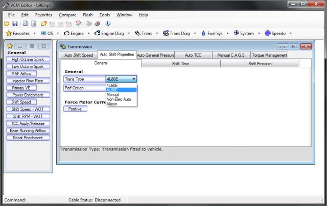

Did a fair amount of searching but wasn't able to find an exact answer. I have a 2002 Silverado that came originally with a 4.8L and a 4L60E, 2WD. The 4L80E has been mechanically swapped in and I'm aware of the wiring change I need to make at the round trans connector as well as the PCM pins.
What I'm unsure of is whether or not I need to segment swap this PCM. This truck could have been originally optioned with an 80E if you got the 6.0L (1500HD) and thus there is a option in the drop down trans menu for 80E. I am assuming I still need to do a segment swap regardless?

You will need to segment swap it for the 80 unless you re-wire and use relay to run the 80 on the 60 tune which isnt as common.

It's free to swap the segment... You just need the segment. You could also try downloading one for a Silverado or something too, if that one is not compatible. It should be compatible though. It's pretty easy, and yes, under the compare feature in the tune. Just open YOUR file you wish to change first, then open the one I gave you, or a stock Silverado one or something similar with the 80E segment, select "segment swapper" and then select transmission. Should be it. Make sure you back up everything beforehand, it doesn't always work out from what I hear. That particular one works perfectly fine though. It's been a while since I did it.
Here's a video on it.
