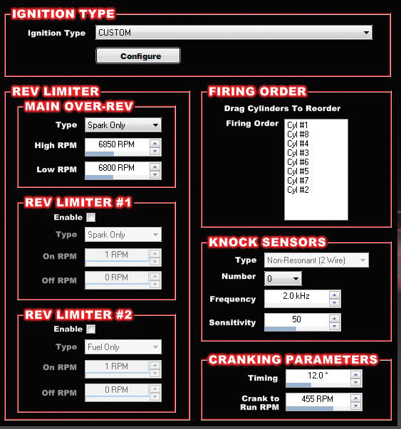

To test/get it started with a weak battery did you try lowering the crank to run RPM? You can put 50 RPM in there if you want and it should fire right up.
Bottom right:
Old Jan 8, 2020 | 03:56 PM
Bottom right:
That just determines when it leaves cranking fuel and timing and transitions to running tables I think so not sure how that will make it start but worth a try I guess.
Cars with the little lightweight batteries turn over a tad slower, I lower this and they fire right up.
awsome, thank you. I didn't see these responses, I will change it now. I pulled the plugs and cranked and got spark, but with plugs in none, donuts definitely crank rpm. Thank you
Where do I find this table?

In the terminator software it us under spark.. cranking parameters
Old Jan 10, 2020 | 02:20 PM
Surewhynot's Avatar
Joined: Jan 2016
Posts: 219
Likes: 8
Got it, thank you. I've got to get a cable for my computer then. I finally got a blue light on the LEDs indicating too slow of a crank to get signal. Its cranking around 115rpm
